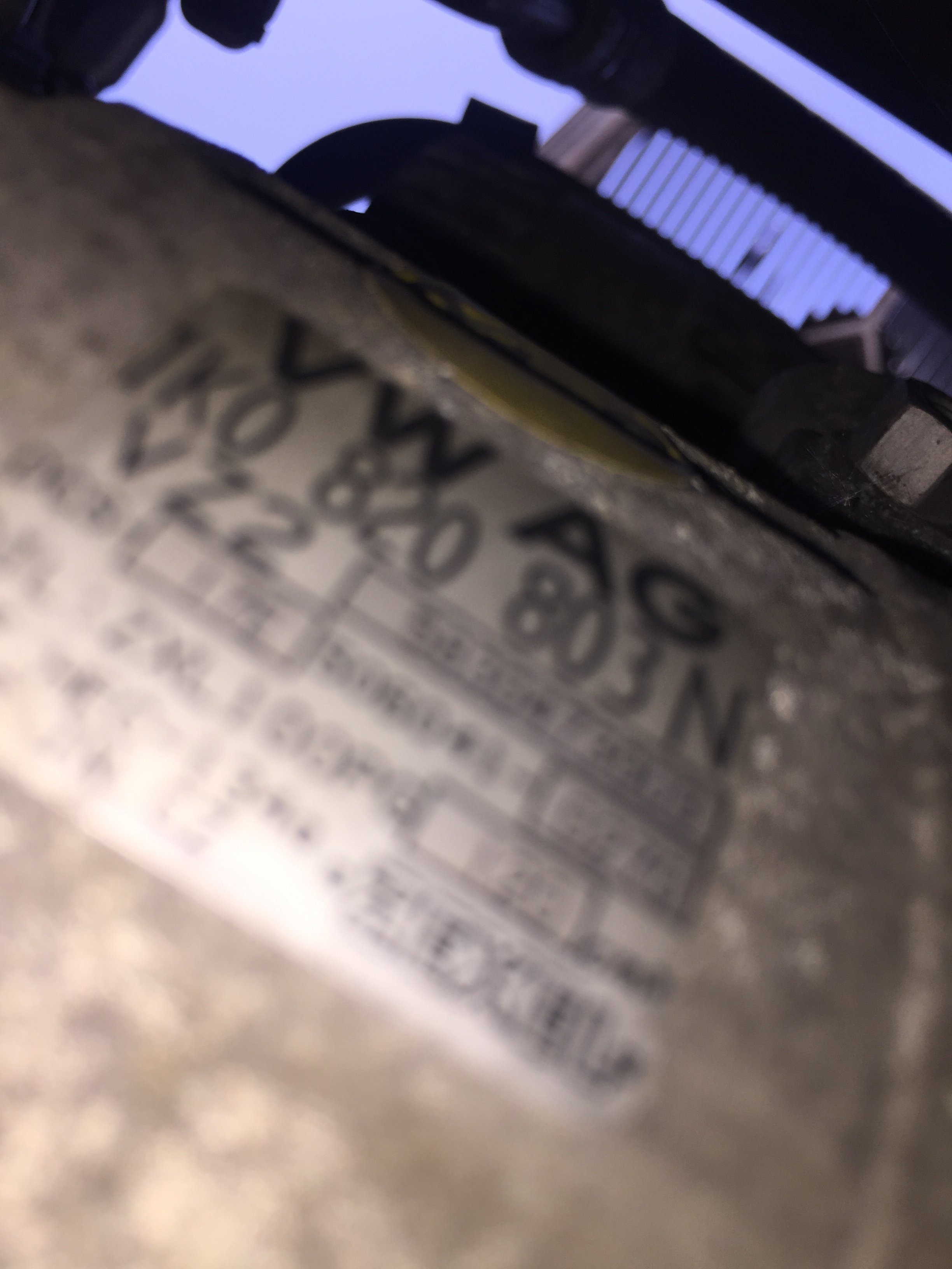

Sorry for the lack of updates on here, here was I thinking I had the Sanden compressor fitted on my car, however it appears it’s the Zexel 1K0820803N VZ2.
I have finally had some time to look into the ongoing AC issue. Got the control valve for the Sanden compressor but had to put everything back together as it’s a different part number.

Trev,
Thanks for the reply....
Now I have come to another issue the old compressor has ZXL100PG oil in it which means the system has wrong oil in it as Sanden's come with PAG46..... I just ordered the other one as well.... bloody hell!

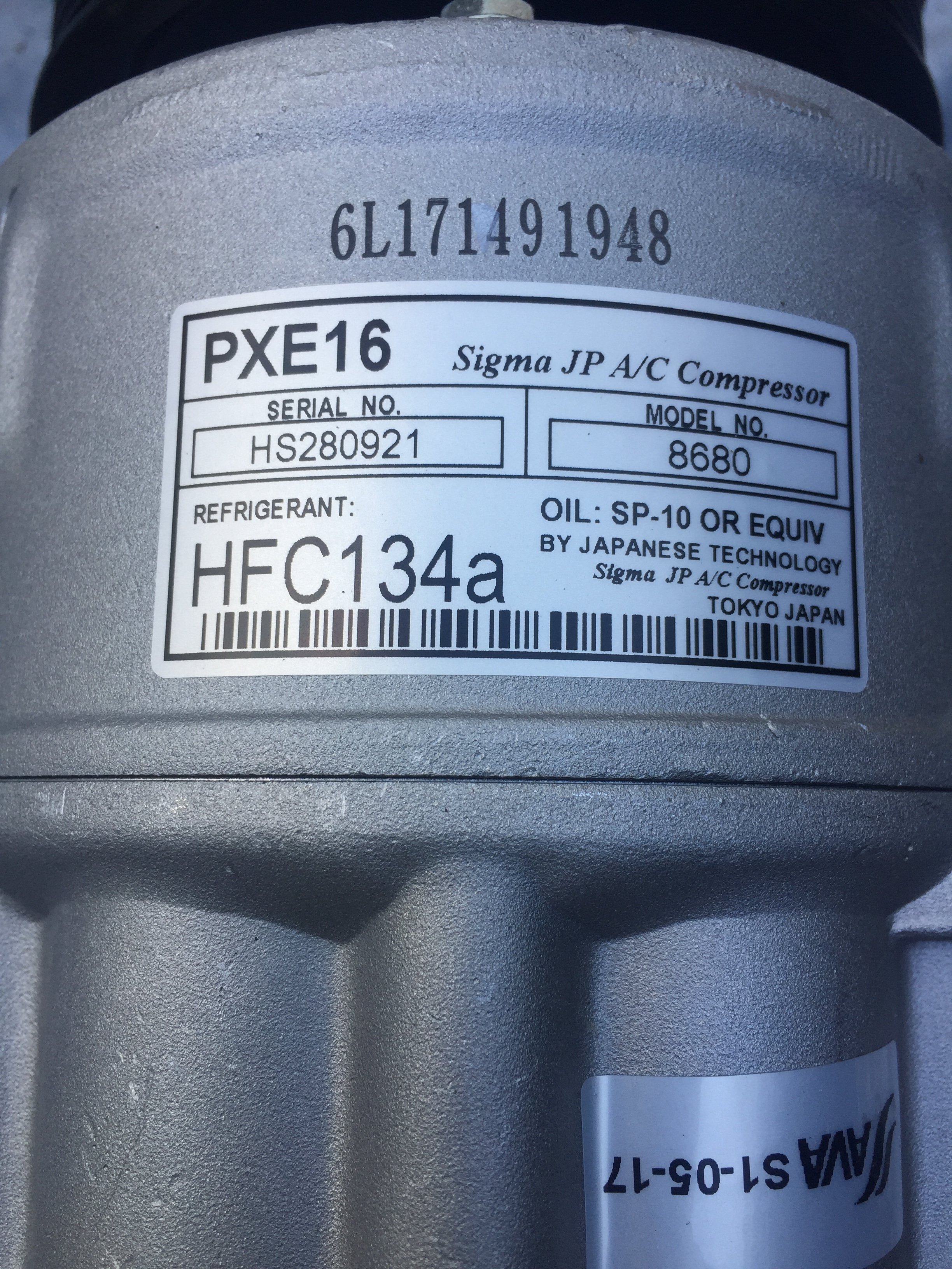

Got the ac compressor it doesn't say how much oil it requires on the sticker nor in the documentation. What is the best way to do this? Do I just empty the old one and add the same amount to the new one? Just to add the new one comes with oil already inside. I don't want to damage the internals of the new compressor I have an AC guy coming over on Monday but the car needs to be used in the meantime...

Hey Trev,
Thanks for clarifying, I have installed the eBay ac compressor this evening, to be honest the sticker said Sigma JP Model 8680 looks like like it was rebranded by a distributor AVA. I suppose you get what you pay for, have also replaced the smaller radiator fan, tested it all working as intended. The guys who sold me the compressor advised they put in 150ml of oil inside. Funny enough my old compressor looked completely dry, there wasn’t a drop of oil coming out at all. Since this was the case I didn’t drain the new compressor I only installed it.
Got the AC guy coming in Monday to refill and do whatever else needs to be done. Oh yeah forgot to mention the compressor came with new o rings so changed those as well.
