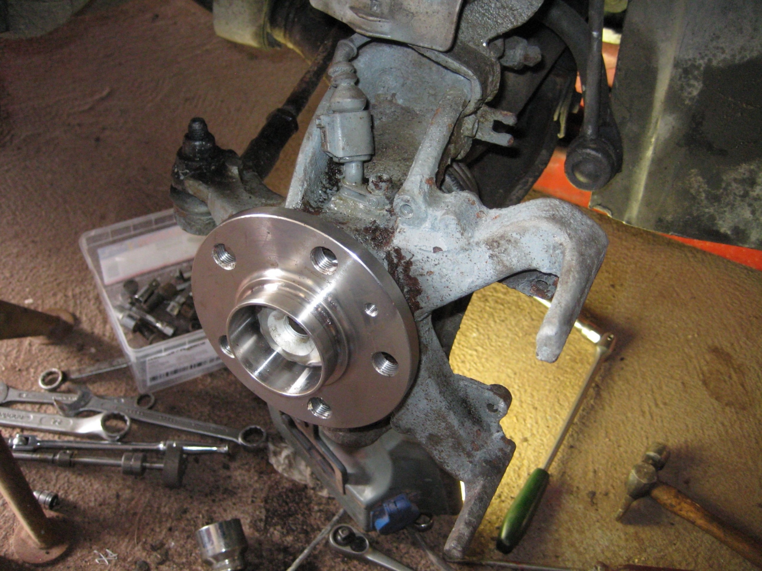

The tool have to modify so it not destry the ABS-sensor. I had to take more iron off with a grinder, on the tool so the inner part dond crash with the sensor.
Else you have to change the sensor, go take it our first. The problem i that the sensors can brake when you try that.
I hav changed tree i to cars, and now Im waiting for rear bearing. Thats easy, only a nut in rear.

It is possible to do without Gen 2 tool! Remove hub, drift old bearing out and ABS sensor has to be removed!!
Place new bearing in freezer overnight, heat hub up in oven on high for two hours, lightly oil new bearing and push into hub by hand (drift with wood block if required). The locking clip has to be pushed into place with a screw driver, as not pushed in with tool.
I replaced one on mine this way last year, no problem, except did break ABS sensor and had to replace with new one.
