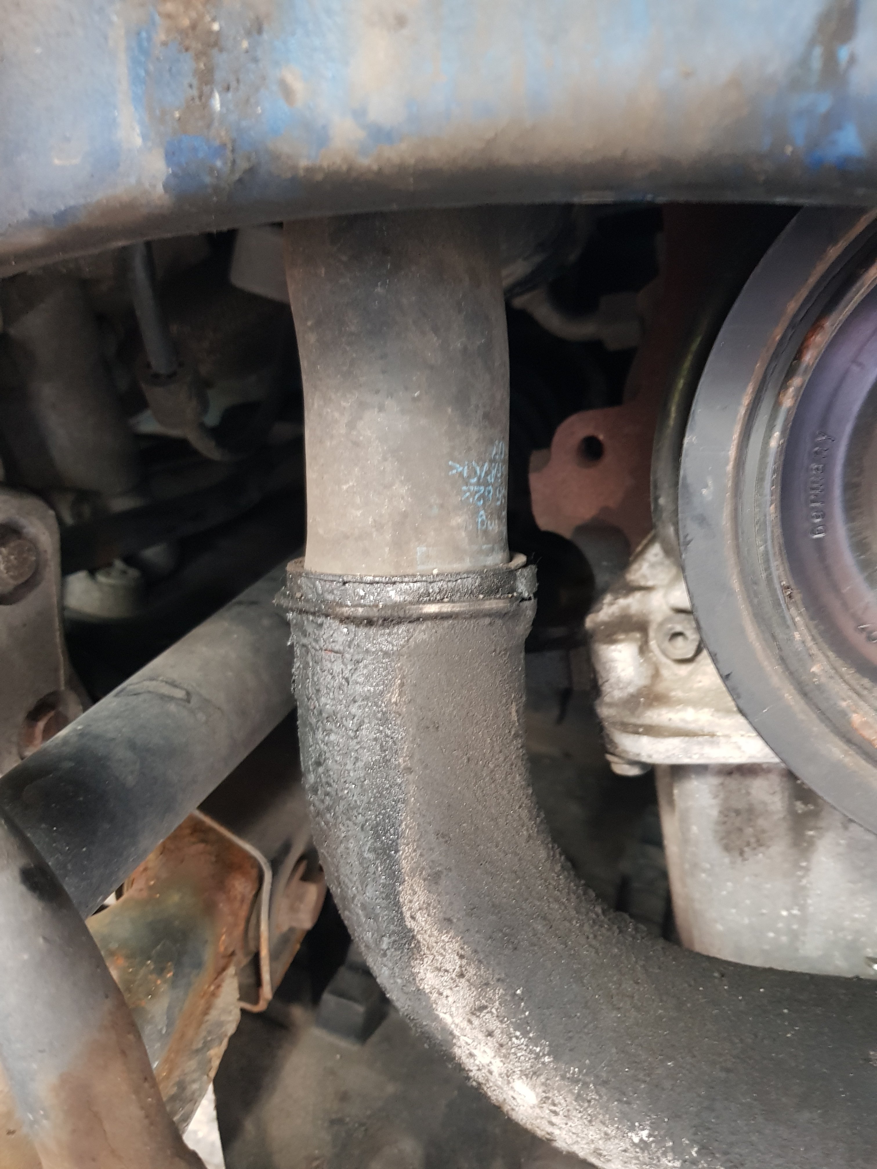

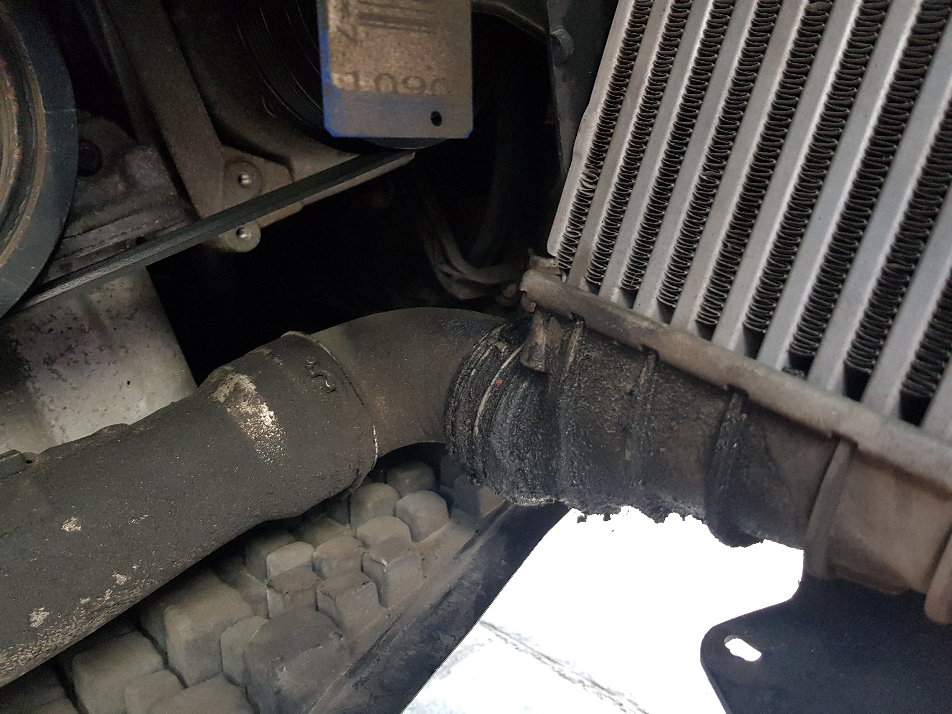

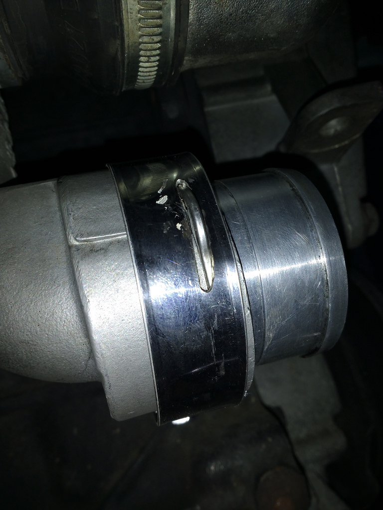

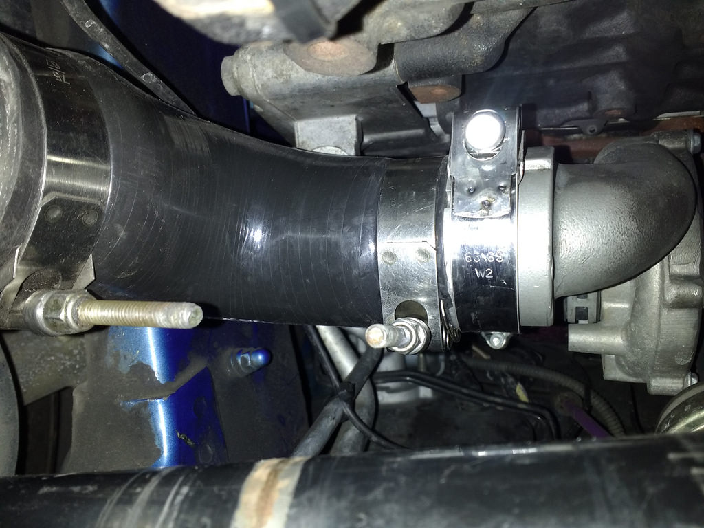

I wanted to investigate the potential of boost leaks. So i took the arch liner out and was greeted with the attached pictures. I gave it a quick clean up and then inspected the boost pipes for movement. The biggest offender is the top intercooler hose, it had a small click as i pushed it in a bit more, the other pipes have some movement 3-5mm maybe and i guess if oil/fluid can get out then so can air. Driving the car afterwards I'm not sure if it was the placebo affect or if the car generally felt better, it seemed to sit at higher MPG on the instant trip and the idle was a little better.
What do people do to resolve the loose pipes? Is it a case of replacing just the o-rings and the metal clamps or is it new pipes? What aftermarket solutions are there? I don't want to fit a big front mount, want to keep the standard cooler etc.
Finally had a very quick look at the EGR leak, i can see that its leaking from the bottom. Is there a gasket in between the EGR and intake manifold? I was worried about taking it off without the right parts to replace. Looking at a parts diagram it looks like it just has an o-ring on the inside, can anyone confirm? I take it the leak is because the o-ring is missing or failed.

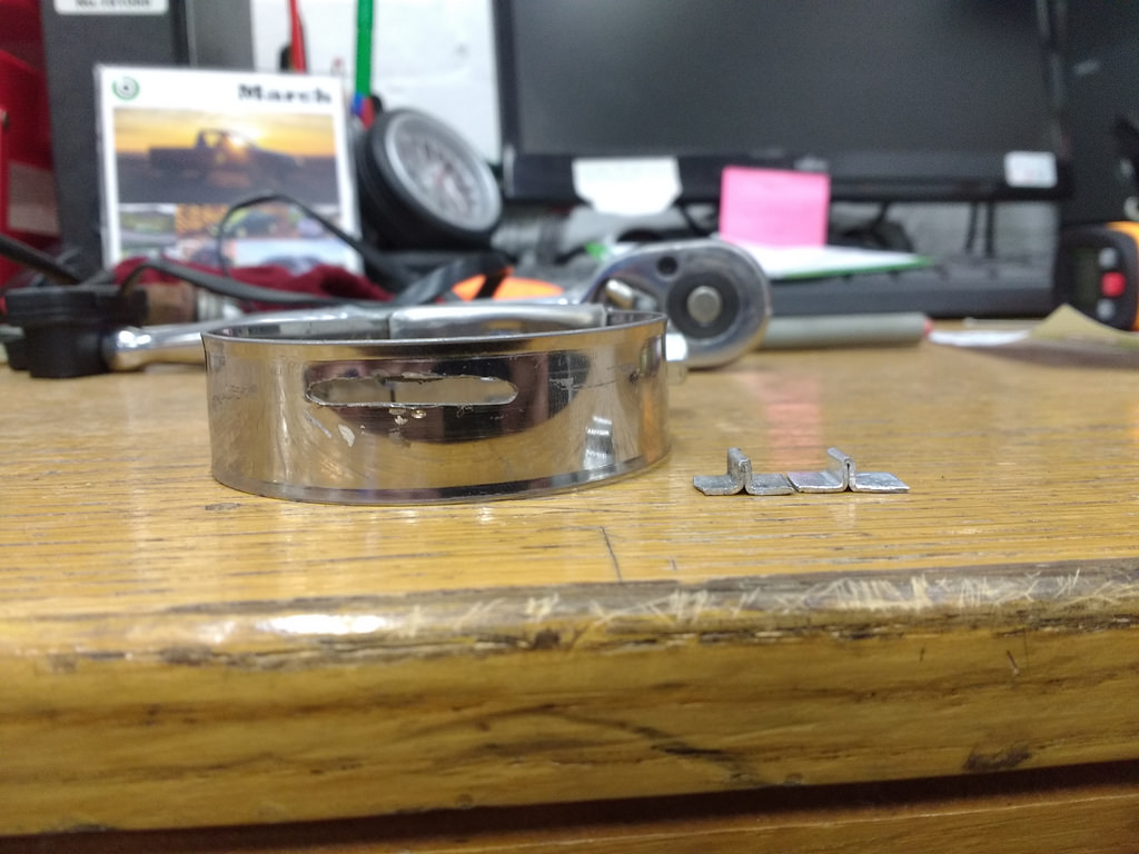

When I had a problem with the turbo hose coupler shorting out the turbo I used a mikalor clamp with a groove cut in it to allow the raised part of the spring to go though.
Still on the car and ran it on multiple track days with out another issue.

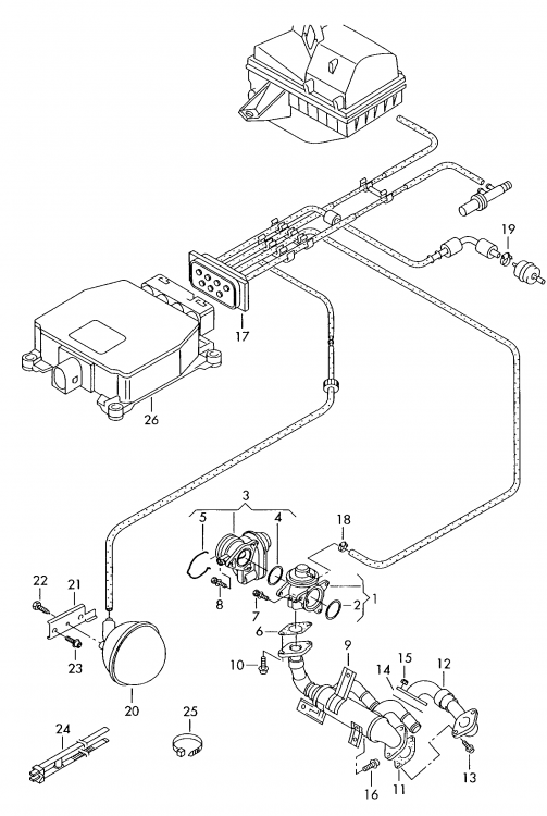

Can someone please tell me if there is a gasket between the EGR and the intake manifold? The guy i spoke to at TPS said yes, but didn't seem confident, i guess i will find out once i get down there otherwise im not sure why it would leak if it isn't supposed to have one.
12 minutes ago, Wino said:
I have just spoken to TPS again and got him to send me the diagrams for the intake and the EGR as you just did and doesn't look like a gasket between the intake and EGR so i have ordered 2 and 4 in the image you posted.

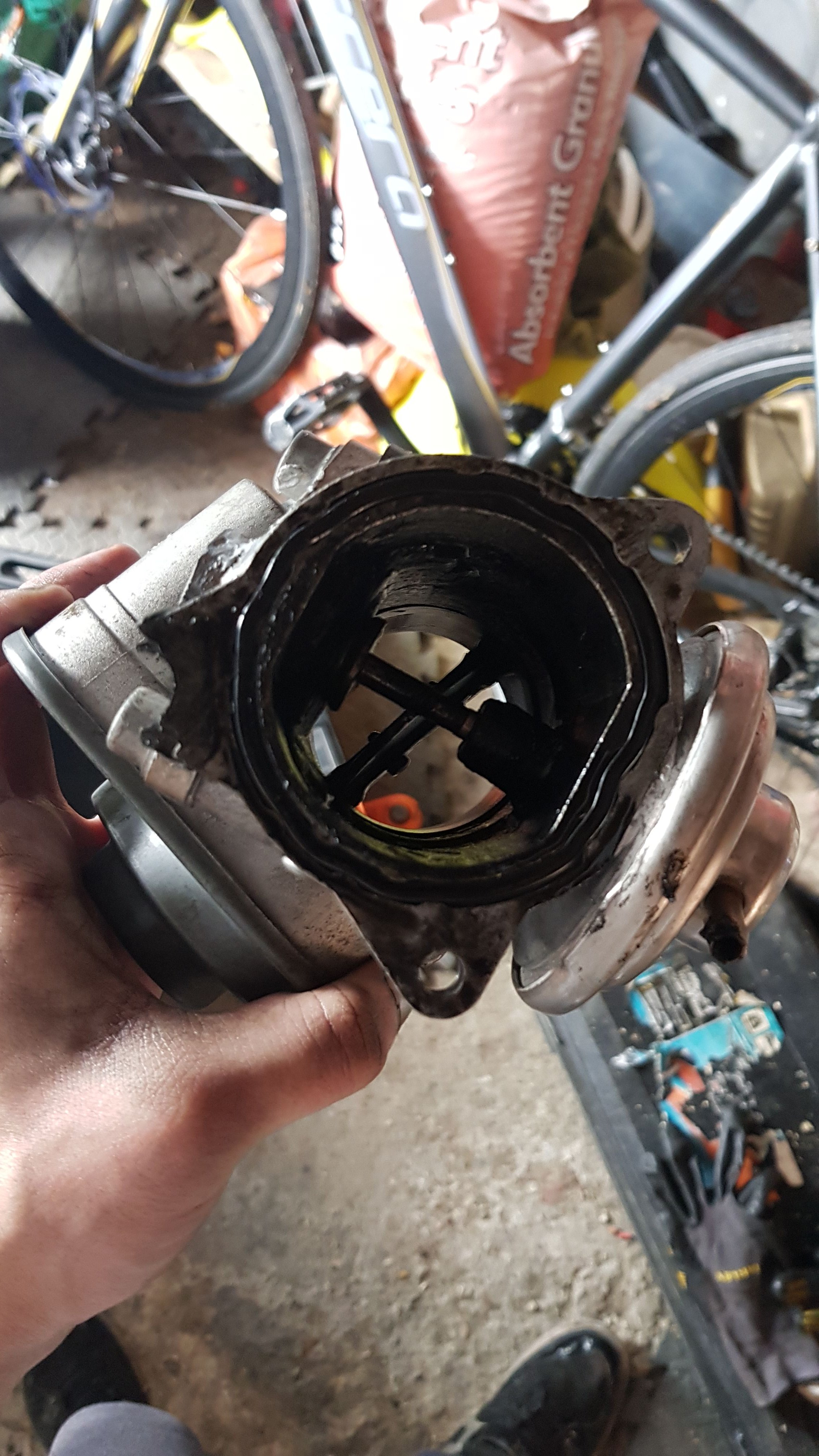

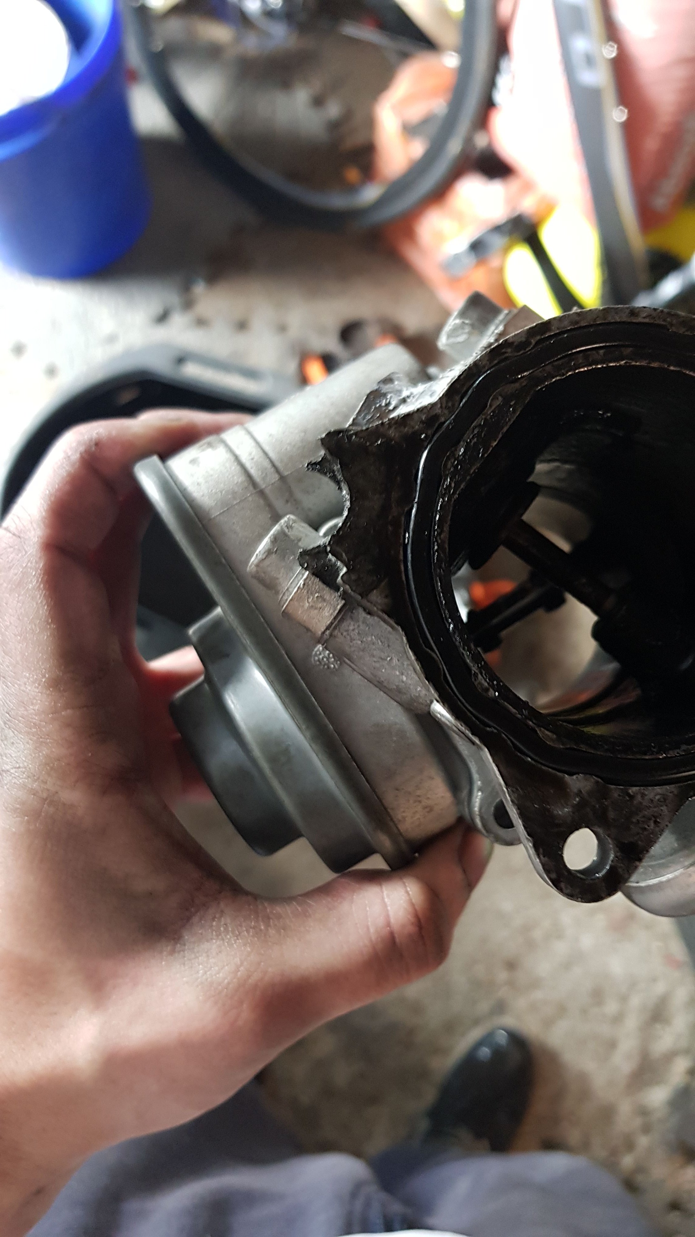

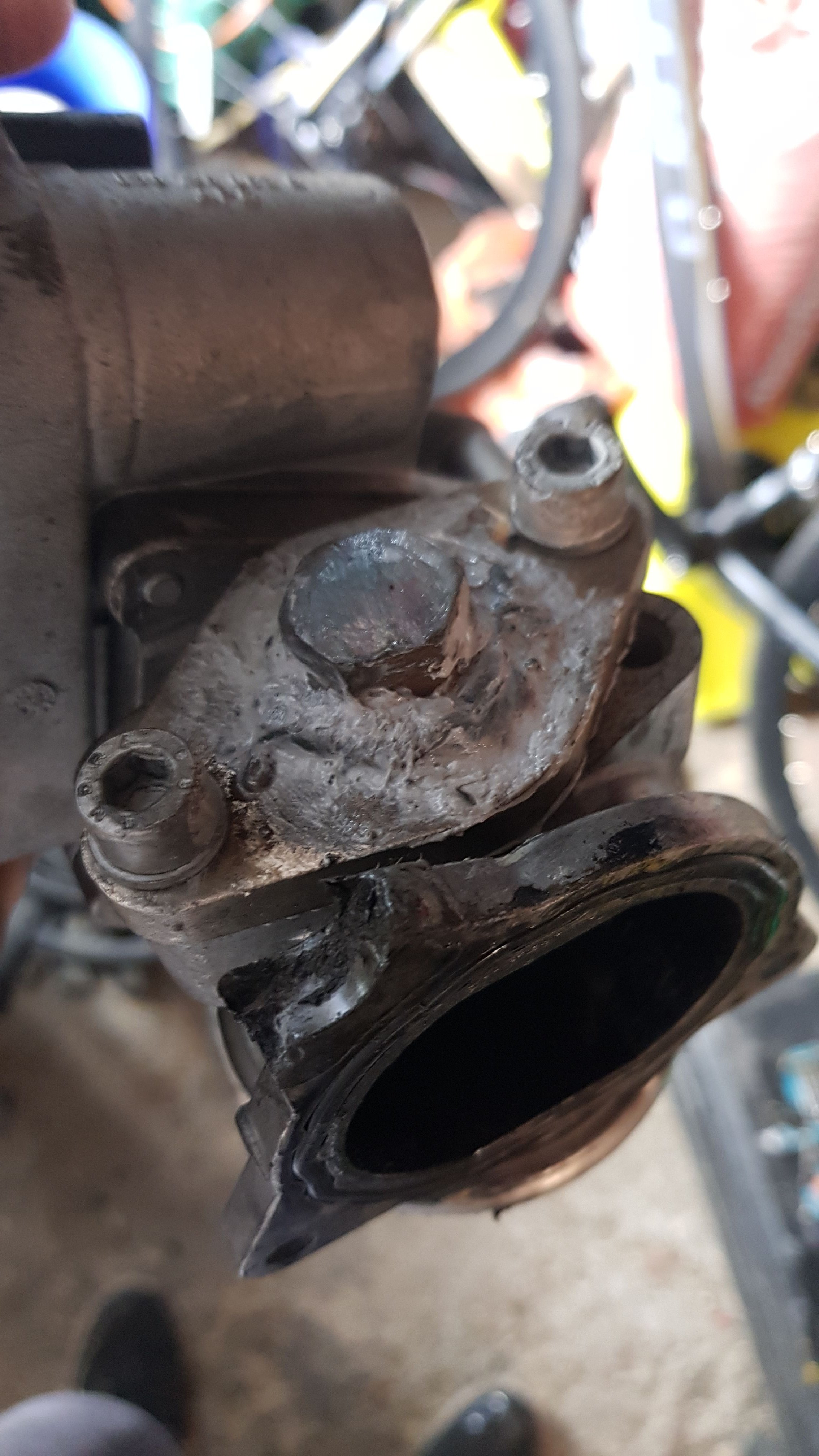

Here is where we get to the fun part. I needed to fix the EGR leak and this only happened after Unit18 had modified it, i wasn't prepared for what i saw when i took it off. As you can see it's very much broken and bodged! Needless to say i was extremely irate, unfortunately Unit18 are not open on a weekend so i was unable to express my displeasure with them, that will have to wait until Monday. I will be ordering a proper Darkside delete to replace this monstrosity as it not sealing properly is probably contributing to some of the issues i was having! Safe to say i won't be taking my car to them again and would worn anyone off them.
