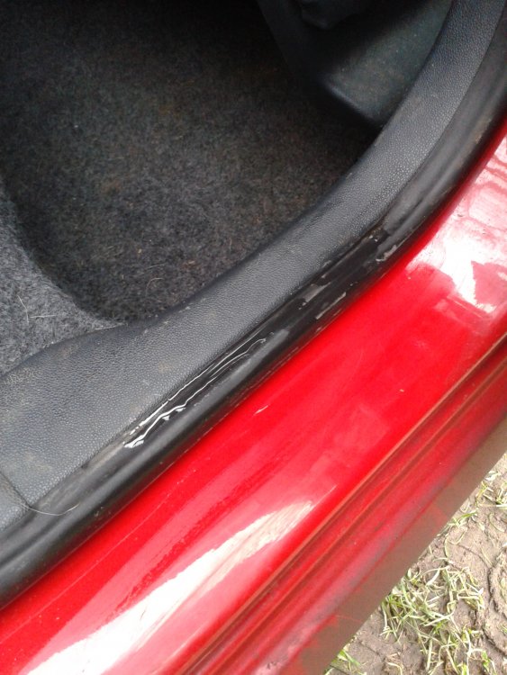

Check that no water is getting into the cabin, by looking at the rubber seals at the bottom of the doorways when you open the doors after rainfall. Little puddles on the seal is a good indication that the ancillaries carrier is leaking.
If any doors are leaking, fix that to reduce internal moisture levels.
