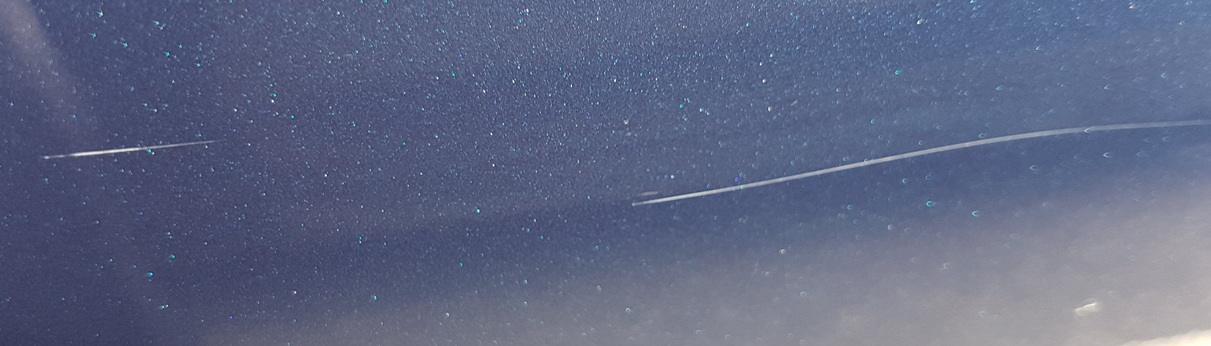

Thanks guys.  So some answers to your questions (just been out to check - bad piccy attached)
- I can't really feel it at all and no way will nail catch on it...So assuming polish will be enough
- Nope don't have machine polisher. I have polished and scratch removed a couple of times by hand before on old car, but the car was 4 or 5 years old by that time so was not so 'bothered', and generally not confident about doing it.
Quite nervous and really not confident on a car so new! :)

Obviously it's hard to judge the depth by a pic.  How you can do that and not realise?!; is it a shared/public car park or exclusive to you and your colleagues?  Twunts.
The megs compound I posted is safe enough, I've used it a few times when scratches and imperfections didn't warrant the polisher.  Just make sure you clean the car first and don't just work dust and dirt into the paint.
Try a small section of the scratch first and reassess as you go.  At worst you will reduce the scratch and make it less obvious but hopefully it's not too deep that it can't be rescued.
Do try and get a pack of the Sonus SFX pads though, they make hand polishing much easier as they have a bit more 'bite' and are easy to hold and the large surface of them also helps.

As @penguin17 has said - its hard to tell depth in a photo, but on first glance, I've dealt with slightly worse ones by hand (and some simple T-Cut) then some Polish and Wax.  Should come out fine.
Again, as has been said, ensure you wash the vehicle first, and take it slowly (the little scratch to the left would be a great tester).  Once it's gone, polish the whole panel (or the entire car) and then apply some wax for a bit of protection.
The small scratch looks as though you can see the paint lifting off...

Why?  A pro detailer could probably remove that (or close to) for beer money with a few passes of a machine polisher.  @Svend  would be a good person to ask for advice on this; detailer and petrol blue S3 owner.
For the sake of £15-20 the OP will have not lost anything by trying to have a go at buffing it out himself.    It ultimately may need a smart repair or similar but it worth trying to go down the cheapest route and the worse case is that the OP has some kit to use in future when other scratches appear on the car.
I also can't see what you mean about paint lift but one thing I can see is a metallic paint flake just off centre (to the right) of the smaller scratch, those same fllakes are present on the rest of the pic of the door.

The point of paint flake is that its not just a lacquer scratch, the colour has been (If only slightly) Damaged... Rub it down, and you may not see it but I guarantee you will always look for it.
The O.P. obviously wanted advice as he may not know how to deal with rubbing, cutting etc and on a 5 day old car, I wouldn't want to do it myself!  Granted it MAY come out for beer money and a bit of luck but a professional will get professional results and on a car costing around £23,000 A £100 bill IS beer money! Try to repair it yourself and ruin it, will almost certainly mean an even larger bill.

There are no flakes or lift I can see or feel, its just the bad picture and the dust from the dried rain over the last day or two that makes it look slightly wrong in the piccy.

IMO a lot of OTT replies. If it's not a fingernail catcher, it's likely they are just stress induced scratches. They could even be surface deposits rather than scratches, rubbing gently with your fingernail will  test that. Simply wash the area with wash/wax. Then take a clean duster or microfibre cloth and using a tiny quantity of ordinary car polish (NOT cutting compound or other aggressive stuff), polish it out.

Yes maybe given the size :) I will be trying simple stuff first as they might just go... Did try a quick bit of water to clean the area and microfibre cloth to buff it a bit already but that was not enough for them to go, so not just simple surface ones/dirt I don't think, but still hoping not much more than that. Will do full wash/wax then small polish and try that. If not will go to the compounds - carefully!

So spent a few hours before the rain, cleaned the car, waxed etc. The scratches were much better but still visible, so used a small amount of the ultimate compound and using the pads had a go! And yes much improved. Still visible with really bright torch (and will be in bright sun I guess) but much better - probably being too careful. Waxed and sealed after and looks good. I will give it a few weeks and at next full clean have a further - careful - go to improve more.

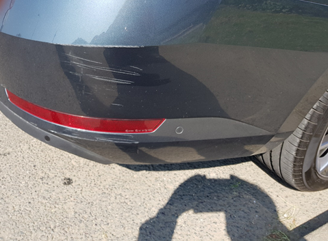

Oddly enough I had to fix one myself today. Spotted by SWMBO (she has seriously fallen in love with this car) so ignoring it wasn't an option. I used the Meguiar scratchx 2.0 as it was only 1 cm and completely superficial, but very noticeable. Great product - removed it completely. Two coats of Megs Ultimate over the top and you would never know it was there in the first place. Brownie points duly earned. B)

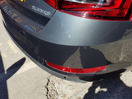

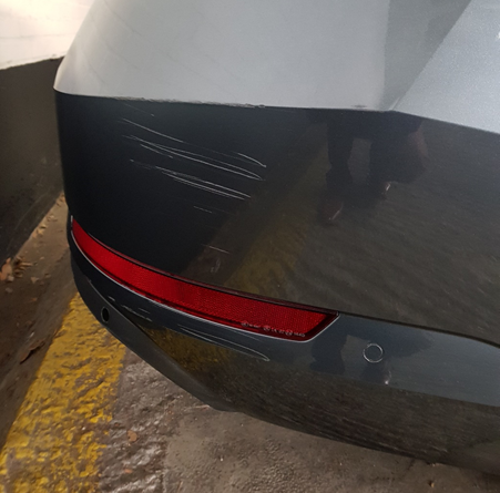

This one most definitely wasn't going to buff out:crying:. It happened when I was viciously attacked by a mobile crowd control barrier - I blame the Royal Wedding!
When I'd finished swearing I gave it a clean to assess the full scale of the damage. It was through the clear-coat and the paint, with a nasty scuff to the leading edge.
So I did what I always do in such circumstances - I swore quite a lot more. Then I got on the phone to my trusted local paint shop. This is the outcome.
I'm a hundred notes lighter, but having the Superb back in full fettle is well worth it. Do you think I could send the bill on to Buck House?:D
