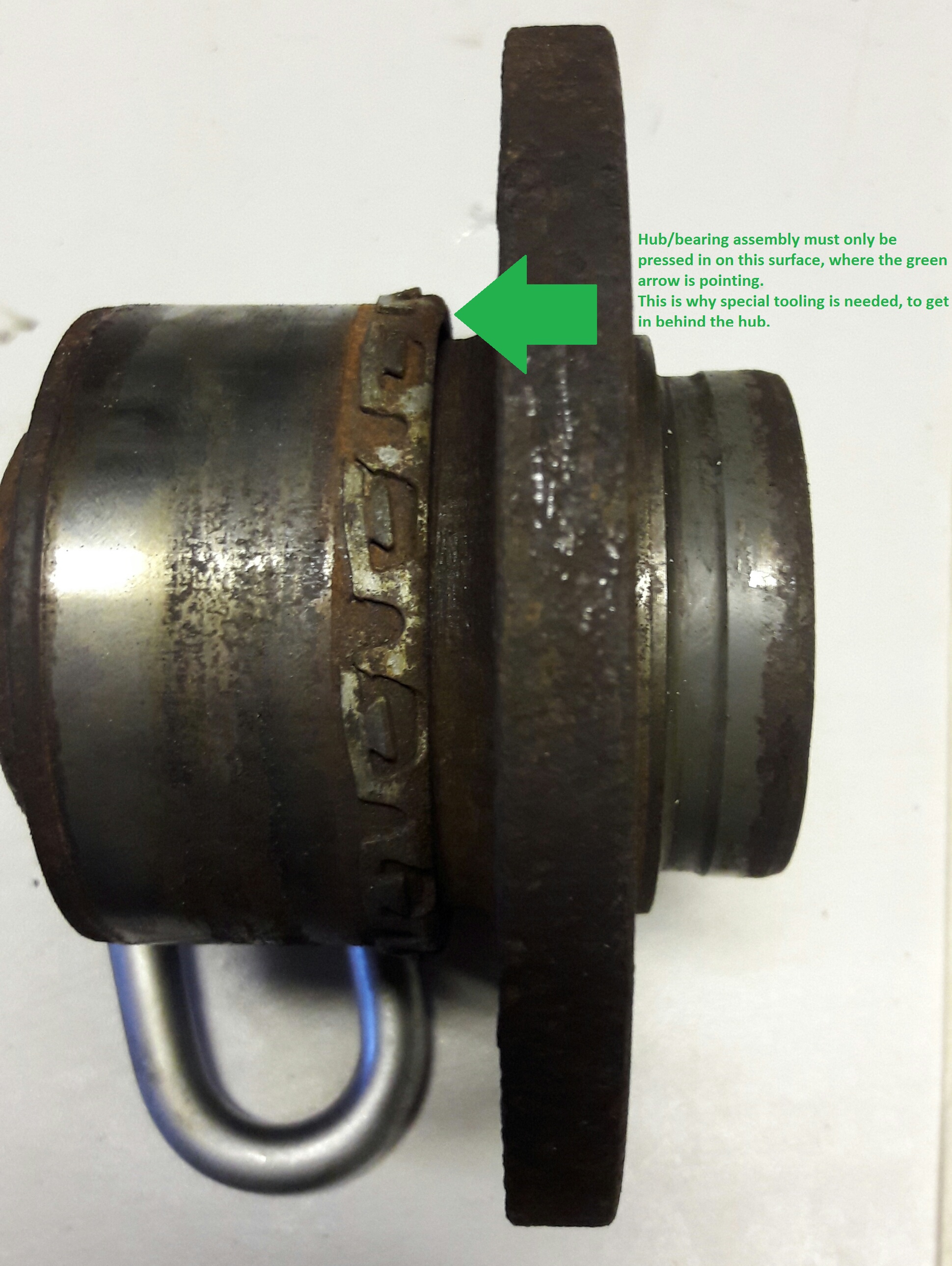

Here's a photo showing where you must press to fit the bearing without damaging it and getting inner and outer into the correct positions.
16 minutes ago, TMB said:
Yes but these bearings are Gen 2 and must only be pressed in by the outer shell. A hydraulic press can still be used to fit them incorrectly.
He didn't push it in there he pushed it from the right hand side of photo
Unfortunately that is the wrong way and it's probably damaged, or at least its life will be reduced.

Unfortunately yes. When you said you heard a crack, that might have been something breaking.
