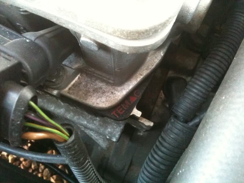

Have a check to see if they've been fitting the proper Skoda uprated gasket. If it's the uprated one it will have red letters saying TEMAC on the front right-hand corner...

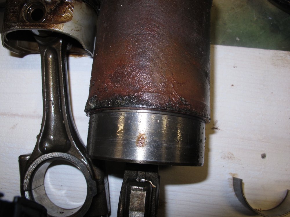

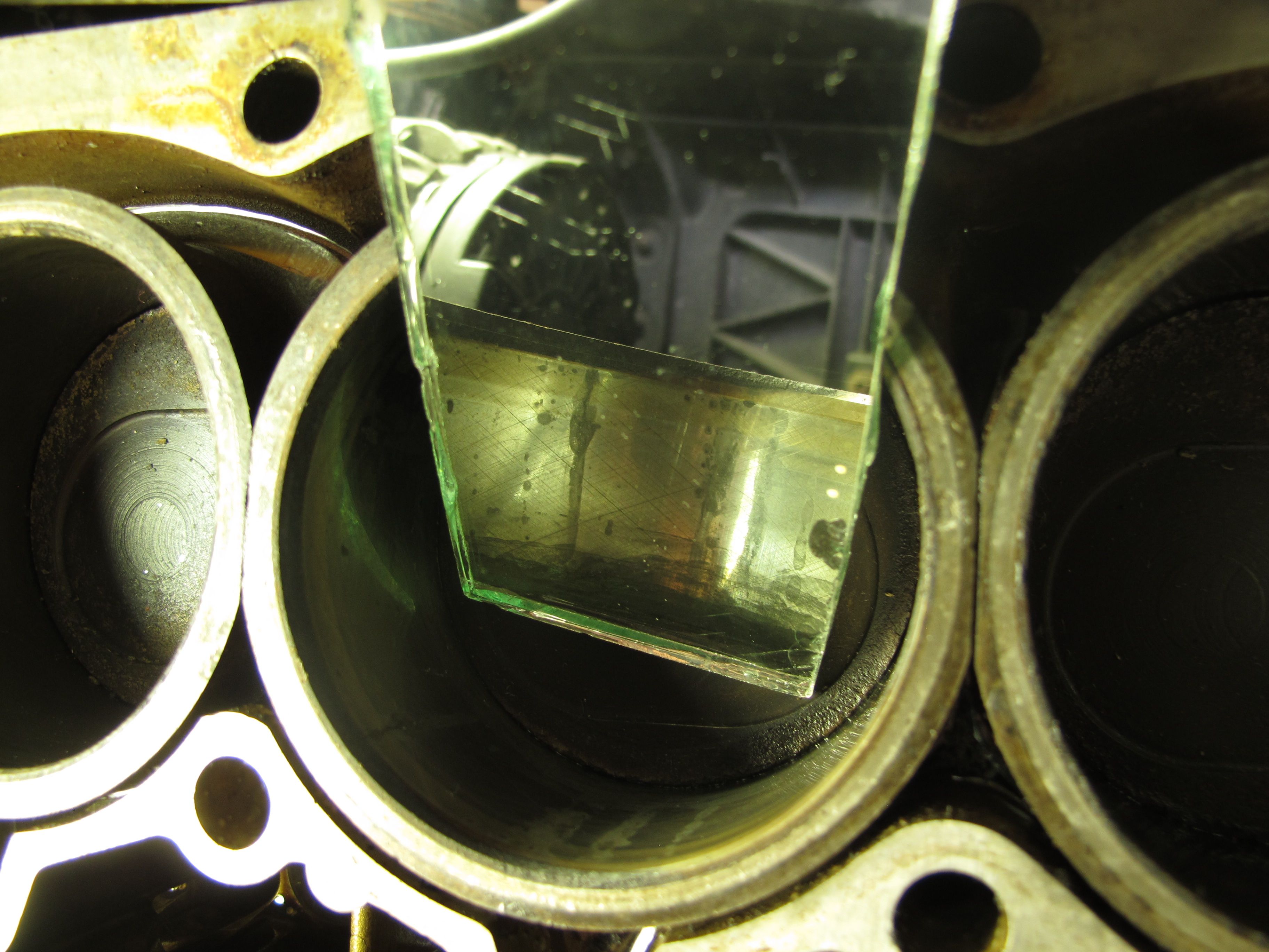

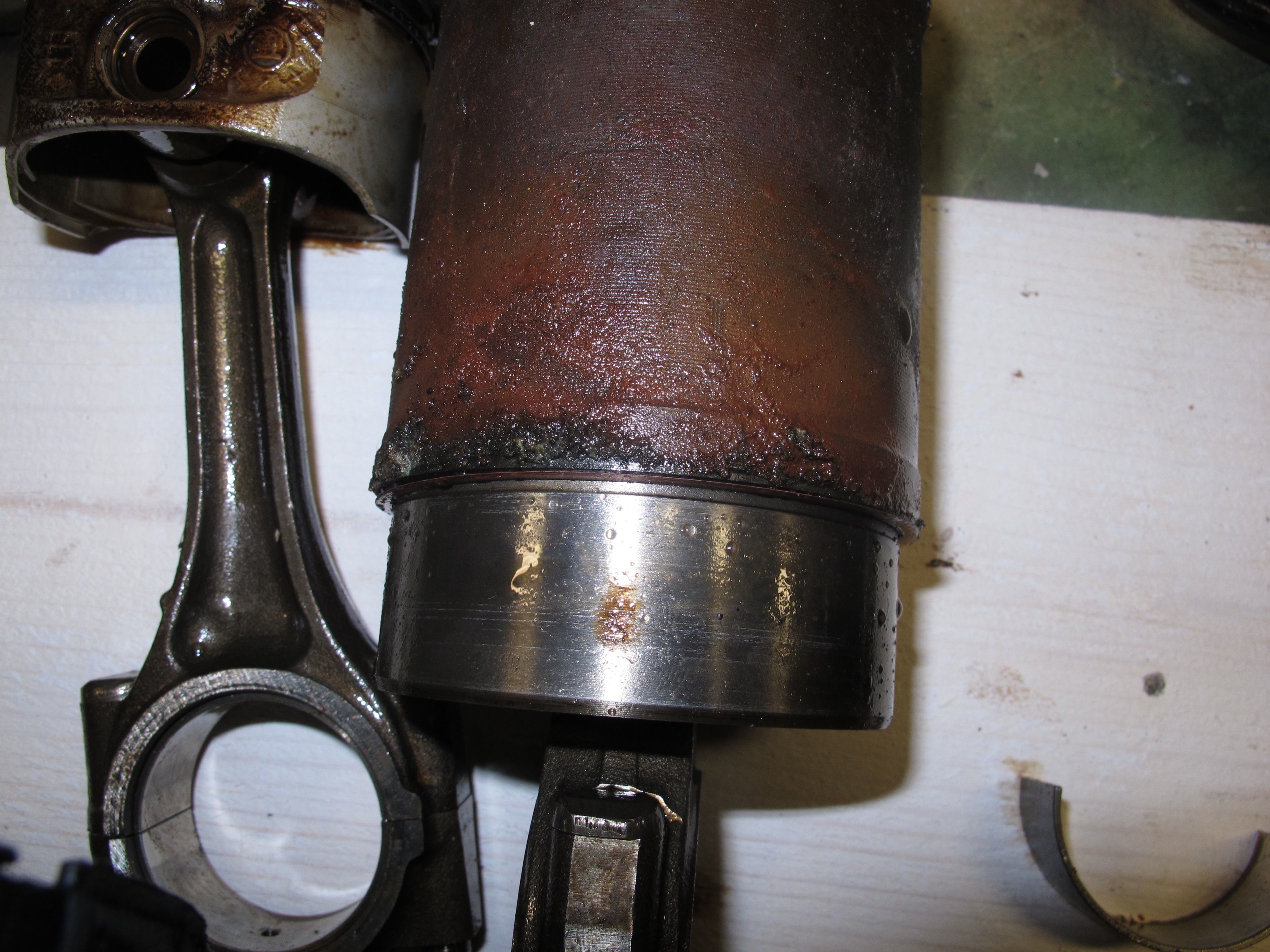

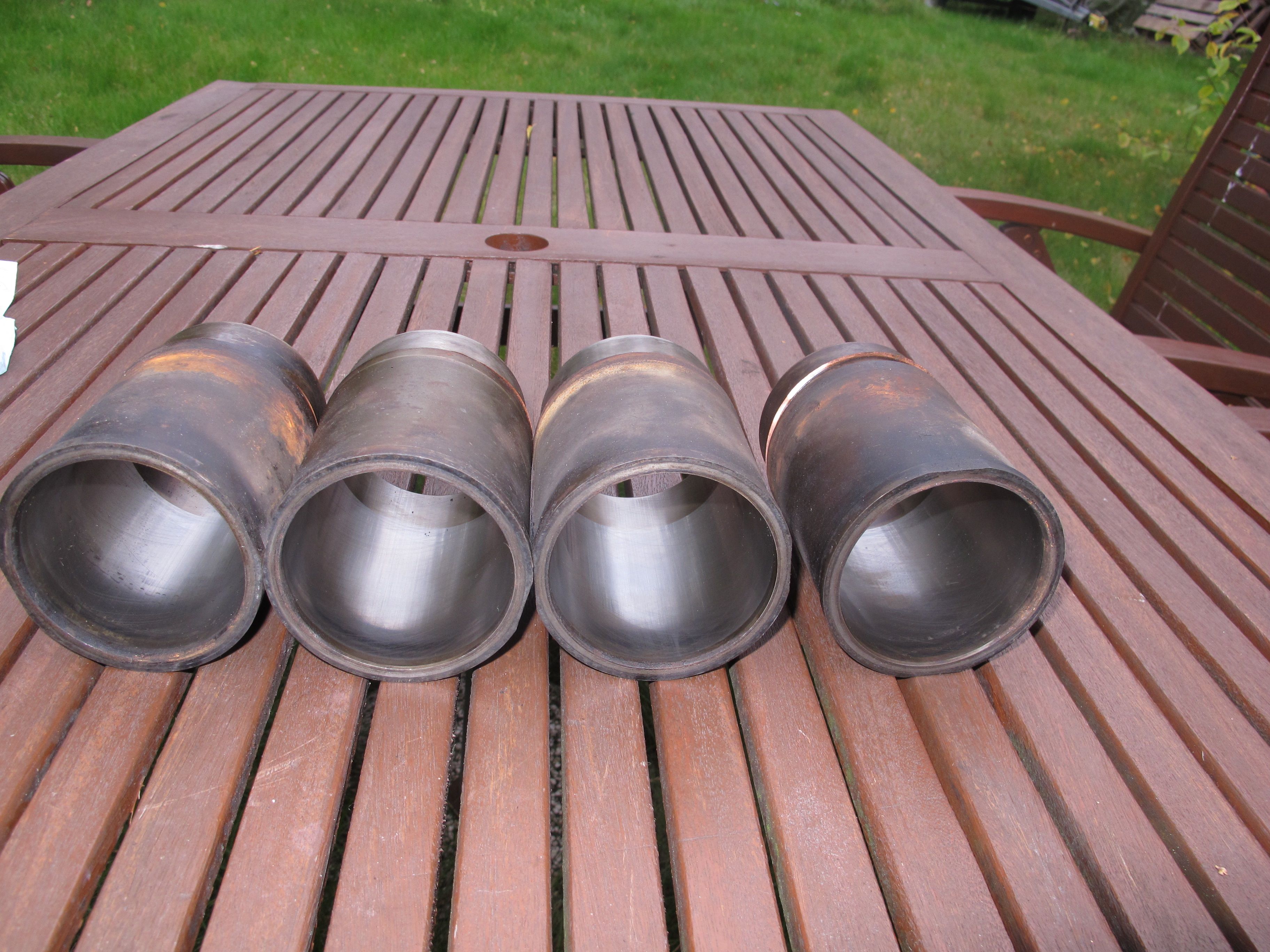

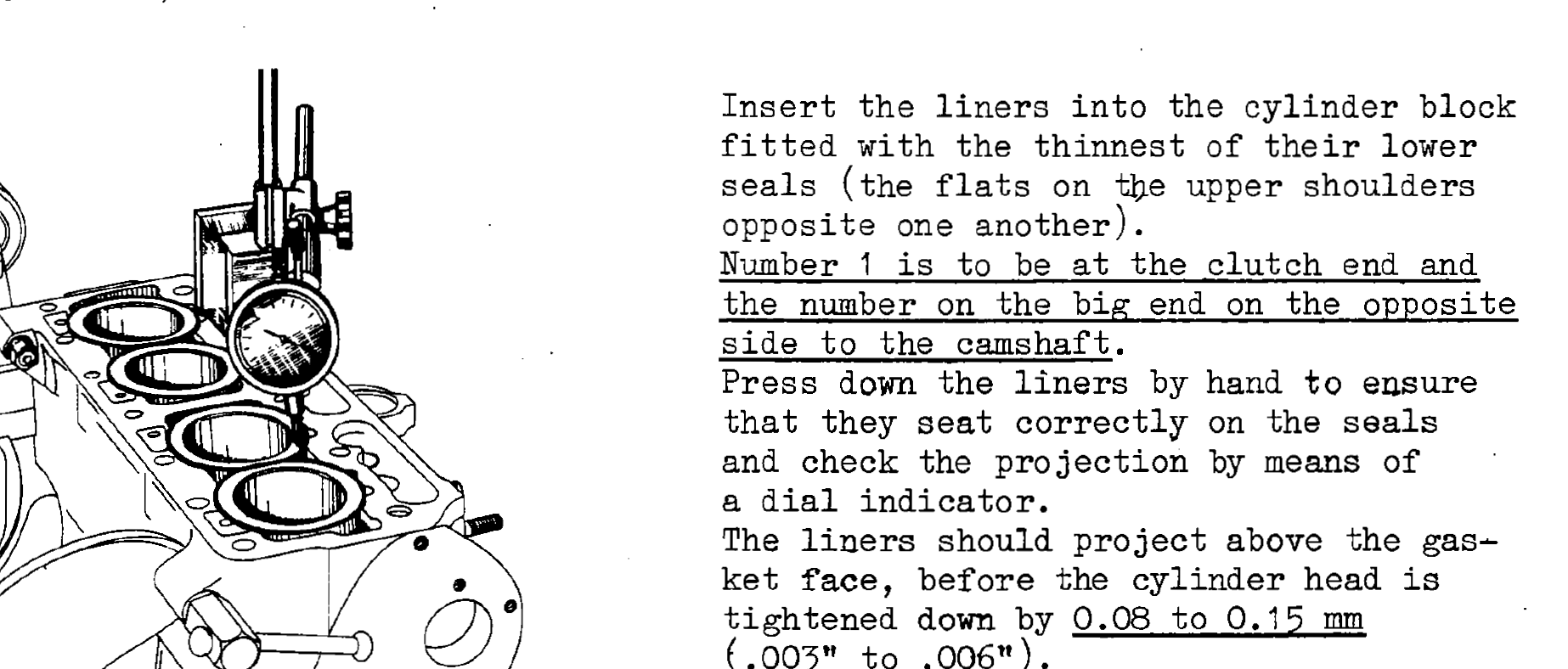

I had to adjust the cylinder height on my 1.4 Mpi-engine. I shimmed up under the cylinders so I get 0,10-0,15 mm higher than the engine block.
Like this in a Renault-engine. Picture 2 FAbia engine. picture 3. My Renault cylinder.  picture 4 new cylinders on my Fabia before honing..  One of the old one had crack. picture 5
Edited by Torbo

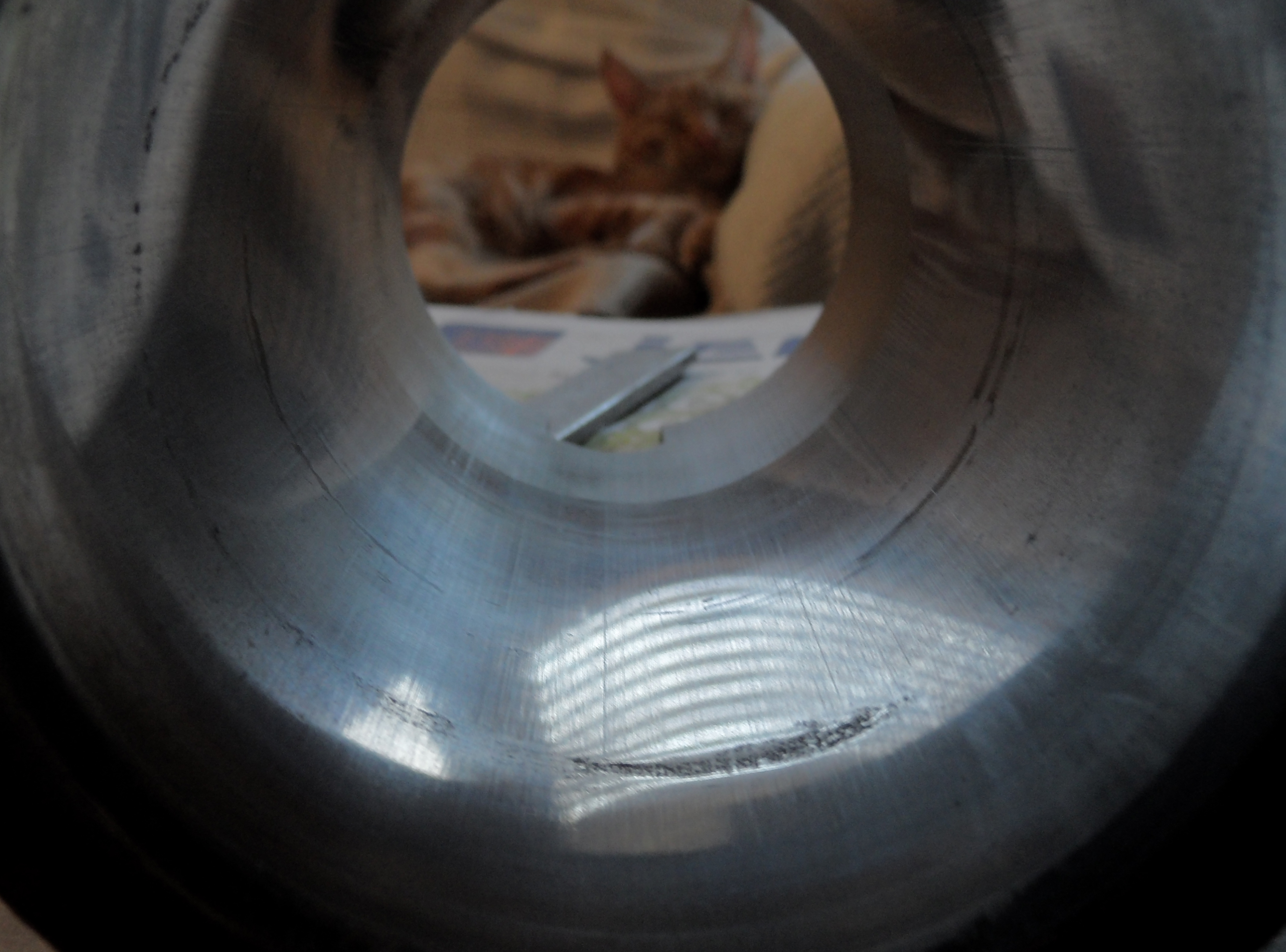

I see Skippy the cat through the liner :biggrin:
He is always around! He like cars:
No it's not could that be it where can I get that type from ???? In Leeds
Well I'm not saying that's what's causing the problem but a proper TEMAC gasket from Skoda should always be fitted.
The gasket is part number 047103383J
