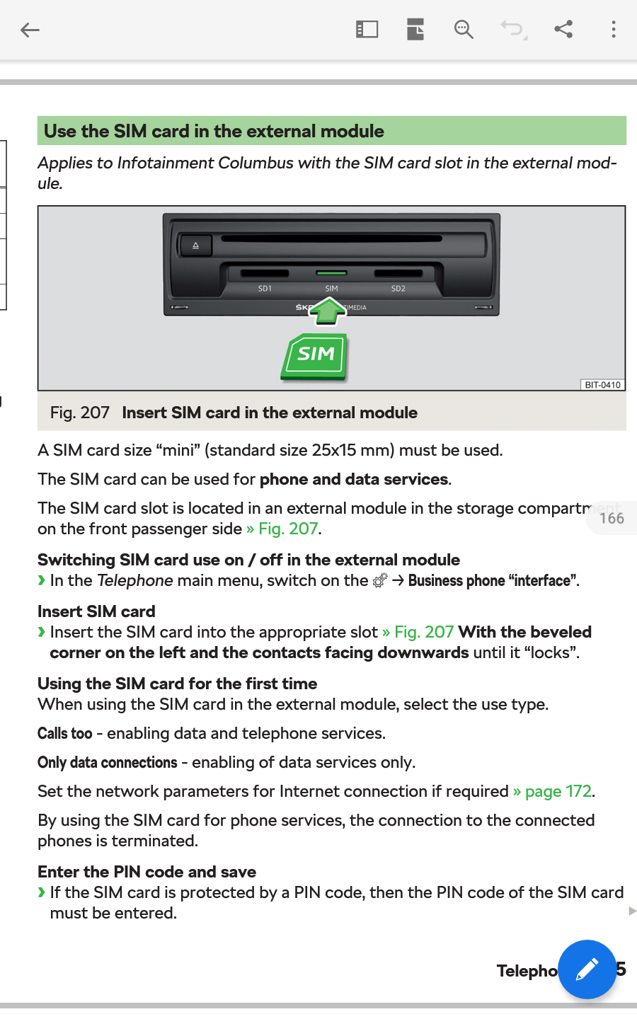

  • When you stick the SIM card in, it asks if you want to use it for 'data' or 'phone+data' - if you choose data, then that's it... it is just a data connection for the Skoda Connect and Infotainment Onl
18 hours ago, john999boy said:
Lol.
As I mentioned in the other thread, you need to insert the SIM in a phone initially to get things up and running.

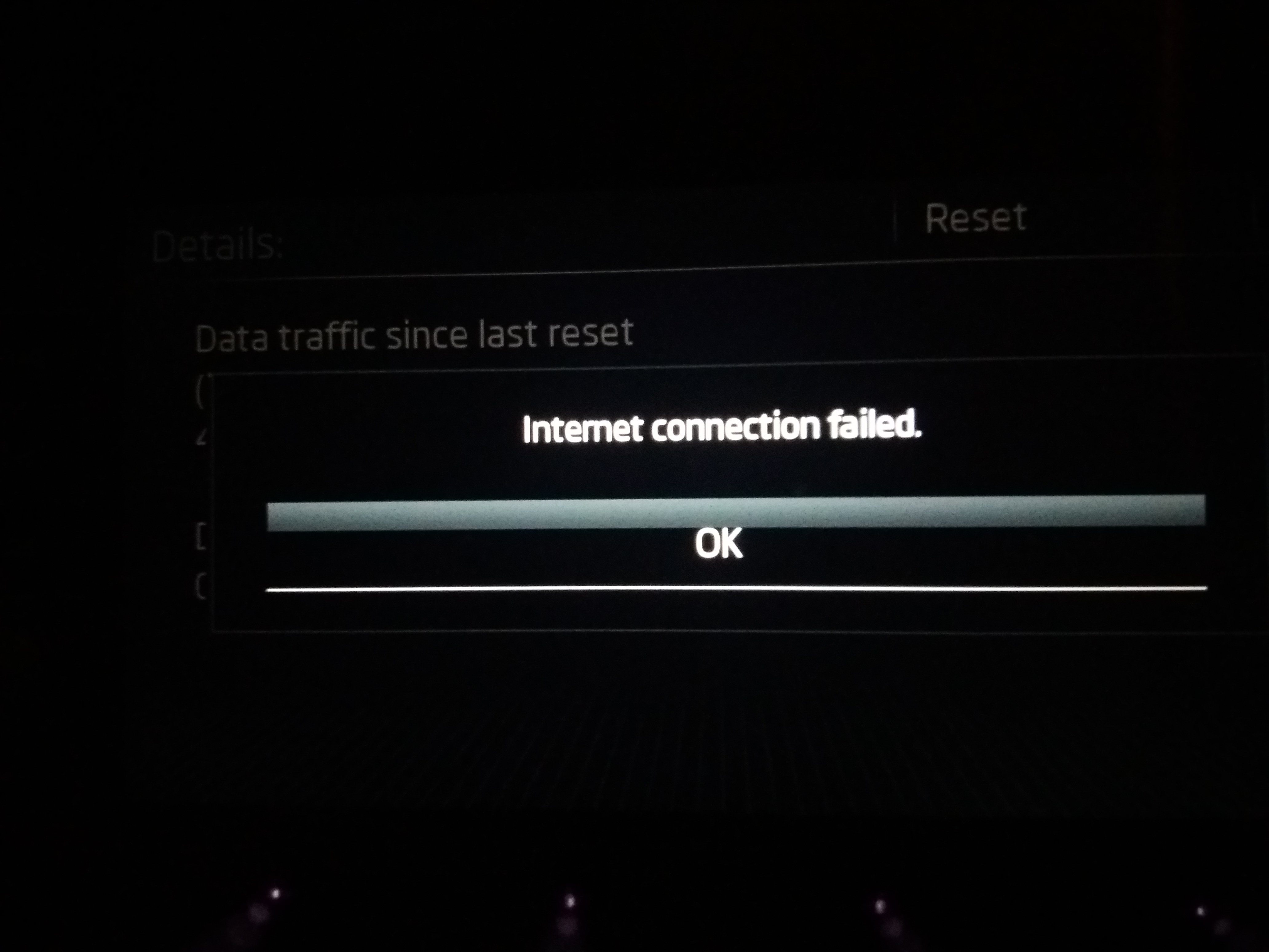

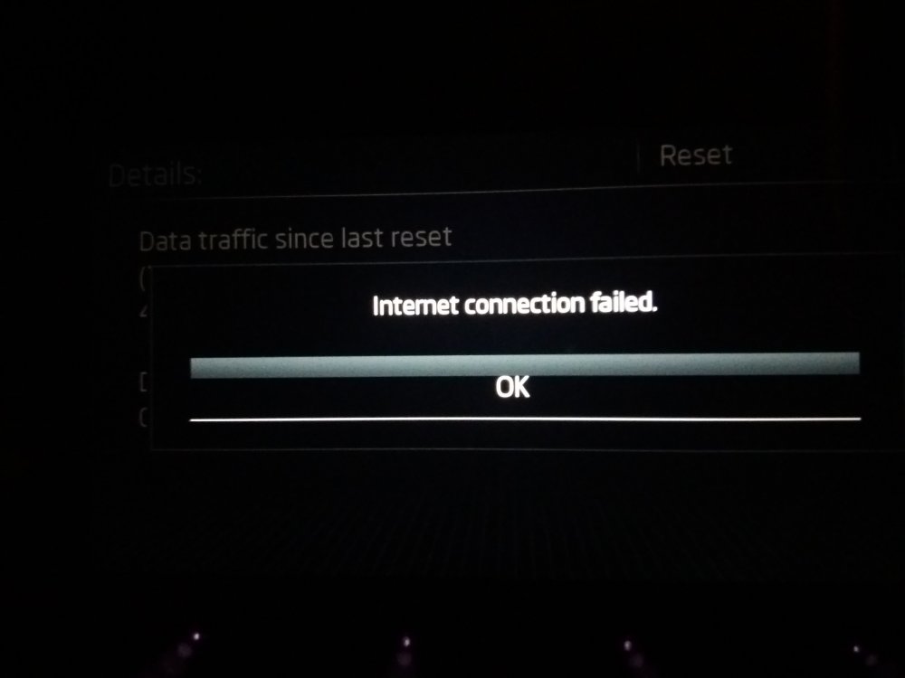

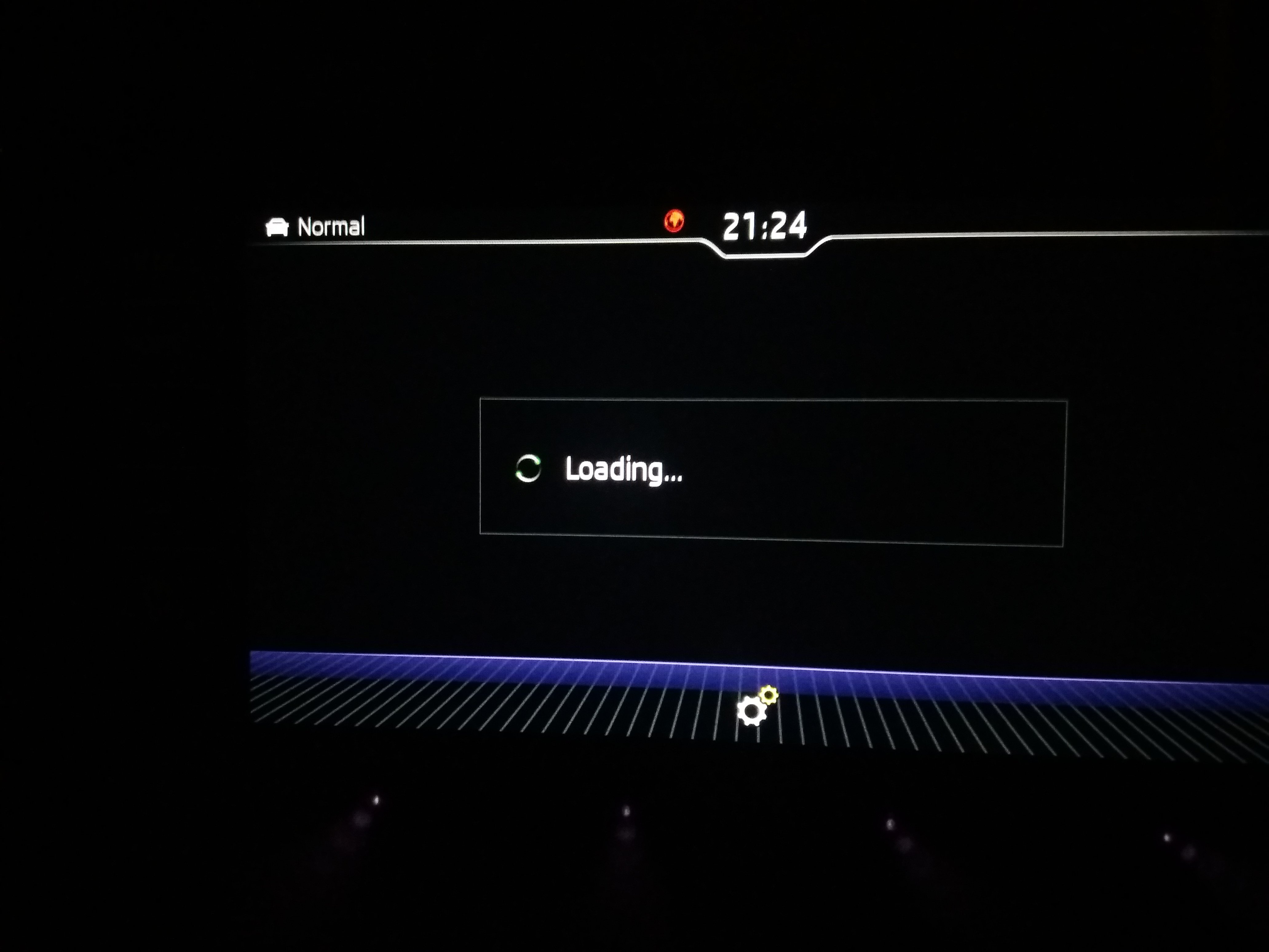

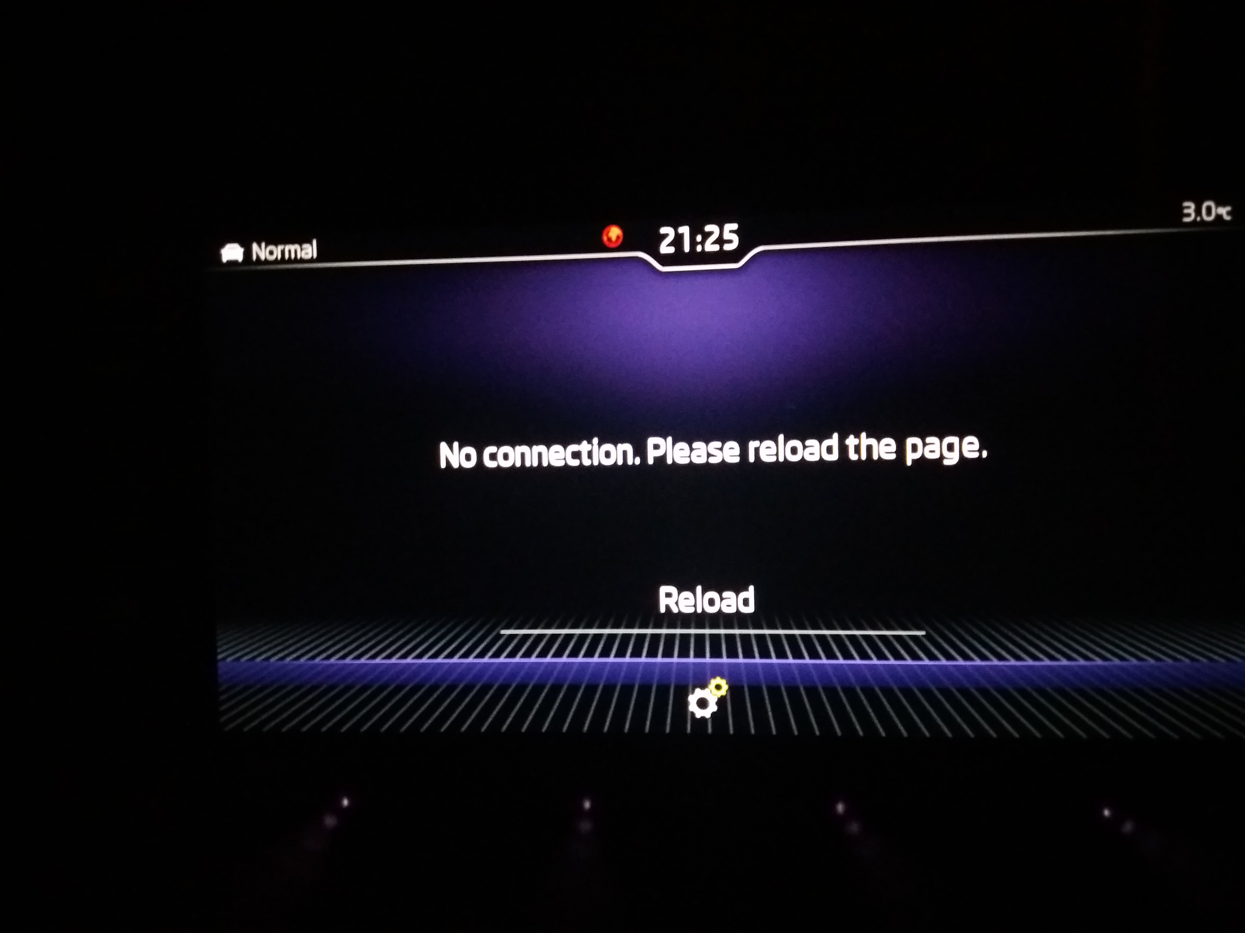

Grrr, "service unavailable".
The little logo of the world has gone from red to white though.
I got that when my previous card ran out of validity - it links to the network (white globej, but doesn’t allow you any data across it.
Just tried it in a phone to be sure, all good, it will happily browse the internet.
Put it back in the car...

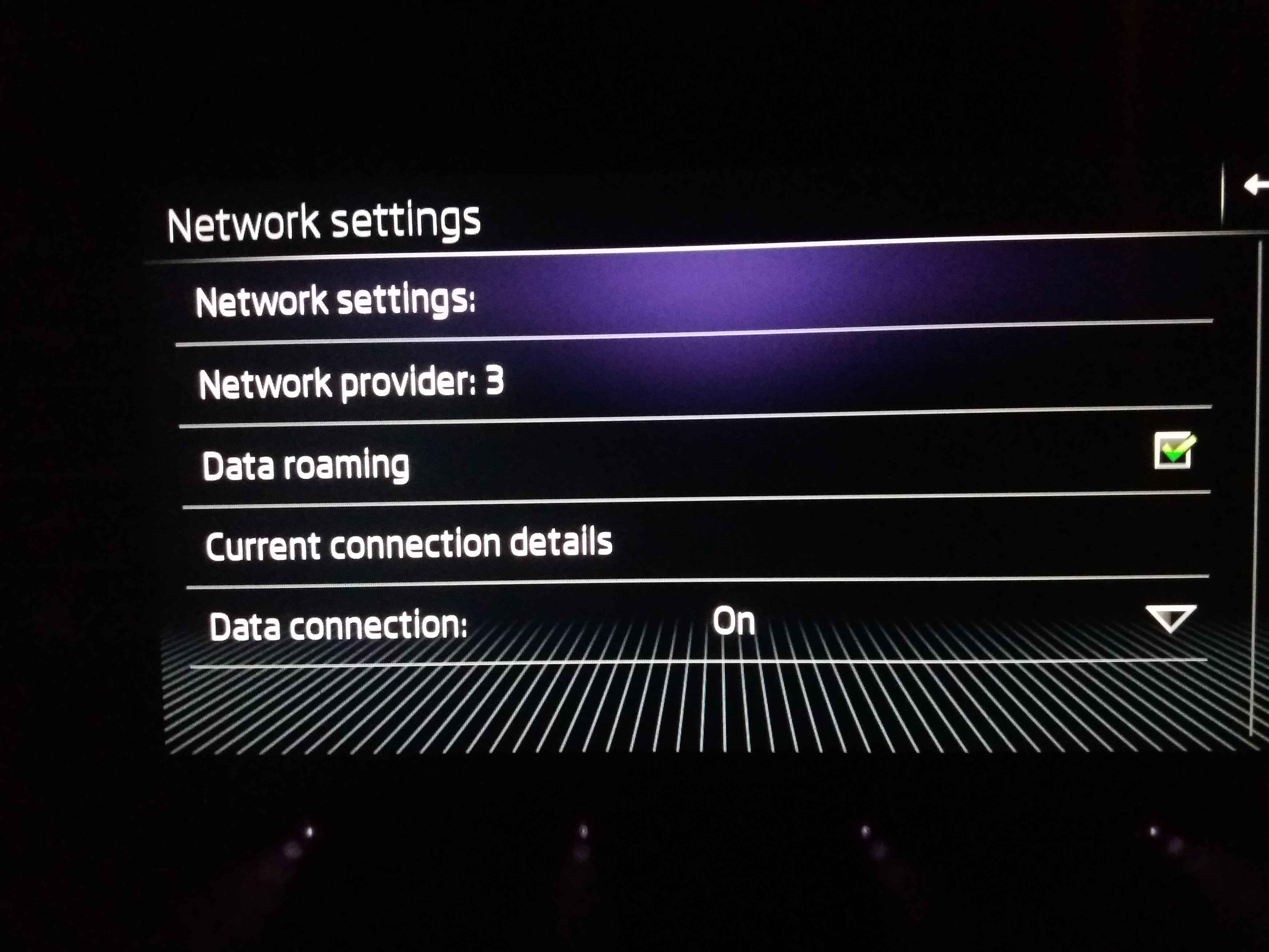

Mine sometimes shows the red globe, even when I know I should have decent reception. It has always sorted itself out eventually. I’ve no idea what causes it - it doesn’t bother me enough to worry about, as I use the built in traffic information on the map as a convenience feature rather than essential.
Try turning the roaming off - that’s fixed it for me before now. No idea why, and turning roaming back on afterwards doesn’t break it again.

To do that Three are assuming the SIM is in a phone...
The SIM is registered though, so I'm pretty sure it's an issue with the setup in the car...
The wife said it worked this morning, until I pointed out to her that her phone was connected and that the reason it was working was more likely due to the fact she was using the data from her phone's SIM card rather than the one in the glovebox...
In my experience, if there is a SIM in the slot it will try and use that and only that. And if it can’t use that, it won’t work at all - even if there is a phone connected via Bluetooth.
That's good to know, perhaps it was using the car's SIM rather than the phone. Here's hoping.
I've told her to turn off the Bluetooth on her phone on the way home tonight and try it again.
I remember that this was already 'ticked'...
In the Telephone Main Menu, switch on the Business phone "interface".
All sorted, seems to have fixed itself overnight :D
Thanks for all the suggestions.

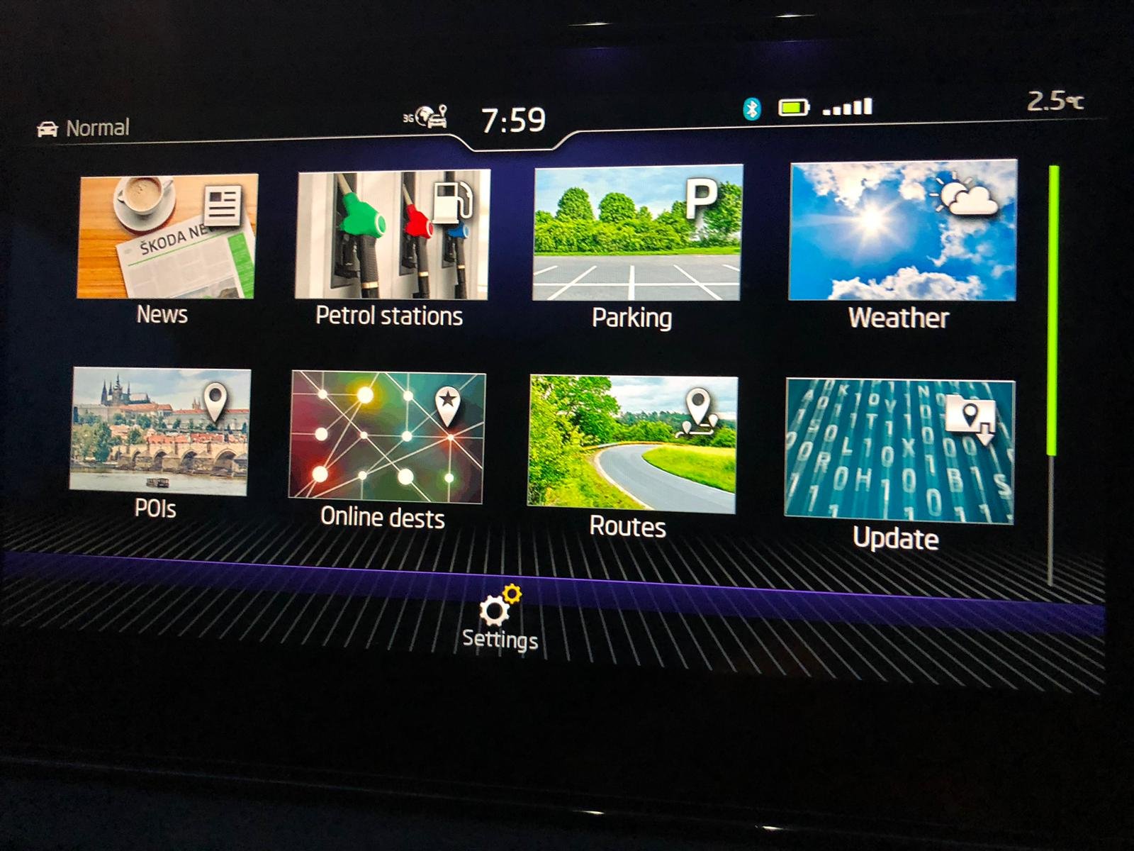

Anyone find a massive software update needed once they got their cars. If I select all updates (I assume all countries) it’s 13.5gb!!
How do you check?
What are the options to do the upgrade?
On a USB stick, or do you have to park close enough to the house so that you can pick up the wi-fi?
7 minutes ago, silver1011 said:
How do you check?
I looked on Skoda connect in the car and went through the menu to updates. Mine has a sim in the car, and it was looking to update via that!!
