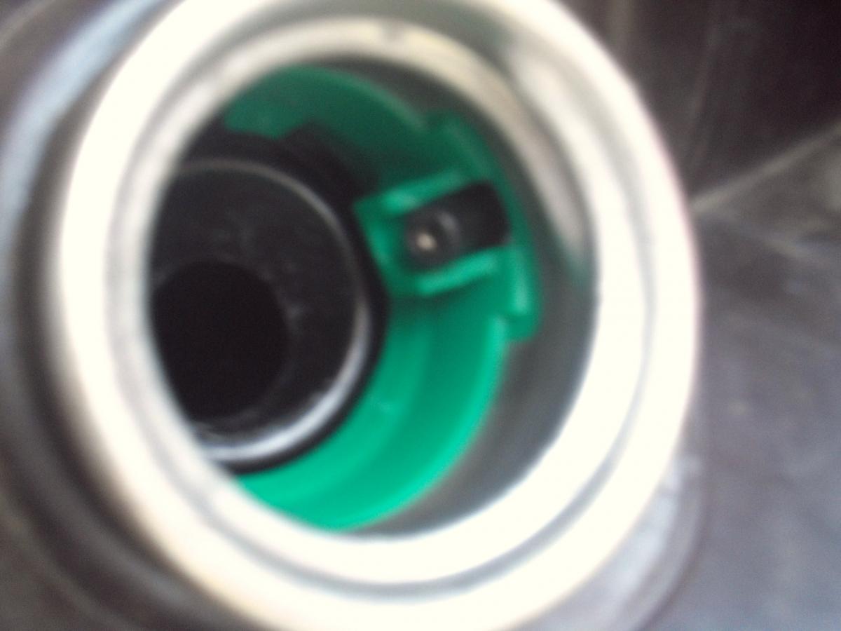

Venting the tank is done when you go beyond just filling to the pump stops.
Some cars have a little vent push type thing and you let the pressure out, get 7 liters or more in, which can be OK with increasing your range,
but not safe if parking the car up having vented the tank, ie taking up the space meant for pressure and temperature changes and expansion.
On Mk2 Fabia people commonly ask why with a 45 litre tank they do not only get 45 -52 litres in but sometime they filled with more,
not knowing they pushed the slide. Or someone else filling up did.
Edited by Offski
If you overfill the tank on petrol models, i.e. carry on after the initial click off point, use the method as offski describes etc, then the charcoal evaporation canister gets saturated with neat petrol and loses its effect, in a lot of cases permanently. The evaporation canister is there to capture and eliminate fumes.
