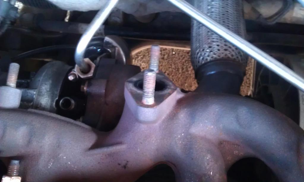

Has anyone got photos of the Mr muscle treatment on the turbo? The guide is brilliant except photobucket has ruined it.
I want to know where to put the pipe in the manifold to spray the Mr muscle.

Stripping the turbo is the 'proper' way but if it's not too bad you can have some success with Mr Muscle. It may take one or two goes (3 or 4 in my case) but it is doable.
If you look at the top of the engine, you'll see the EGR valve (looks a bit like a UFO), from the bottom of that there will be a metal pipe leading down and to the right to the top of the turbo with two 13mm bolts either side. That's the hole you're looking for. The bolts may need some persuasion after 14 years of being attached to the turbo and I'd highly recommend having some spares as you may well drop one and spares are pennies anyway.
You can then just follow most of the guides that all go along the same lines: push the tubing down to the bottom of the turbo and fill it up gently, leave it for a couple of hours with some actuator wiggling every 10-15 mins. Make sure you have gloves on, Mr Muscle is nasty stuff, and make sure you have plenty of stuff to wipe it up with as it does tend to try and get everywhere and there are bits it won't do any favours for.

On the guide on here it says when you take the pipe off the manifold there are two holes inside one goes in to the engine and one the turbo, do you have a photo or know if this is true?
What Followingghosts said is spot on.
You need to feed your tube down into where egr pipe connects to the exhaust manifold.

Would you take the turbo off the manifold or take the manifold and turbo off the head?
No codes, no eml, I will get my mate to read it again on Monday just to make sure, it has been remapped for years and years now by 2 or 3 owners back and it didn't do it when I first bought it which is what made me think it is a dirty turbo.
The stock turbo has the manifold and turbo exhaust side cast as one piece.
So Yeh just remove turbo from the head. Would make it 100 easier to work on.
