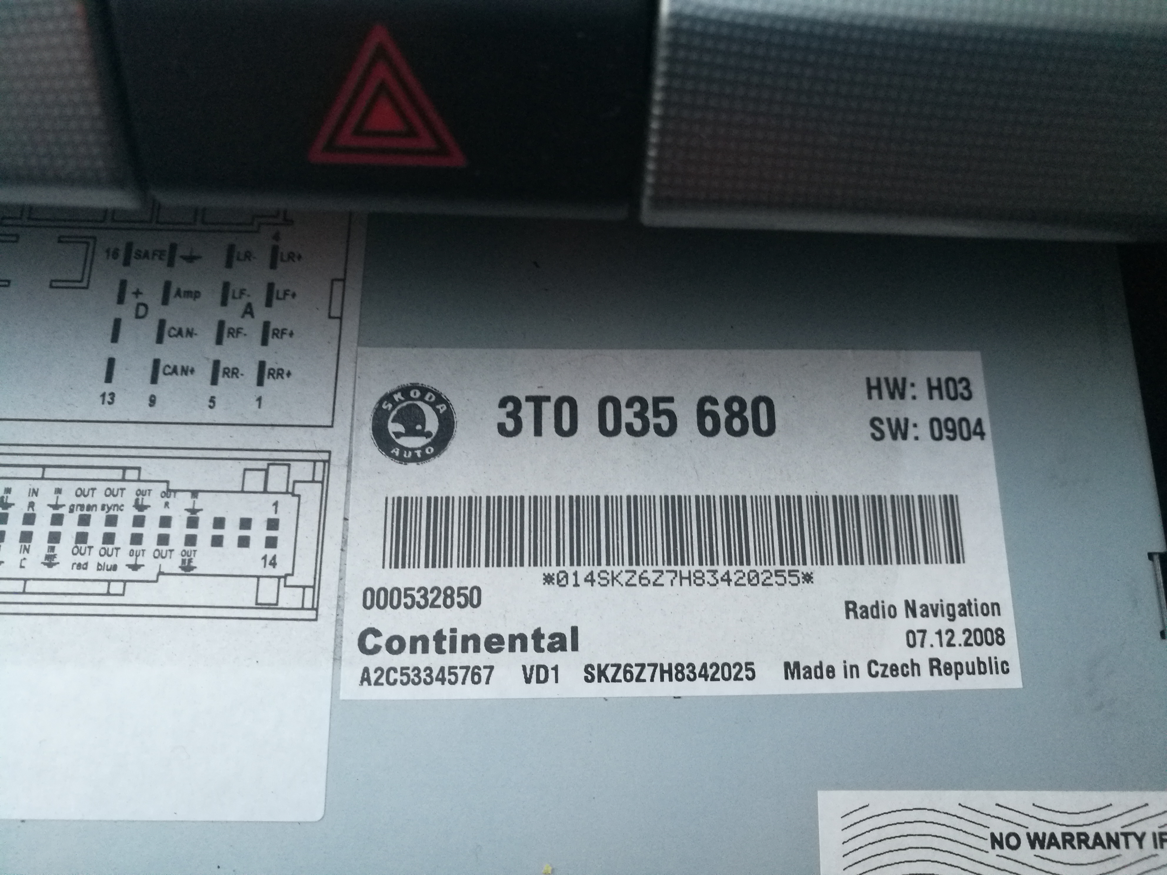

Cheers for the advice. So I popped the stereo out of the dash, I've got a unit made on 07.12.2008 with software version 0904.
I've attached a photo. Can you advise how I interpret the numbers so I know which unit I have?

You have a very early unit (although not one of the very first which were made by Siemens). Looking at the data label there and the details on your first post, your unit has been updated at some point. The software has been updated from 0904 to 3984 at some point. Maps I couldn't say but I suspect they were done about the same time.
