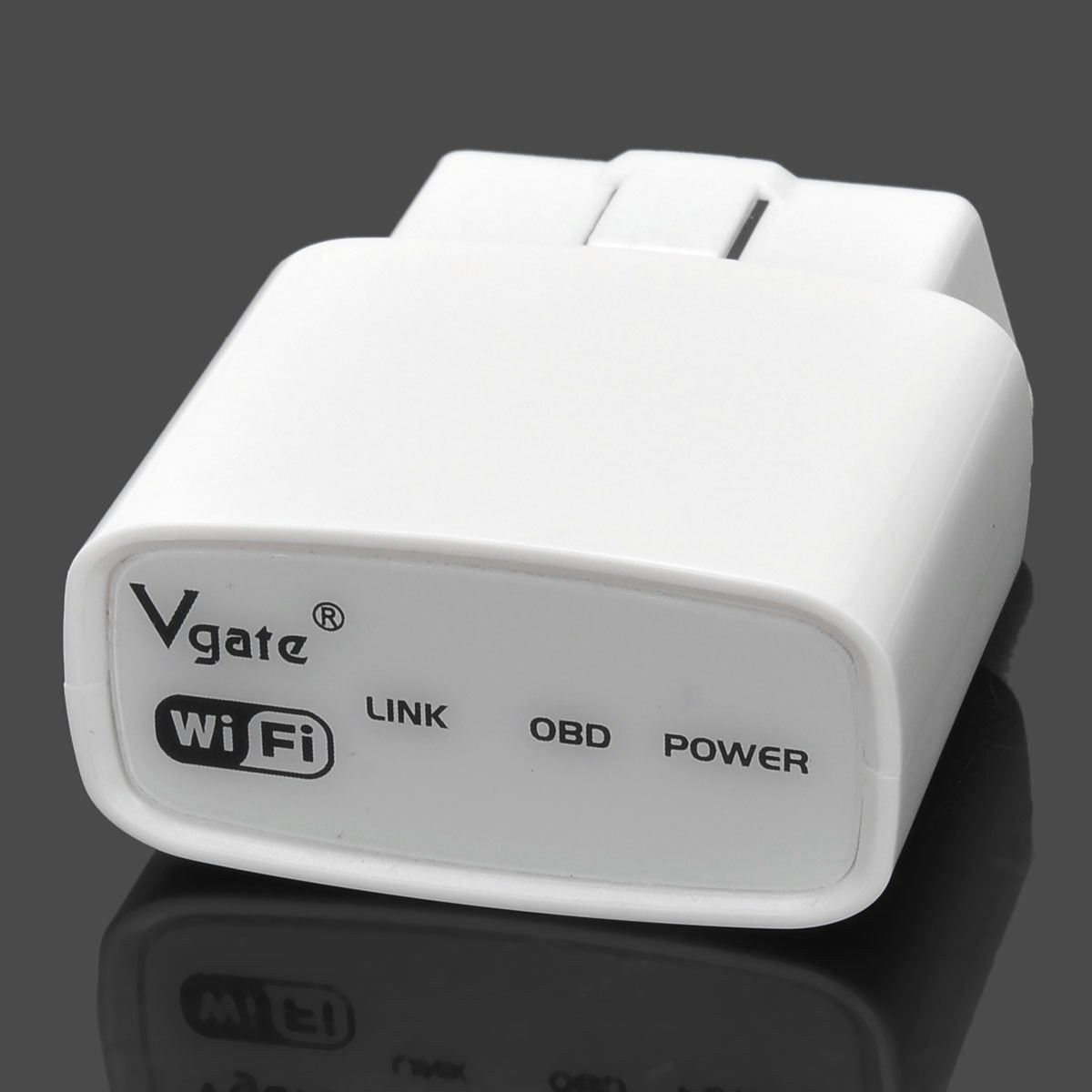

Hi,
I've posted on another thread of this forum regarding high oil consumption on my Oct MK3 VRS TDI2.0 year 2014. as this problem lead to investigation of DPF behavior and health status.
So here comes my observations maybe someone has noticed similar behavior of DPF readings :)
Last weekend finally received my Vgate iCar2 and gave it a test to see what VAG DPF has to say regarding DPF health of my car. Of corse my concerns regarding Oil Ash Residue were confirmed. The app says that there is 53.3 (67%) of Oil ash accumulated in DPF.
But I've noticed one more strange thing, sudden spikes of Soot mass, while driving evenly on motorway Soot mass indicator suddenly jumps from 20% to >60% and car automatically starts regeneration cycle, which also ends quite quickly comparing to cycle which starts when Soot Mass has reached >50% on slow accumulation.
Does anyone had this experience with VAG DPF app recording sudden spikes on Soot Mass? What do you think is it real or just some sensor used for cars ECU to calculate Soot Mass is giving false readings?

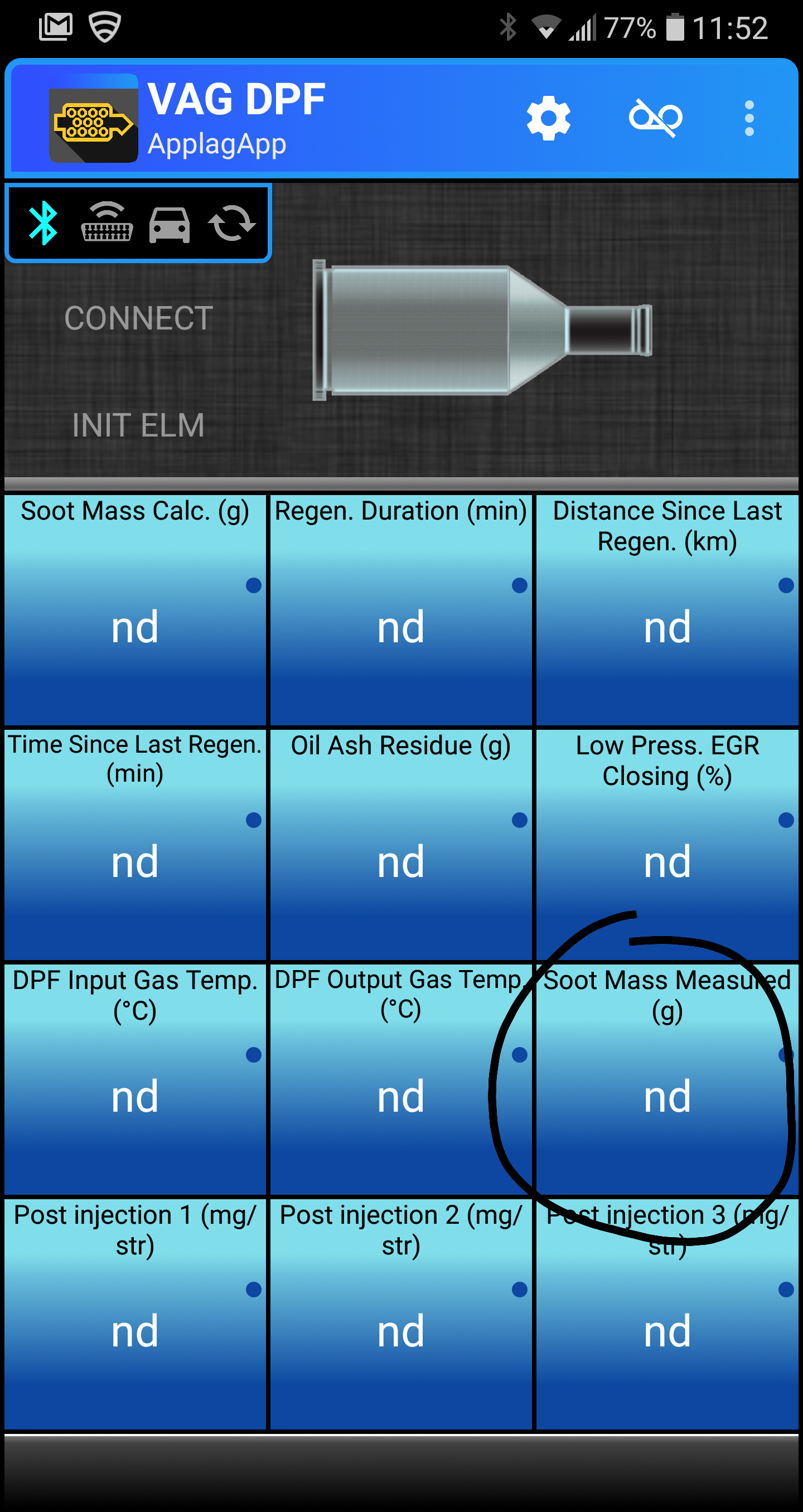

Someone has previously posted that they can see a measured soot as well as calculated soot. See the app unconnected vs screenshot connected, that's all.

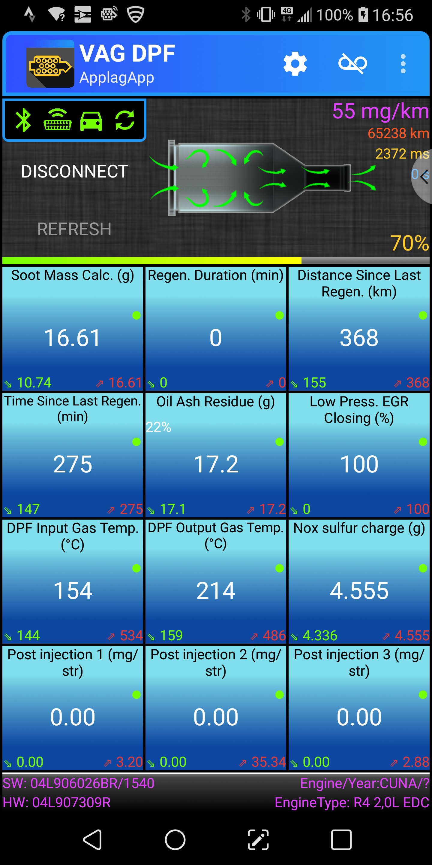

I've also noticed that on some cars the soot output is measured in mg/min and others like mine mg/km
Either way, it's a really useful real time indicator of the amount of soot the engine is allegedly producing

I don't see an actual soot level, instead a see a NOx measure...
Maybe the available data fields vary by ECU type or engine type?
I can see both "calculated" and "actual" soot levels, I have no "Nox Sulfur Charge", and my "Oil Ash Residue" shows "nd" (which I assume is "no data").
My engine type is CFJA.
I find the "actual" soot level to be more interesting and immediately reflects the current driving style / EGTs etc; the "calculated" level tends to just rise more steadily - never decreases (unless you manage to get EGTs very high, like 6-700ºC then it does drop a bit until the temps reduce again).

All of that makes complete sense, though I'm surprised at regen frequency. I've simply not noticed it in previous 12 months with the box, bearing in mind my typicsl weekly mileage is around 500 miles, and generally 150 miles between stops. The key number is the instantaneous soot mg/km figure. Hard acceleration with map and it hits 120mg/km. Cruising at 90 on m way its between 15 and 25.
Just taken it for a 25 mile trip, the soot output seems to be similar (we've taken the map off to do a baseline comparison) so maybe the performance map isn't making huge amounts of additional soot after all. Off the bham tomorrow for a 450 mile round trip so I'll have more comparison data. If std tune means a regen every 300-400km then I'll put the performance map back on and not sweat over it.
Not sure it's ever done a passive regen. DPF temps never get much above 350°C no matter how I drive it and I never see the barrel icon turn red and the soot level drop. It only ever does that when the #2 and #3 post stroke injectors start operating and raising the temps to over 500°C
Edited by stever750
The post-injection and red barrel icon indicate an active regen. Nothing actually happens for a passive regen, it's not an "event" as such, you just see the "measured" soot value start to drop a bit as the soot gets burnt off by the (just-hot-enough) exhaust gas generated by normal running. (You won't see the "calculated" value drop though.)
If you're doing long journeys it's quite likely active regens have been happening and you've never noticed. If I'm on a steady 50-60mph cruise it can complete a full active regen from nearly 20mg soot down to a few grams in under 10 miles. You can sometimes hear a deeper exhaust note while it's happening but it seems quite dependent on engine RPM whether you notice it or not.
Conversely if I'm on a route where speeds are lower or there are a mix of uphills/downhills (the EGTs keep tailing off on the downhills!) and constantly changing speeds it can take 40+ miles to complete.

I appear to have made the same mistake! I bought this one (picture also attached) and found it was receiving power when connected & the car scanner app connected to the ELM but there was no successful connection to the ECU; it kept cycling through different protocols trying to detect the right one and failing each time. How can one tell if its a genuine OBDII reader? I'm only looking for a basic one but also want to avoid the fake ones!
Carista obd £9.99 at Amazon. Reputable make which I successfully use
