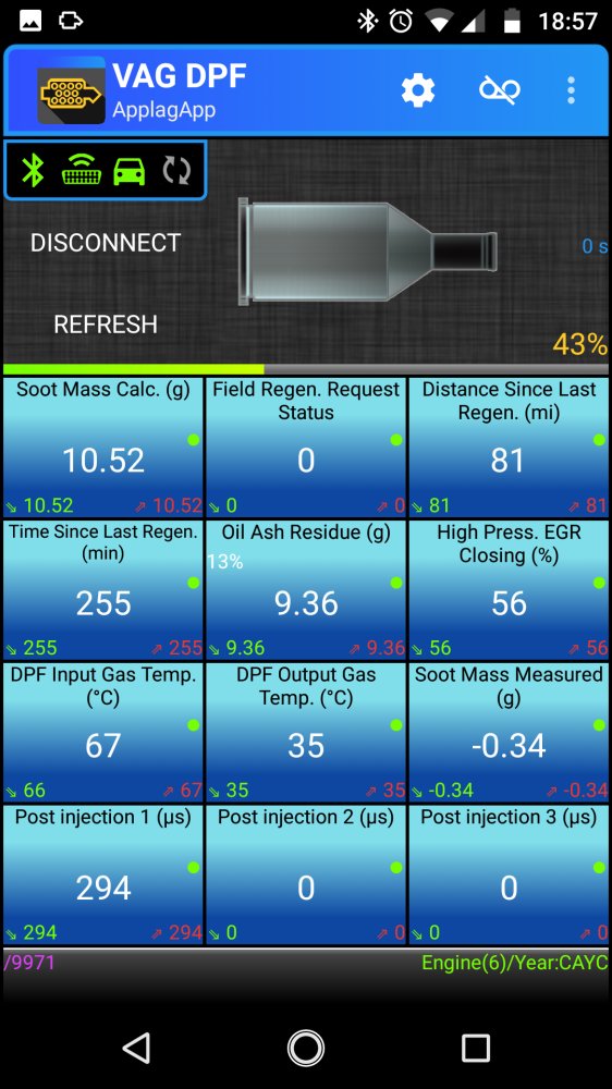

What's the oil ash reading as G and %?
This is mine at about 26,000 miles.
Edited by Urrell
I’m not sure how to export the screenshots off my old Samsung phone now unused except for this app. At 12091 miles the oil ash Reading is 5.1gm and 6%.
The oil ash went up from 5gm to 5.1gm before/after regeneration

Ah, I thought oil ash residue was low for 120080 miles in the first post..
I think it relates well to your results with your mileage being double mine
Read the mileage you have put in your 1st post, nearly 5 times mine.

Do you not have it as a percentage in white like mine reading 13% above?

Looking at the screenshot from Urrel, the app suggests the maximum is ~72g (based on 9.36g being 13%) and therefor the lifetime could be 200,000 miles for their DPF.

The figure 175ml has been mentioned a few times but it'll depend on the engine code as to how it reports oil ash (g or ml). At least for Urrel, the DPF app suggest a max of 72g for the CAYC.
