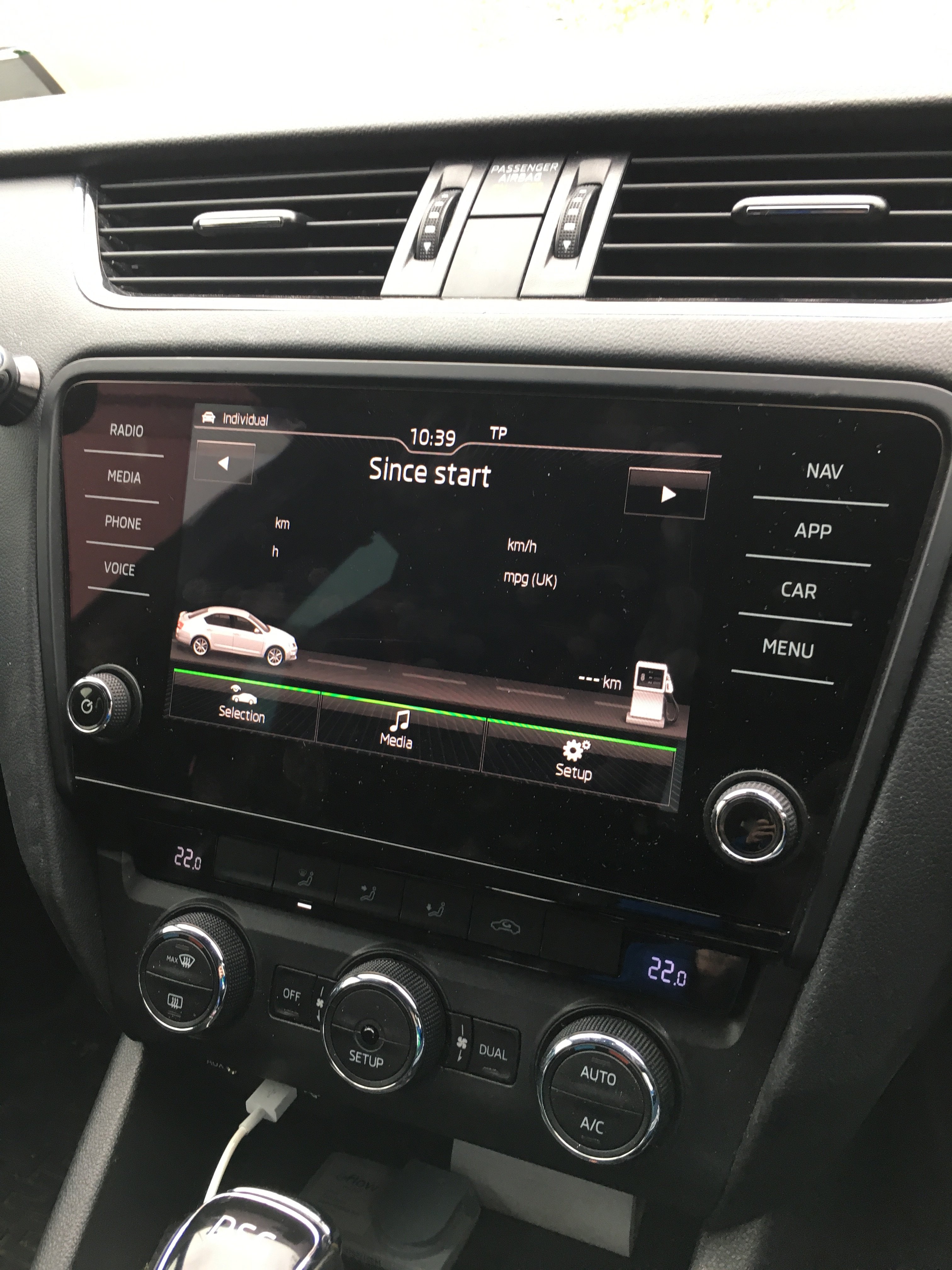

So fitted the rest of the black emblems today , very happy with the result,
Then halfway through fitting the letters my MIB2 from @pab567 arrived , so once I finished the emblems I went straight into fitting my new screen and MIB2 unit.
What can I say , @pab567 done a cracking job supplying the unit and coding.
if you’re considering a retro fit give him a shout , you won’t regret it.
Also thanks @SashaGrace cause Of her thread and mods it inspired me to do the same(was jealous  :biggrin:)
so that’s me done for a while will prob plastidip the grill vRS emblem in a couple of weeks and maybe spacers next but nothing major.

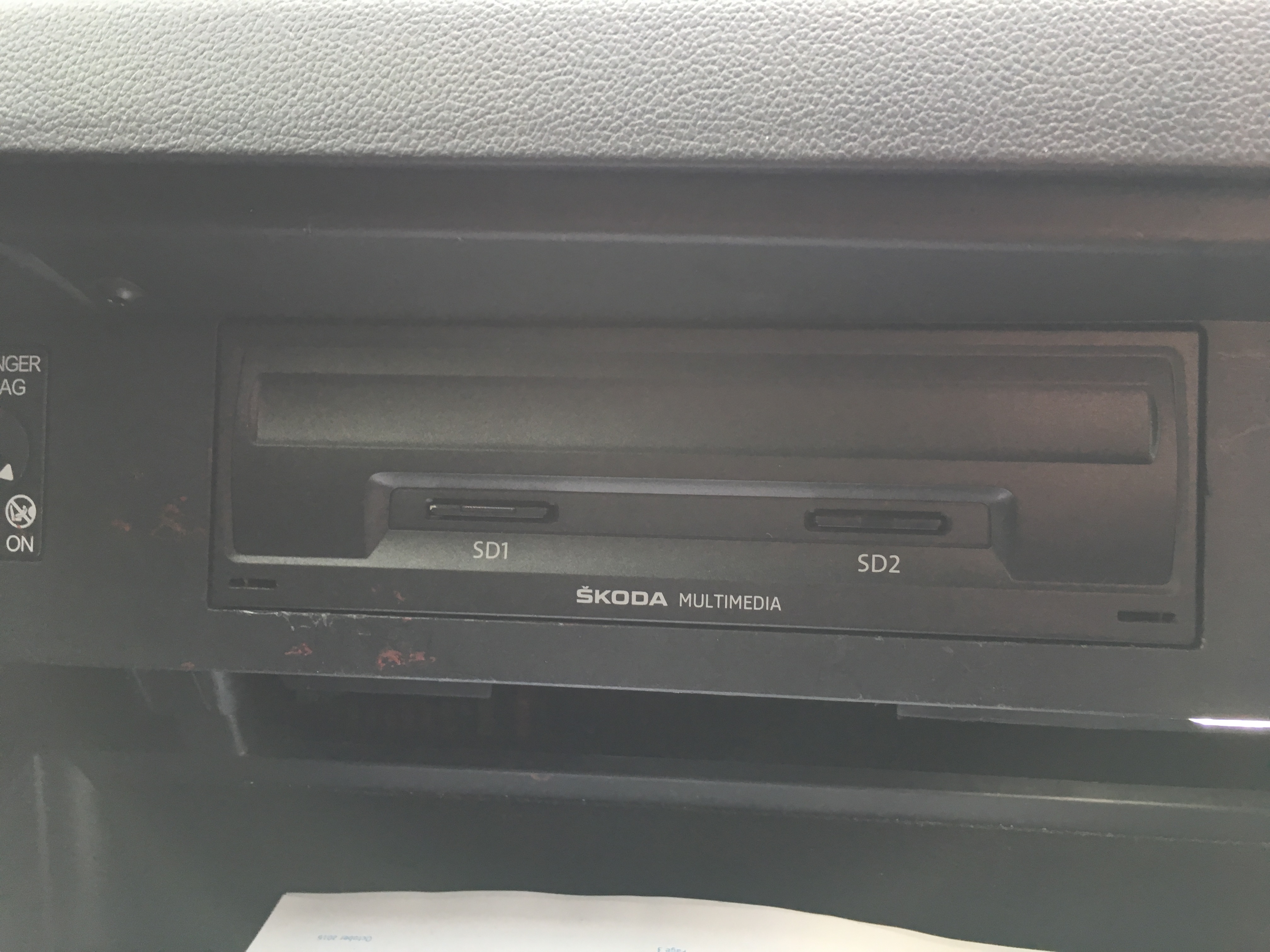

with the headunit how can you tell if its MIB2 or not i hvent figured it out and most of the breakers just photo the label. and done know them selves.
I actually have a 6.5 screen for mib 2 that i brought of of sasha if you're interested, as for a unit, speak to @pab567 i got my unit off of him and have vcds at the ready.
Looks like alot of breakers have copped on and have increased prices on units, but a unit off of a post 16 skoda except the yeti's should be ok.
Edited by seanbrady49
MIB2 Skoda units made by Technisat start with 5Q0 (Bolero, Amundsen) and made by Harman start with 3V0 (Columbus, pre-FL) or 565 (Columbus, FL). Any unit that starts with 5E0 is MIB1.
Easy way to tell. If it has 1 SD slot and no CD slot it’s definitely a MIB2 Bolero. If it has 2 SD slots and no CD slot it’s definitely a MIB2 Amundsen. Spotting a Columbus is relying on a part number.

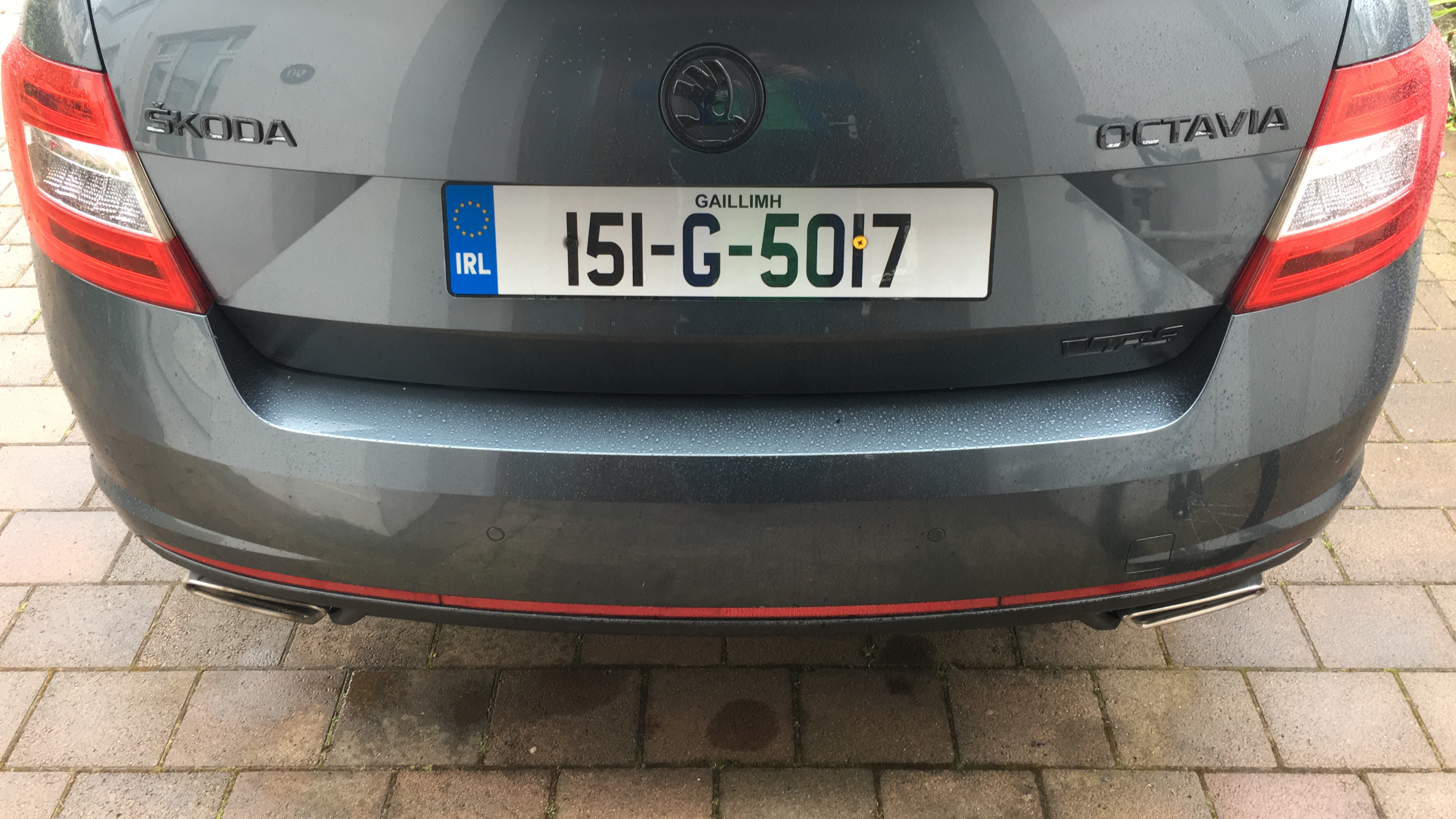

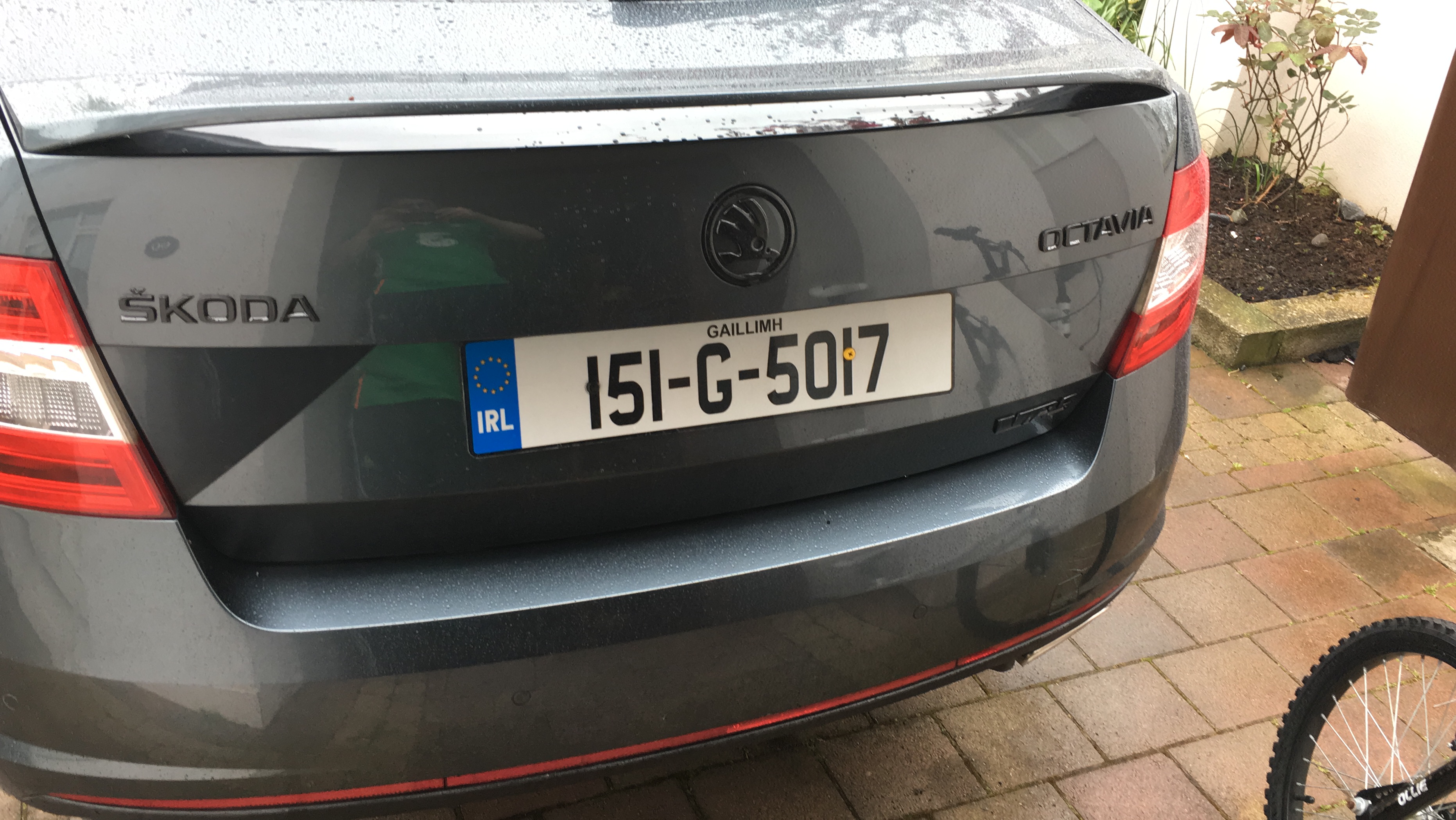

Why the Yellow Screw on the Rear No Plate, trying to make it i rather than I?
uk import, too lazy to get a black screw.:biggrin:
