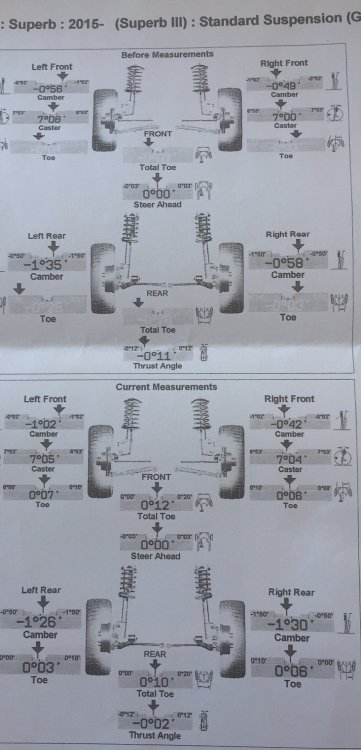

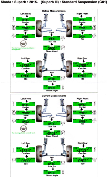

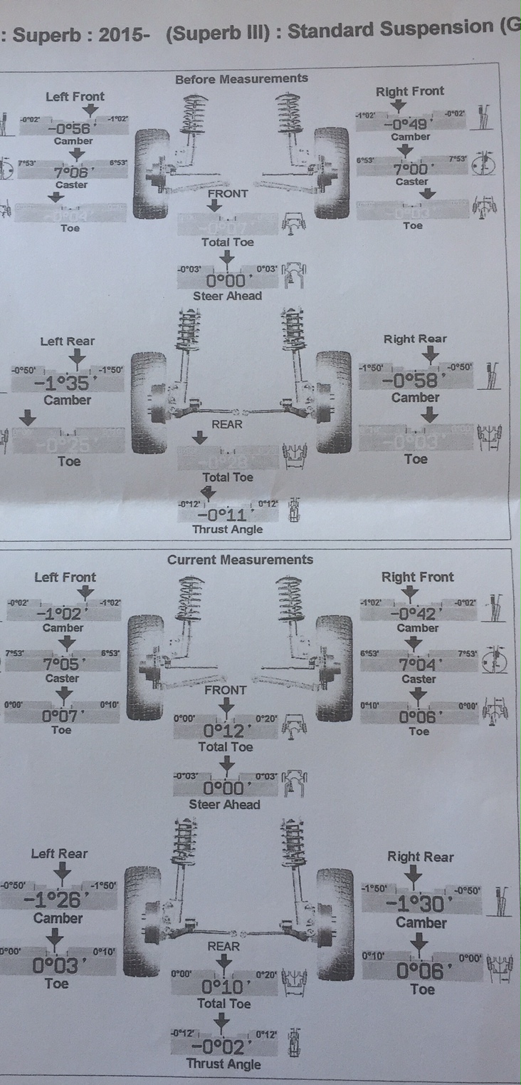

Seeing an opportunity, I asked the bodyshop to align all 4 wheels as part of the repair process, and attached is the print out they've sent back with the car. It's black and white unfortunately, but laid out next to the accurate colour report I snatched from another post on this forum, mine on the surface at least, looks somewhat outside tolerance.
In the "Before" example, mine looks almost right. In the "Current", the left-front is quite vastly different. I'm now concerned that by lining up the geometry, it's exposed that either the suspension hasn't been refitted to the car properly, or that the bump's caused the car's frame to twist somewhere.
Obvious solutions would be to either have the car put on a Hunter somewhere else for further alignment, and another would be to chuck the car back at the bodyshop, but that causes all sorts of other issues so I'd rather avoid it if I can.
Does anyone have a solid idea if the attached black and white "Current" set up in the lower image is OK?

I would recommend getting the tracking done on another (recently calibrated) Hunter setup. Even if the camber is out due to damage or poorly fitted suspension/subframe bolts you will have a much better argument with independent confirmation. Fingers crossed it’s just their setup that’s not been calibrated in years… might be why they only like to provide mono printouts?
Kwik Fit gets a hard time, but they love tracking because it’s all margin and most centres have live video of the work being done. Their Hunter calibration doesn’t come out of the workshop budget so managers are happy to have it done.
