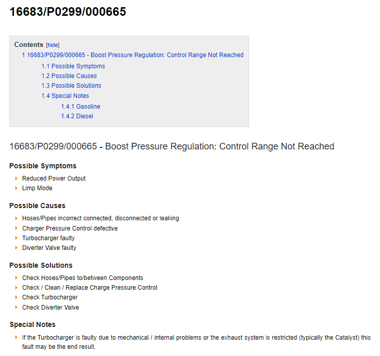

Extract of fault scan below....
3 Faults Found:
19225 - Boost Pressure Regulation
          P0299 00 [101] - Control Range Not Reached
          Not Confirmed - Tested Since Memory Clear
             Freeze Frame:
                    Fault Status: 00000001
                    Fault Priority: 2
                    Fault Frequency: 1
                    Mileage: 38127 km
                    Date: 2018.05.28
                    Time: 15:03:25
                    Engine speed: 1715.00 /min
                    Normed load value: 100.0 %
                    Vehicle speed: 61 km/h
                    Coolant temperature: 95 °C
                    Intake air temperature: 114 °C
                    Ambient air pressure: 1000 mbar
                    Voltage terminal 30: 12.960 V
                    Unlearning counter according OBD: 40
                    Charge air pressure specified value: 2322 hPa
                    Charge air cooler inlet: pressure sensor 1 bank 1: raw value: 1866.4 hPa
                    Mass airflow sensor 1 bank 1 airflow: raw value: 665.1 mg/stroke
                    Exhaust recirc.valve 1 bank 1: posit.feedback - Act.value: 17.70 %
                    Throttl.valve adapt. 1 bank 1: posit feedback - Act.value: 0.06 %
                    Turbine actuator 1 bank 1: posit.feedback - Act.value: 95.26 %
                    Mean injection quantity: 49.08 mg/stroke
25710 - Boost Pressure Regulation
             Freeze Frame:
                    Fault Priority: 2
                    Fault Frequency: 1
                    Mileage: 38127 km
                    Date: 2018.05.28
                    Time: 15:03:25
                    Charge air cooler inlet: pressure sensor 1 bank 1: raw value: 1865.8 hPa
                    Mass airflow sensor 1 bank 1 airflow: raw value: 669.5 mg/stroke
                    Mean injection quantity: 49.14 mg/stroke
Did he check all hoses/pipes?
I think the P0299 is a PITA to diagnose, have a quick google and you'll see it's hit quite often.  So things to check would likely be diverter valve, PCV valve  and MAF sensor, turbo actuator, EGR sensor etc.  I think the best thing though would be to check all the hoses are 100% sealed and there's no cracks, leaks or disconnections.
