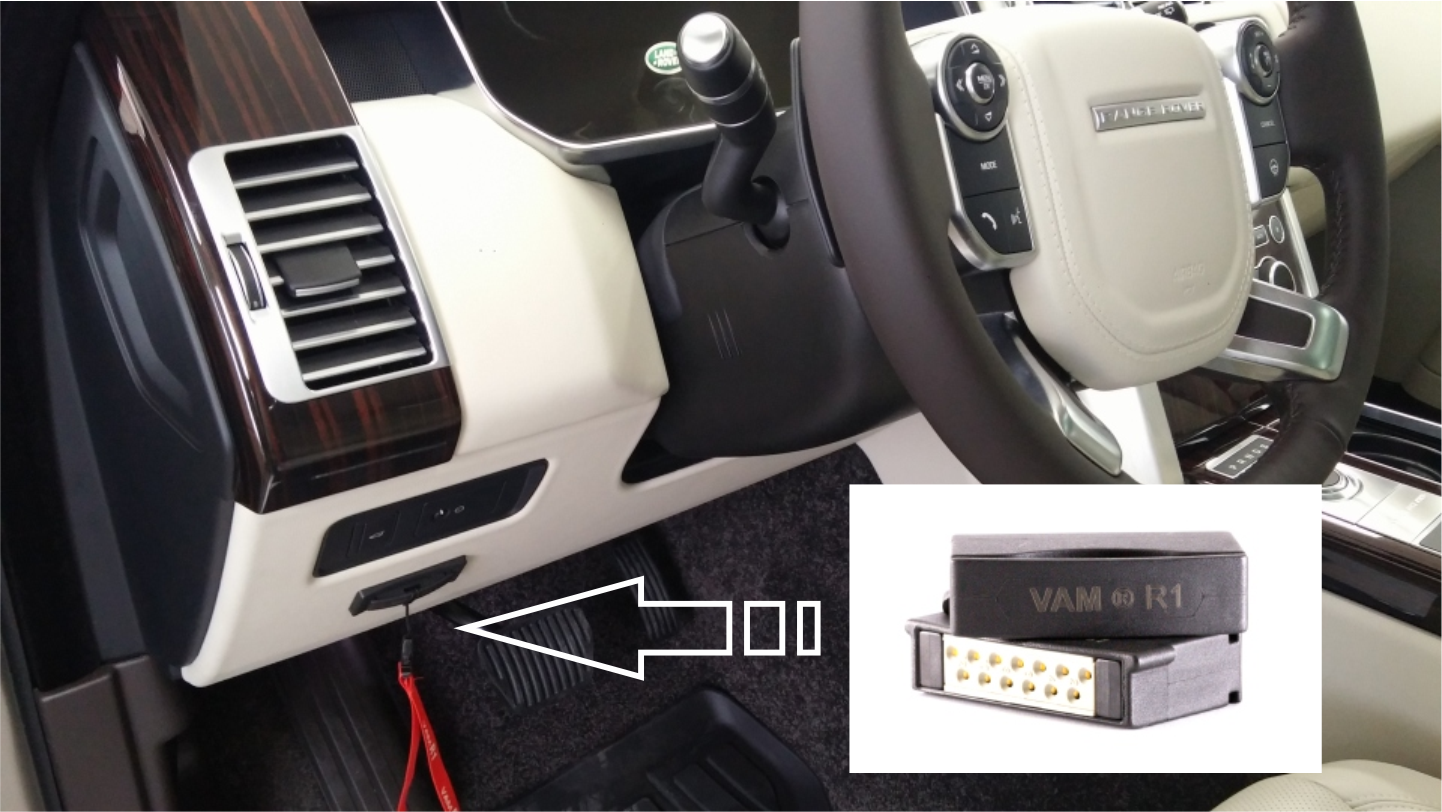

I own Octavia 3, 1.8tsi 6°DSG 4x4 with 50 000km. Previous owner had it chiptuned to 230hp and 320N.m. at 42 000km (without any modifications of DSG). I also have a security device that "cuts" the cables of various systems (among them also gearbox), leads them to a box and I have to put a cassette there to make the electrical circuit to be able to drive the car (see the pic).

My dealer did diagnostics, removed the mechatronic and checked the gearbox's oil for metal swarfs (no swarfs were there). They told me they couldn't run a proper diagnostics because of the security device I mentioned above (explained it that the electrical cables in current cars also plays a role of data cables and since they were cutted, probably prolonged to that box and soldered, it could affect the communication) but error codes that was obtained said: "erratic shifting" or "gearbox control unit without communication". Dealer also send the data to the HQ in Mlada Boleslav, but they figured out it was chiptunned and put their hands away and their only response was "whole gearbox replace".

4. That security device is causing the communication problems between gearbox and other systems and that makes it "confused" (probably the same way it could have affected the diagnostics). But I drove maybe 1000 miles since I had it installed without any problems.
