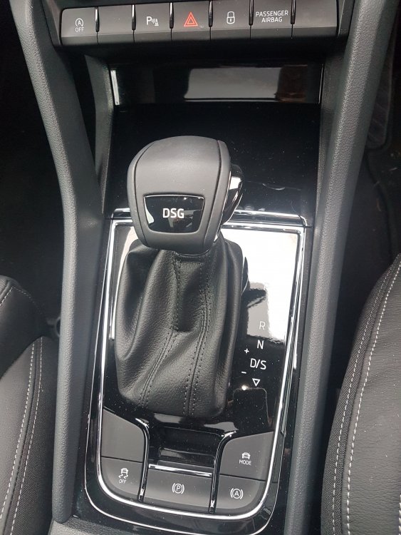

The autohold engages in traffic aswell. I know because I disabled it on the first day since it was becoming annoying. The disable button is near the gear shifter and once disabled it will remember this option for future drives. It will however still engage when stopping on an incline.
Well issue resolved. It was that button. I thought button was only for the start stop. But also does the Auto hold.

The startstop button is in a different place. It's on the same row with the hazard lights.
The auto hold and start/stop are two completely different buttons.

yep, two buttons, top left is stop start and bottom right is auto hold.
Huh, so for the uk they switched the buttons near the gear lever but the row with the hazard lights is the same. So for me, the startstop button is very easy to reach, hand on my knee and I can reach it with a finger. Easy to activate/deactivate at any given time. But for a uk driver that looks like quite a stretch.
