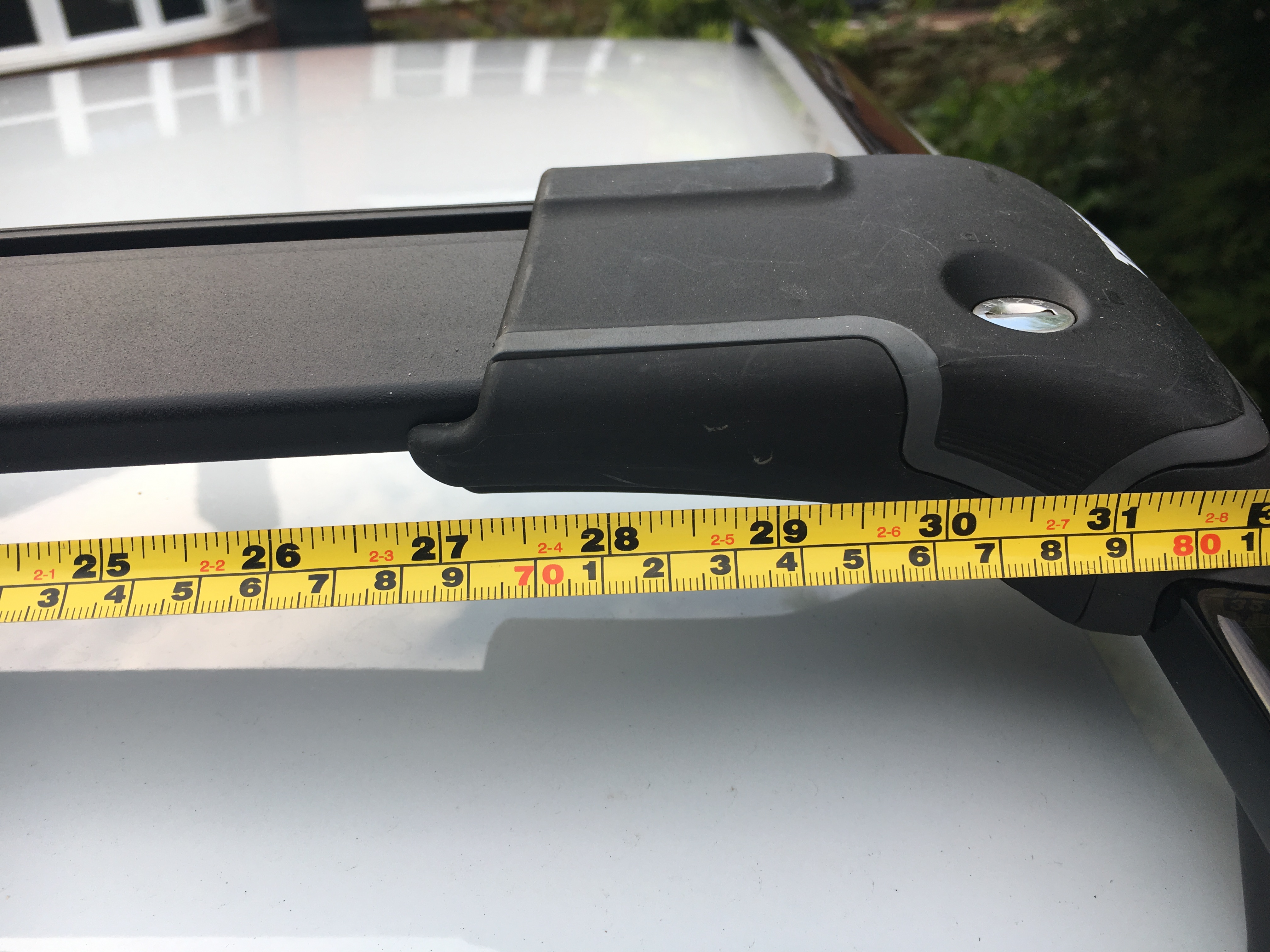

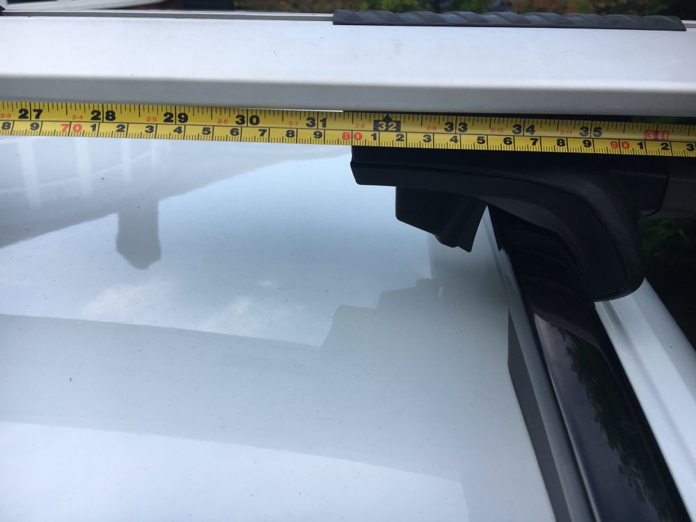

Guessing you have gone for the Estate version with roof rails, Thule Wingbar (Silver bar below) 961 with footpack 757 comes in at 80cm gap between the feet at the most rearward point of the roof rails. This combo fits over the roof rails.

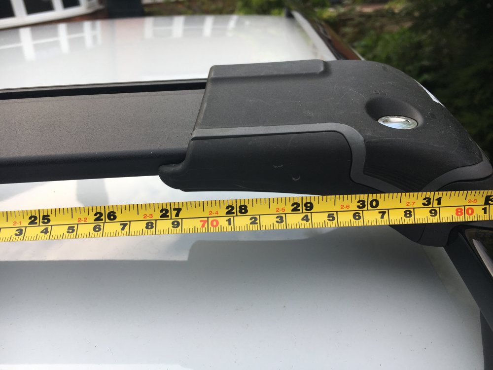

Thule Wingbar Edge (Black Bar Below) which fits near flush between the roof rails comes in at 68cm between the feet also at most rearward point.
In reality, there is a little more clearance than this as the bars are fitted about 10 cm forward the most rearward point.

Wow, thanks so much for this BigEjit :thumbup: . Obvs, the Wingbar is clearly the better choice, and clearance is just about enough for what I'd like.
I'll be mounting the box as far forward as possible as I'll be loading the bike rack on the towbar, some logic to balancing the car a bit applies. So any additional clearance gives more confidence.
