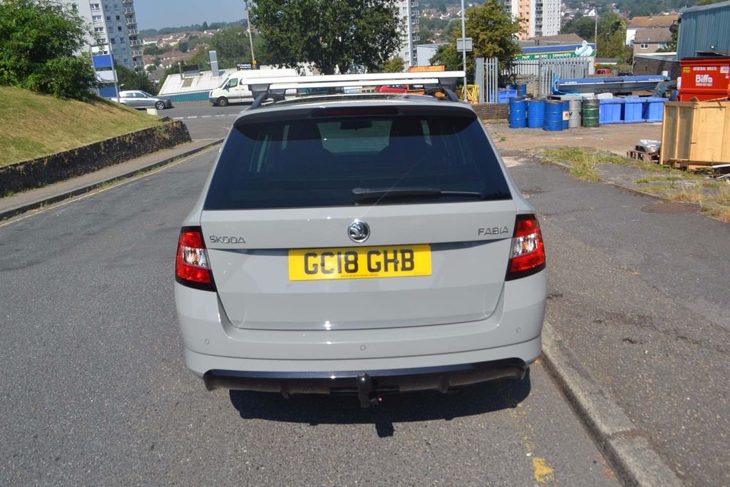

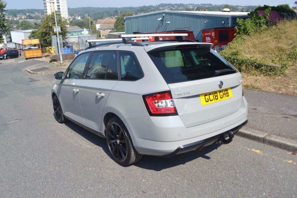

These aren't photos of my car but found them on Autotrader. Looks like a Skoda Genuine towbar fits and clears a Monte Carlo rear bumper.
That's a good sign then! And I'm guessing the hatchback and estate fabias are similar enough that they can both take the same towbars. Thank you @founts_d I'm still on the lookout and will post back if I manage to find some.
If you take a closer look at that photo, you can see there is a cut out in the bumper for the genuine tow bars.  This cut out is only on vehicles which were specified with a tow bar from the dealer and will probably come with a cover to hide the cutout when the tow bar is detached.
Unfortunately I haven't seen any tow bars which clear the bumper without a need for a cutout on Ebay so I'm not 100% sure
