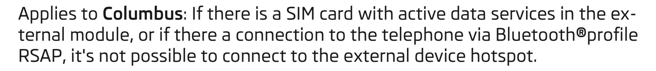

The only bit I’m unclear about is in the pic I’ve attached. Obviously I don’t have the SIM card slot so no worries about that, but does the other bit mean I can’t have my phone connected to Columbus via Bluetooth at all, whilst using it as a hotspot for the Columbus to connect to?62B39481-ACB2-48EB-A6F3-ED172B059377.thumb.jpeg.fcd75eb9ccfaab3b0d38e2d44f79537a.jpeg
That seems straightforward to me.
If you've connected your phone using bluetooth with rsap (columbus uses your phones sim remotely, and phone/data signal is handled by columbus directly using its own hardware and roof aerial) then you cant try to connect to your mobile phone hotspot or home wifi.
Common sense.

Look in the glovebox and at the DVD/CD head-unit. Does it have a SIM card slot because this was not standard until recently. If it does not have a SIM card slot between the two SD card slots then it cannot connect to and use a SIM in a phone over Bluetooth using the rSIM Bluetooth profile.
Edited by rtj70
correct - that is my understanding too.
rSAP will only work if u have the SIM version glovebox unit, assuming u have phone that is rSAP capable too.
not all phones can do the rSAP bluetooth profile.
Thanks both, understood. As I don’t have the SIM card slot I will have to use the mobile hotspot method. I’ll try it this morning and report back :thumbup:

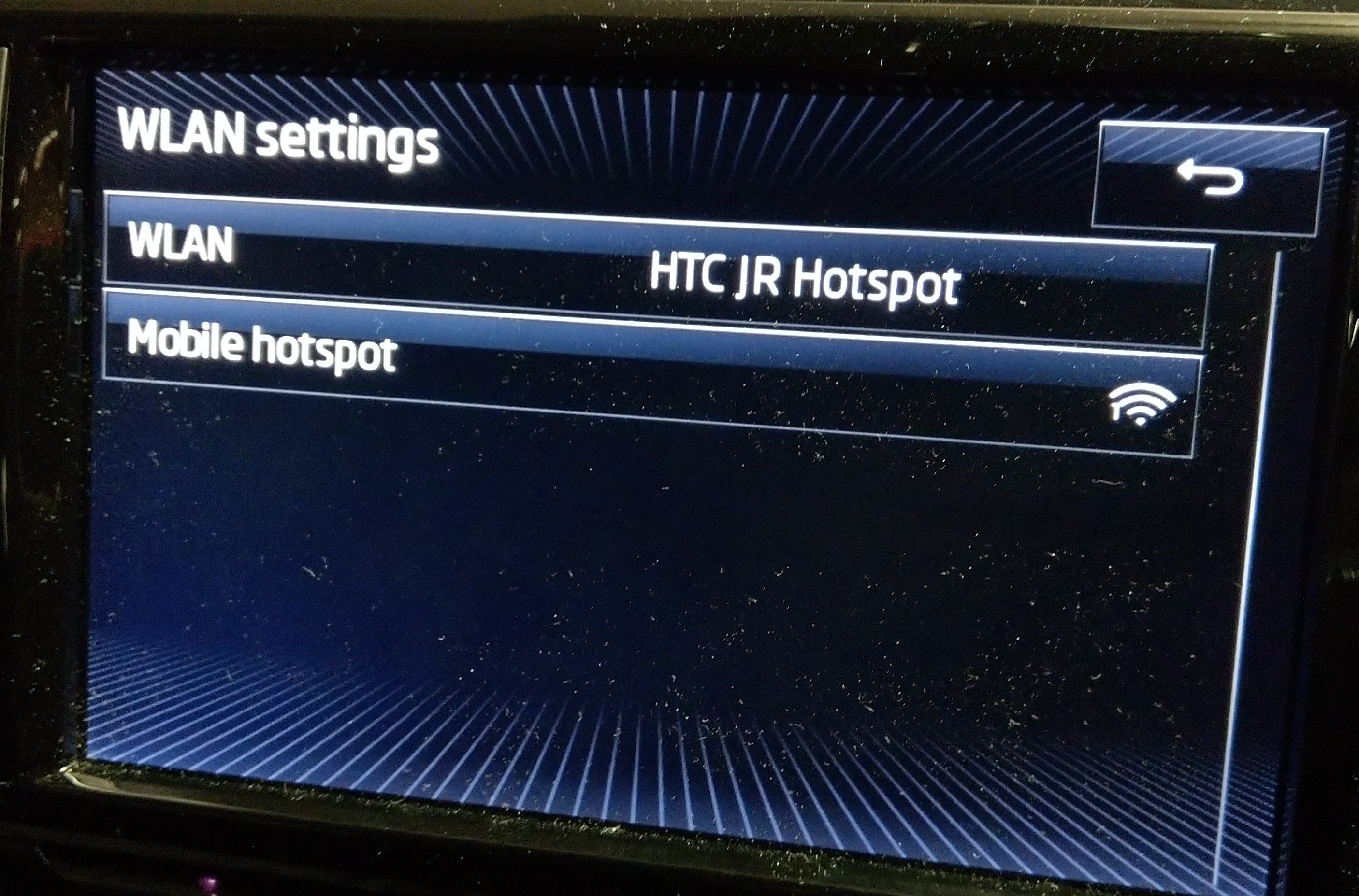

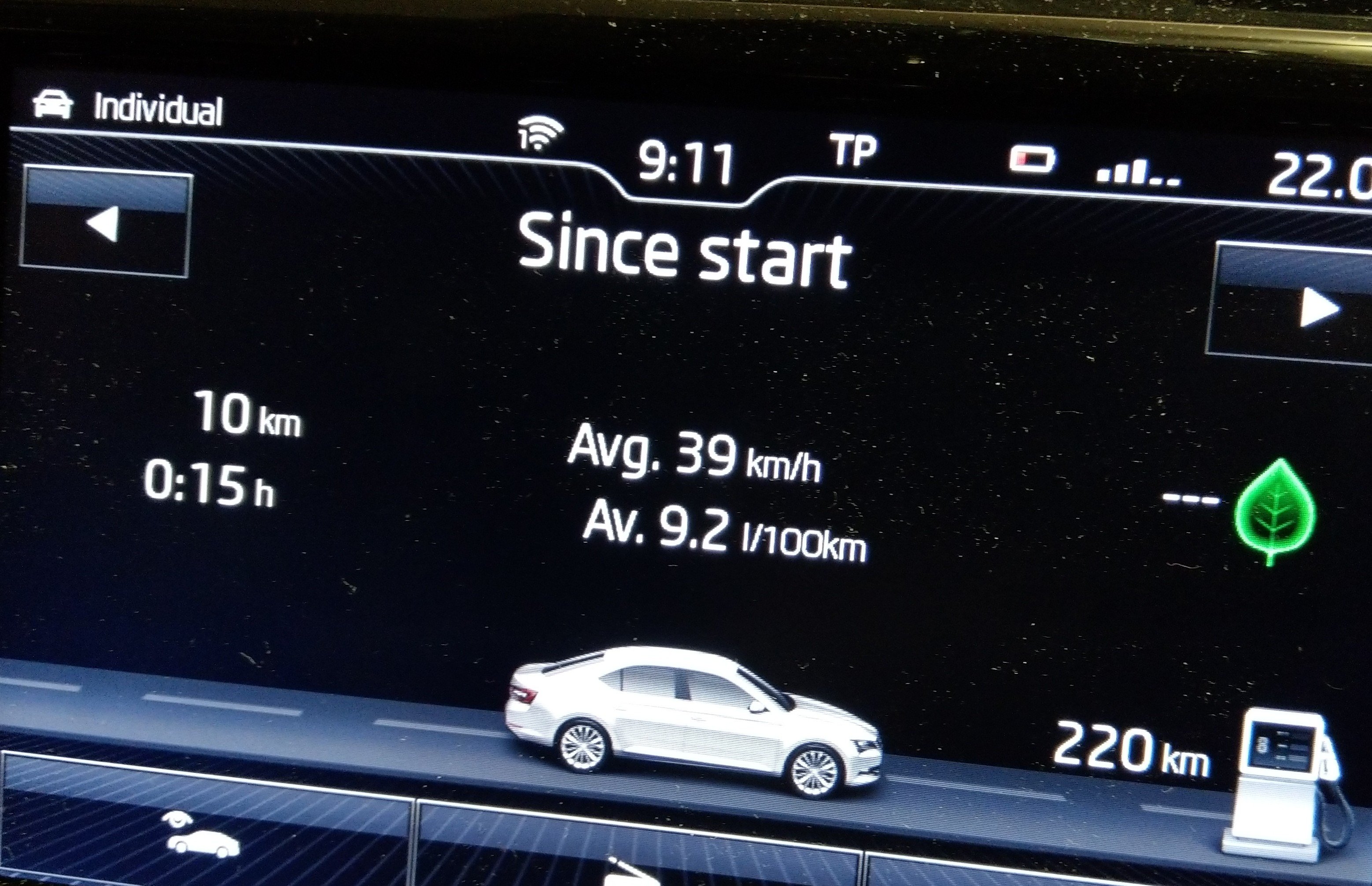

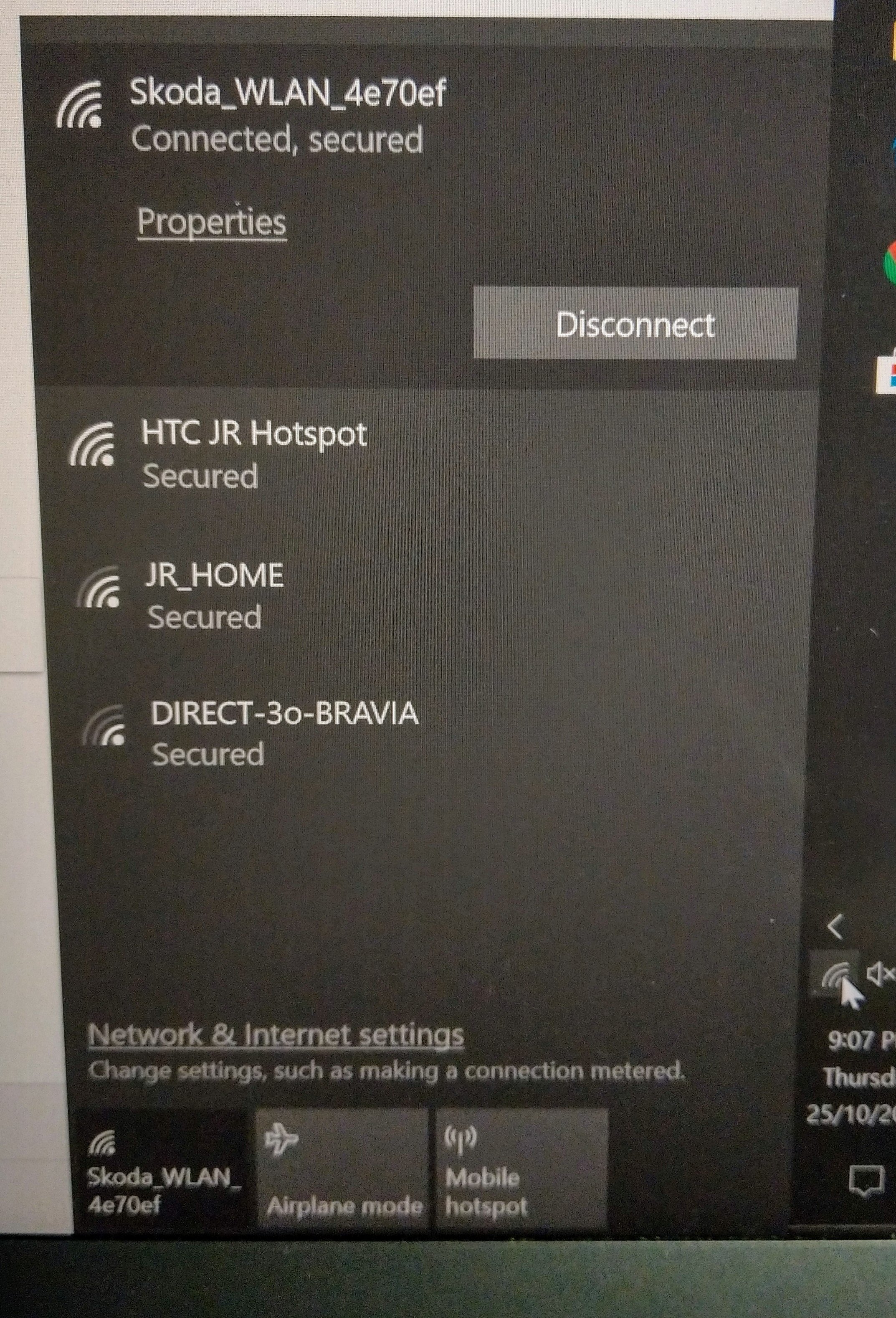

Columbus WLAN settings:-
- WLAN connected to my mobile's hotspot "HTC JR Hotspot"
- Columbus Mobile Hotspot = On
Tablet, connected to Columbus Hotspot "Skoda_WLAN_4e70ef"
Columbus showing there is one (1) connected mobile hotspot user on the wireless logo:-

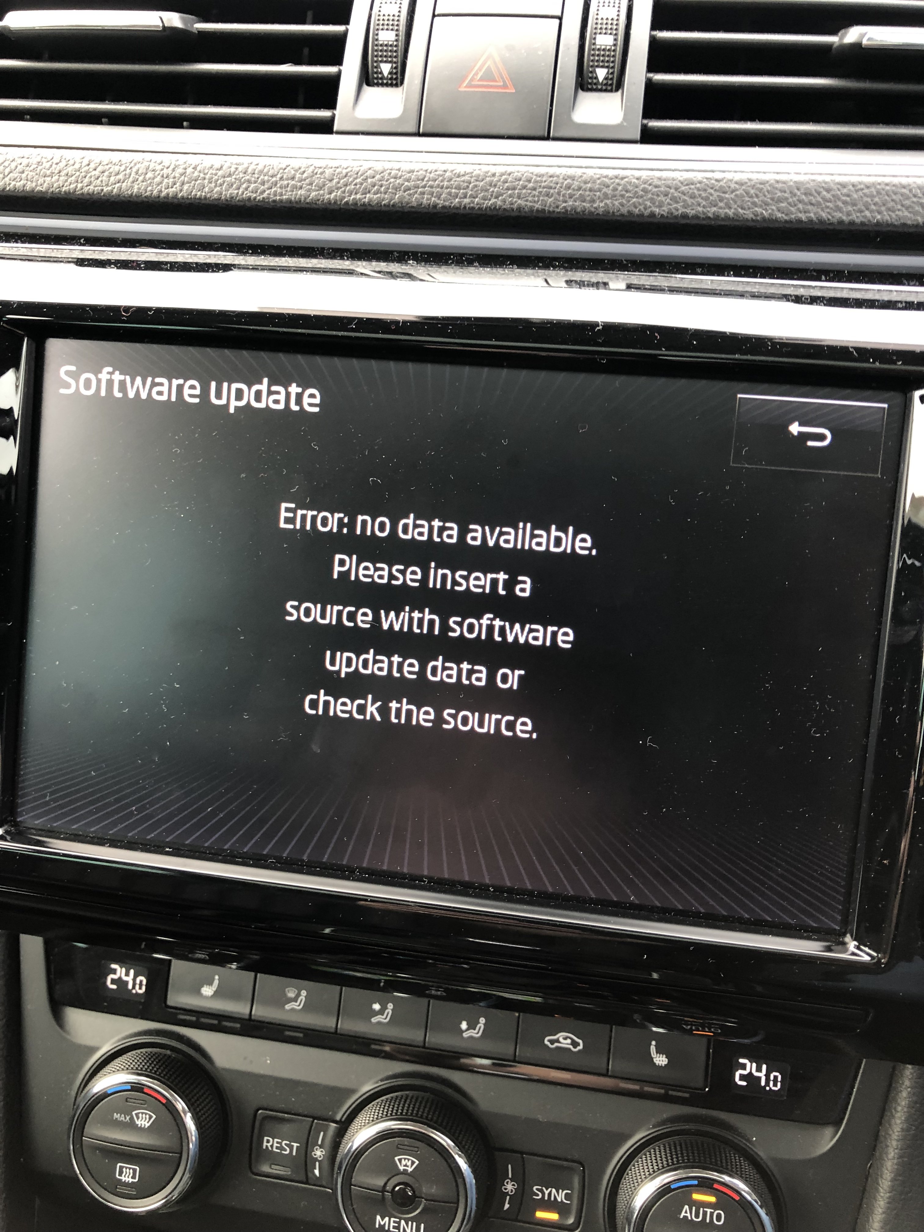

Well I tried it as per your tips and the instructions, and it doesn’t work. It must be faulty. I tried it both with my phones Bluetooth on and off. Also tried to update the system whilst it was connected to my phones hotspot
Same here. I had phone connected via cable. Columbus connected to my phone's WiFi hotspot. God knows what Columbus can do with my phone's internet as I also get the above message.
I then also created a WiFi Hotspot in Columbus and wifey was able to connect. But alas....her phone said "Connected, no internet".
Glad it’s not just me but it’s annoying because others on here who have no sim slot have got it to work

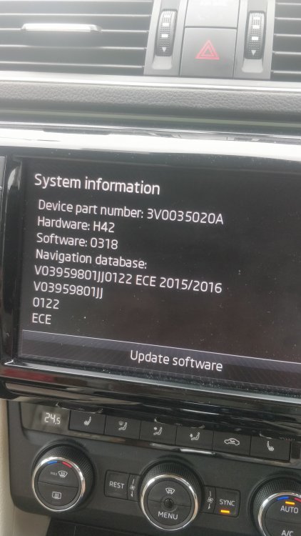

Isn’t this on the new infotainment system (2017 onwards)? Mine is an older model with the older Columbus system (see my pic above of screen)
edit: there are no options anywhere on my Columbus for any subscriptions or online services
