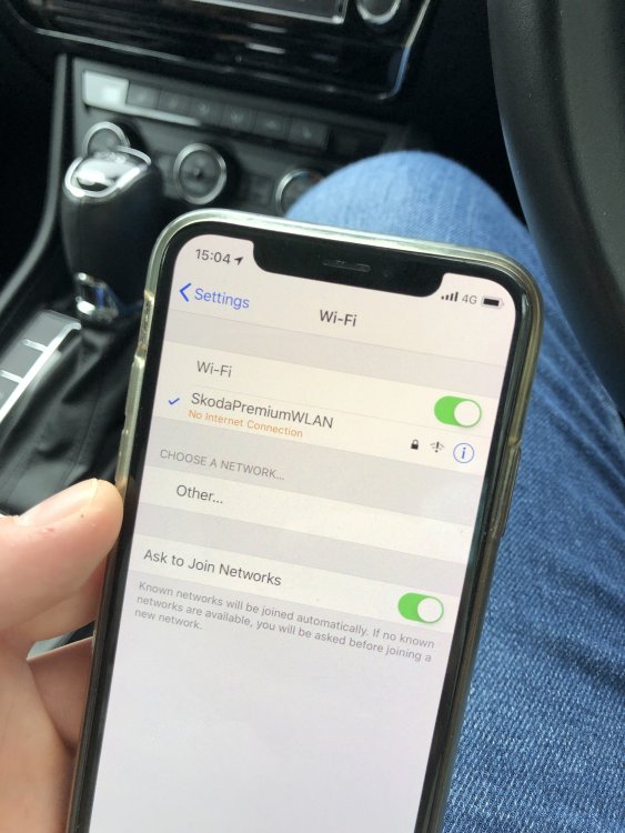

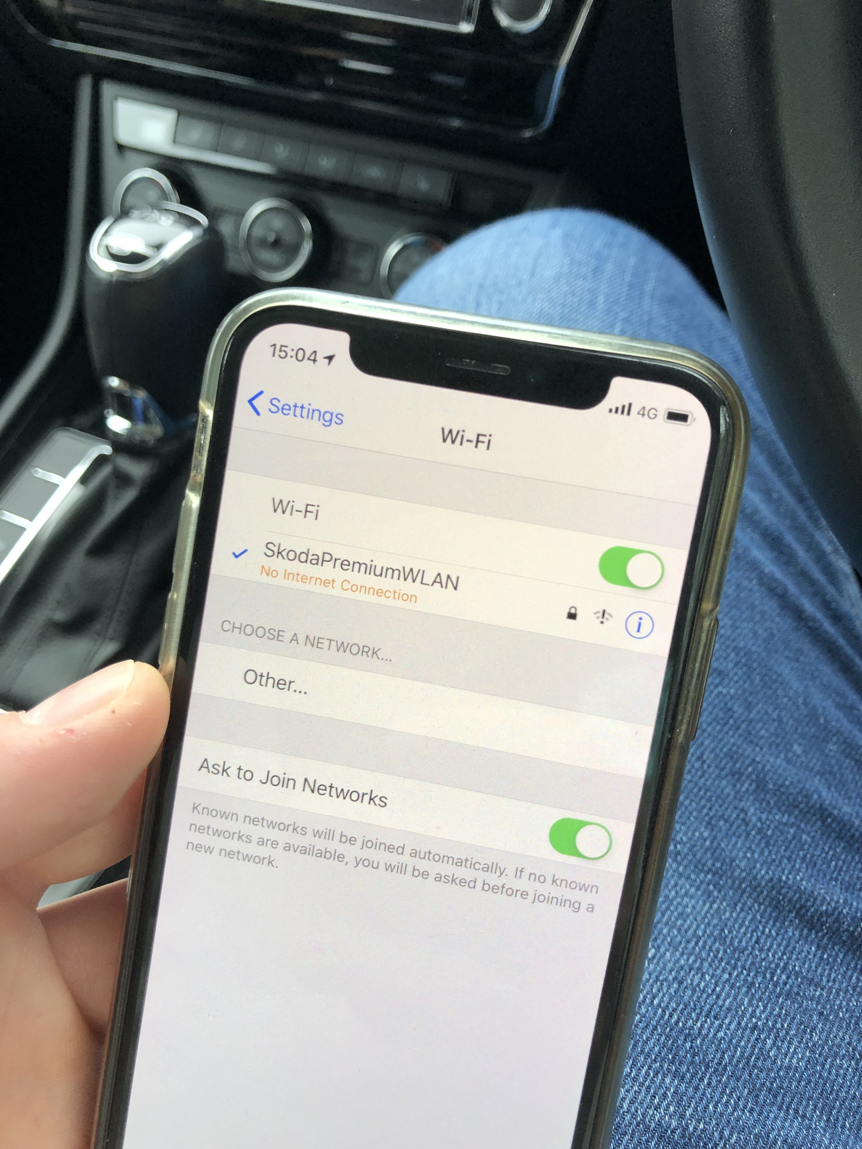

I’d be very interested to hear how you get on. I’ve tried exactly that procedure many times but no joy. Step 4 always fails, it just comes up with an error message like “no media inserted” or similar. Step 6 always fails, other handsets connect fine to the Columbus WiFi but they always say “no internet connection”
I took a photo of the result but ignore the misleading name of my Columbus WiFi hotspot lol..... I think the Premium WLAN is the one with a SIM card which I do NOT have, so I’ll have to rename it!
