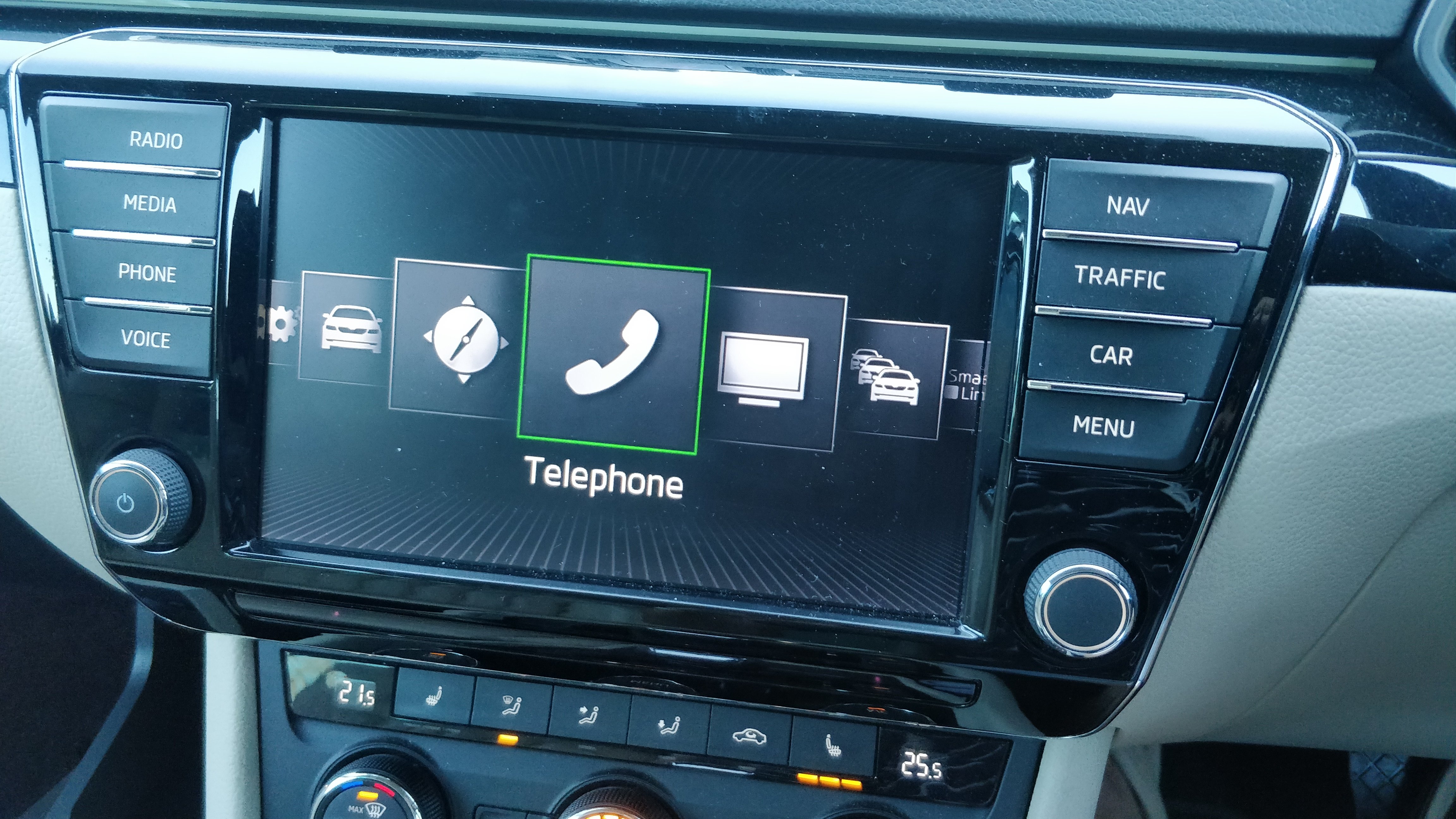

Cheers. I will check tomorrow. I have a 65plate MK3 superb ( L&K) with a unit which had physica roundl buttons for "volume" and "menu" and physical, actual buttons for all of the other options, exactly like in the first image posted above.
I will double check tomorrow and report back.

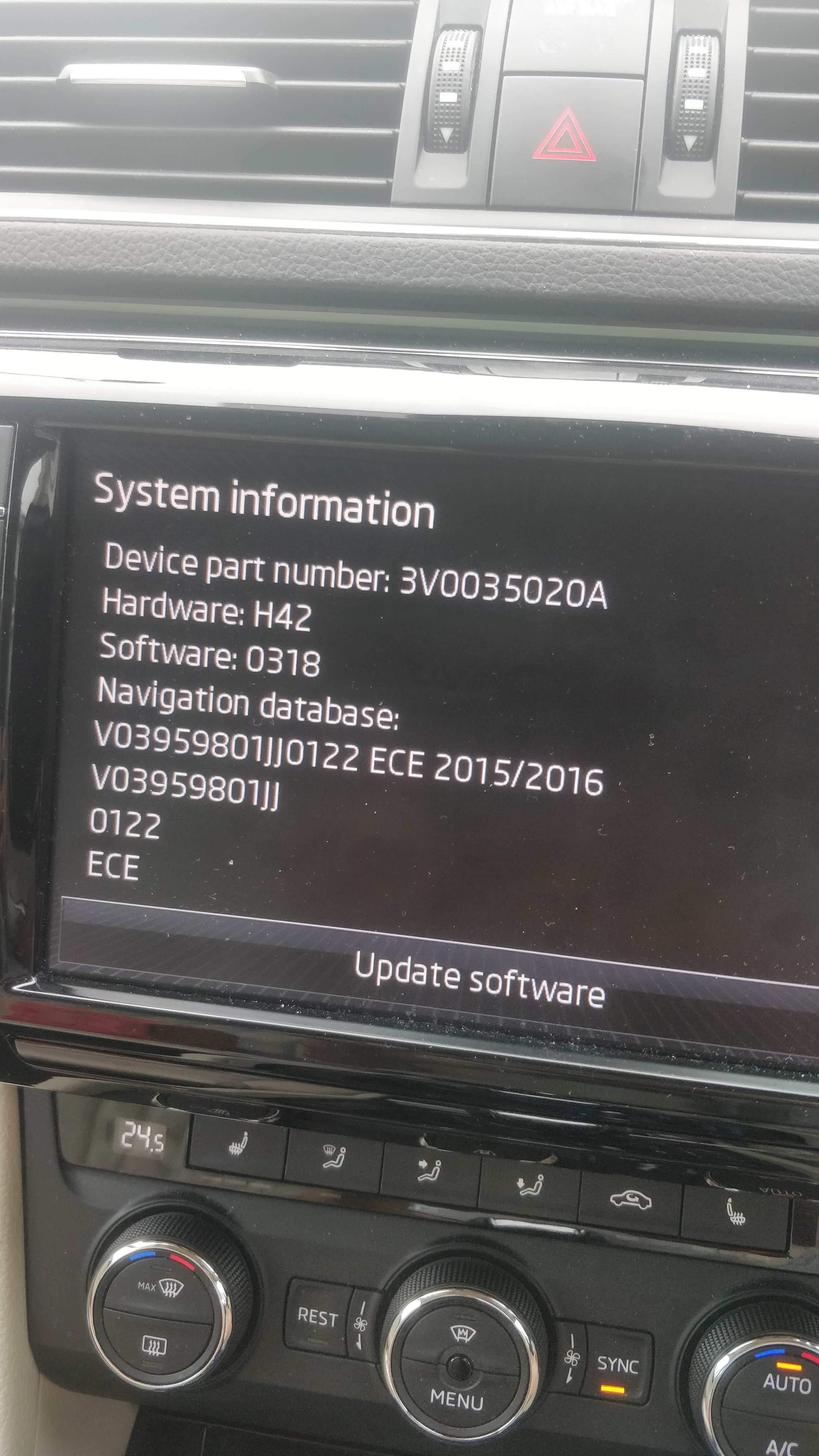

So I have a Columbus, but the Nav did seem too work without the SD card strangely. See attached. I'm assuming it is a Columbus?
Did work or didn't?
It should work fine without the SD card, yes that's a Columbus and the maps are on the built in HDD
Just now, drewellis said:
Did work or didn't?
It did work. I thought it was strange as I don't see the point of the official SD card I have then??? When exploring this, it only has a folder called "Maps" on it!!

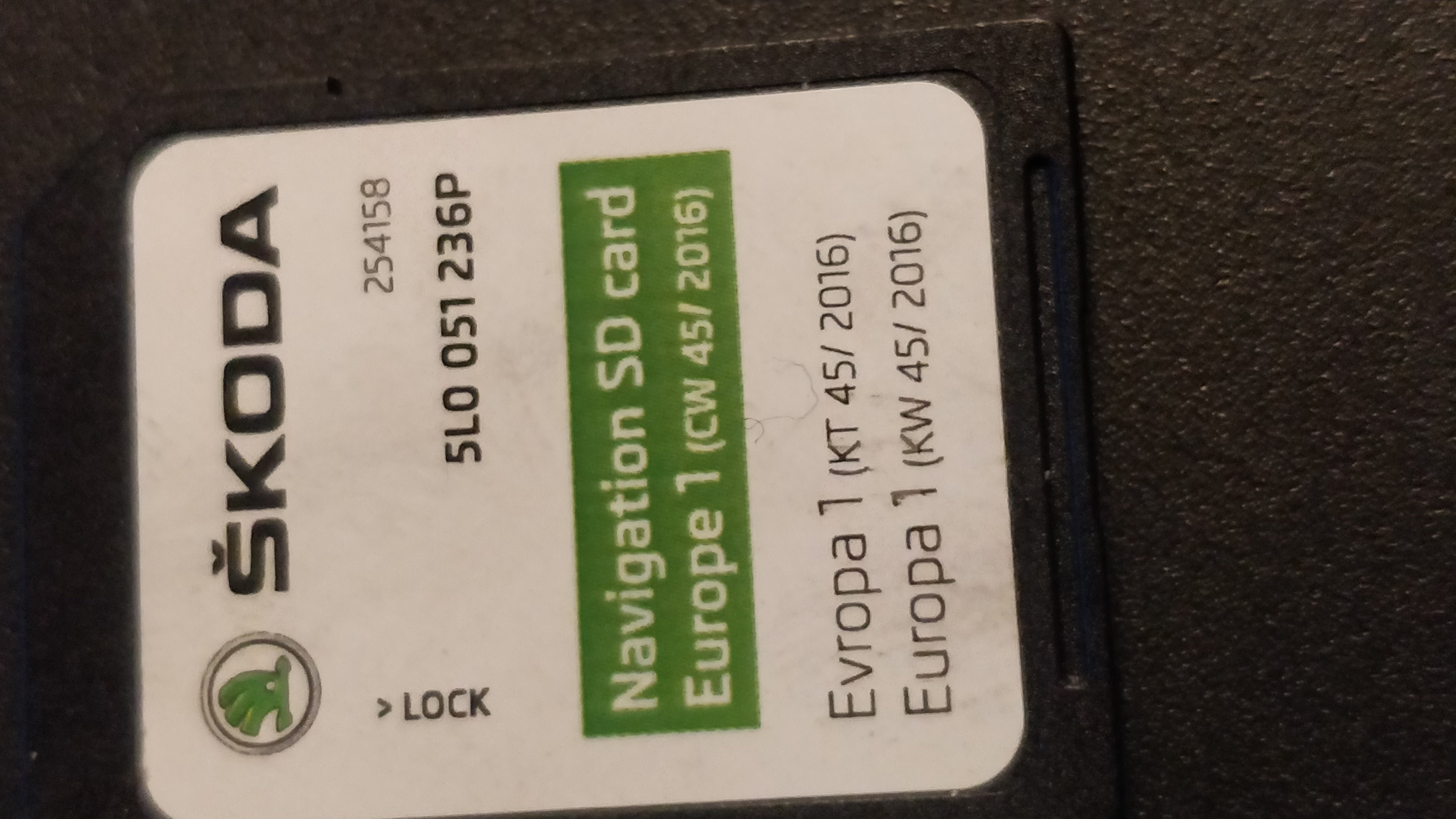

5L0 051 236P - is designed for the Amundsen units.
google it.
either they incorrectly put the sd-card in urs.
or
u do have an Amundsen unit, not a Columbus.   but u did say that the navigation worked without the card.
so that would indicate the 1st scenario.

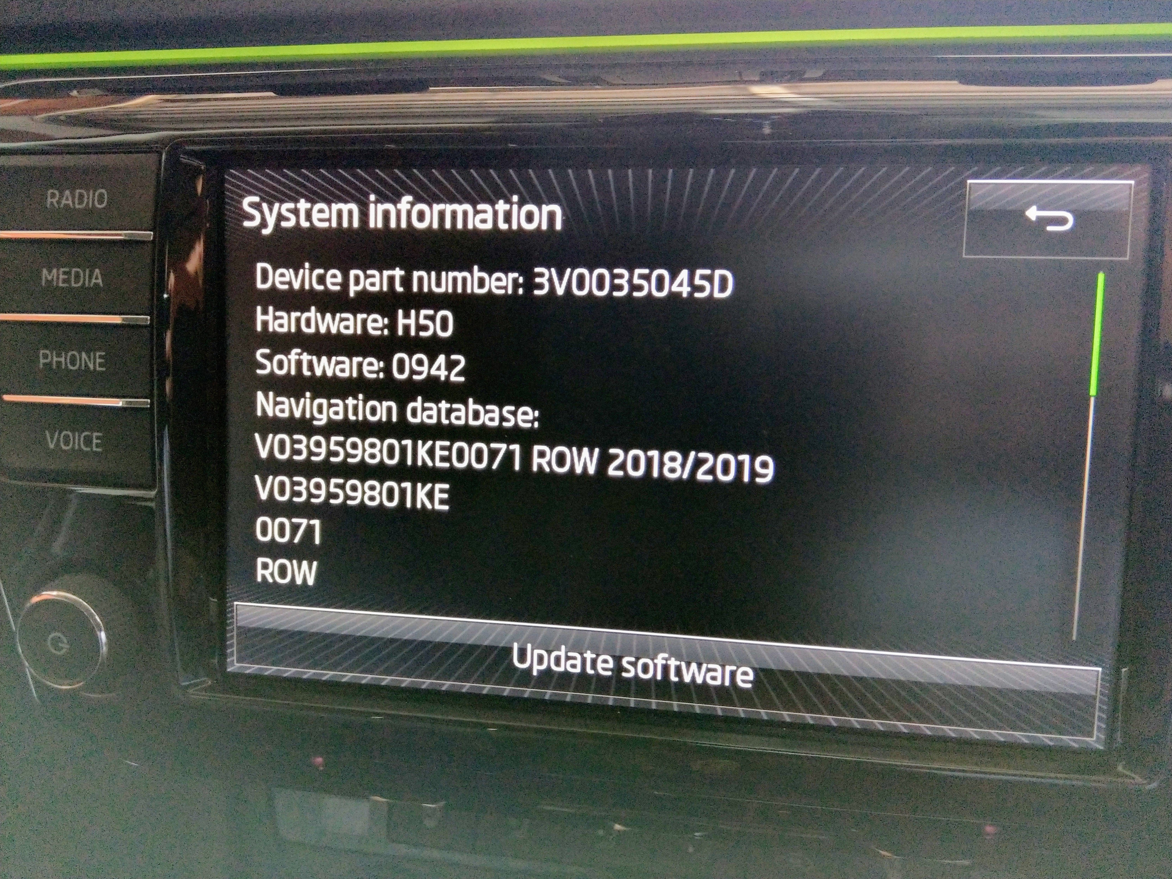

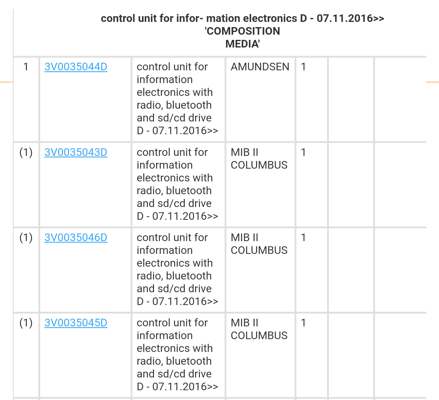

@syanide check in the system info to see the device part number.
My Columbus is 3V0035045D.
The Amundsen is 3V0035044D.
Edited by JR RS
Ha...mine is ...
Uuhhhh...this is mine... :giggle:
What's the bloody difference???? Aaargh. I'm a green person and need details so stuff like this bugs me. Yours is B and mine is A. Your hardware is H50 and mine is H42....

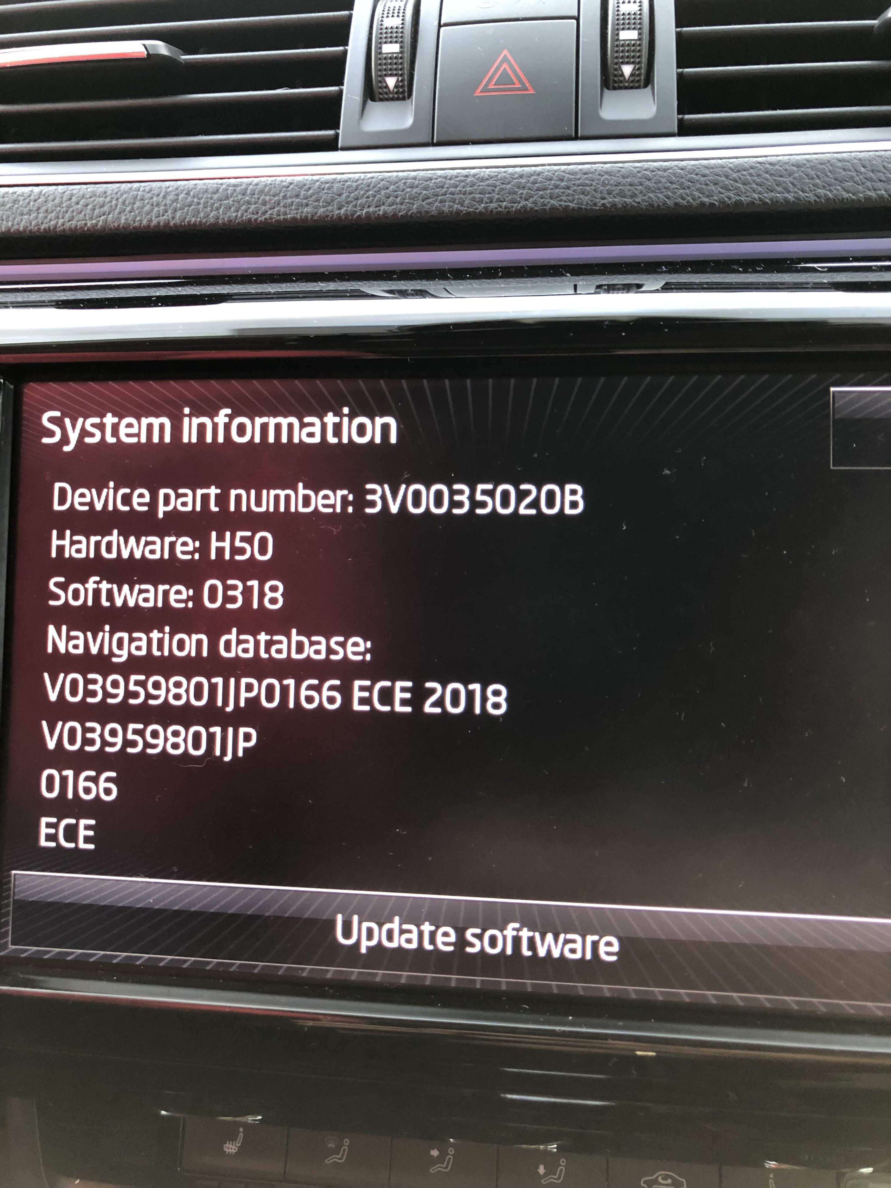

So mine is 3V0 035 020 B
It has Bluetooth, no SIM, DAB and TV Tuner. It also appears to have WiFi (but doesn’t work as per this thread)
