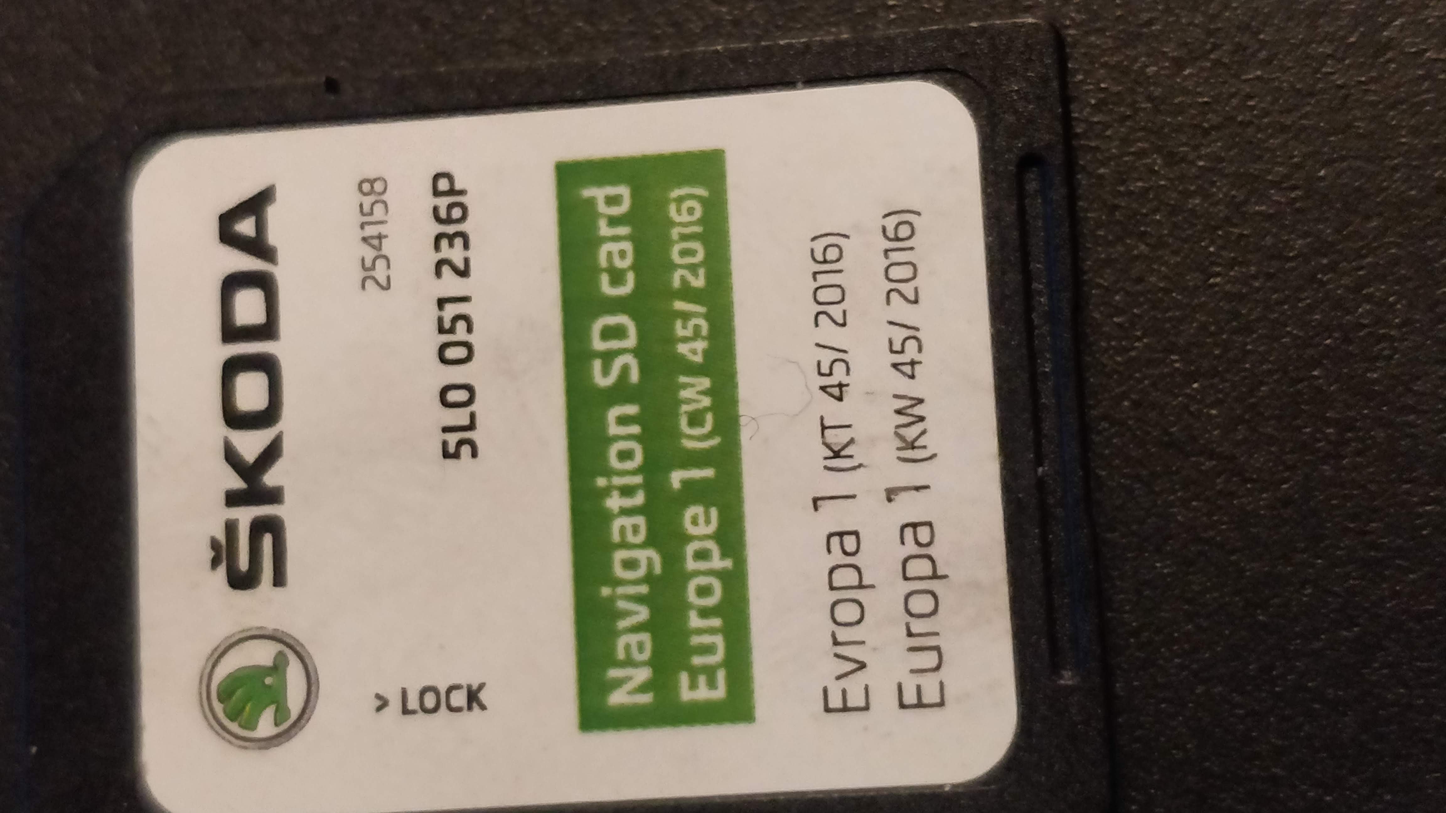

Ha ha....update tells me that the Maps downloads is 24GB, but the built in SD card is only 16GB in size!! Muppets!
Why are they muppets? The map data is 24GB so you need a 32GB card. Quite simple. Why blame them for you having a card that cannot hold all the maps. The Columbus unit does not use an SD card for maps. Where did the 16GB card come from?

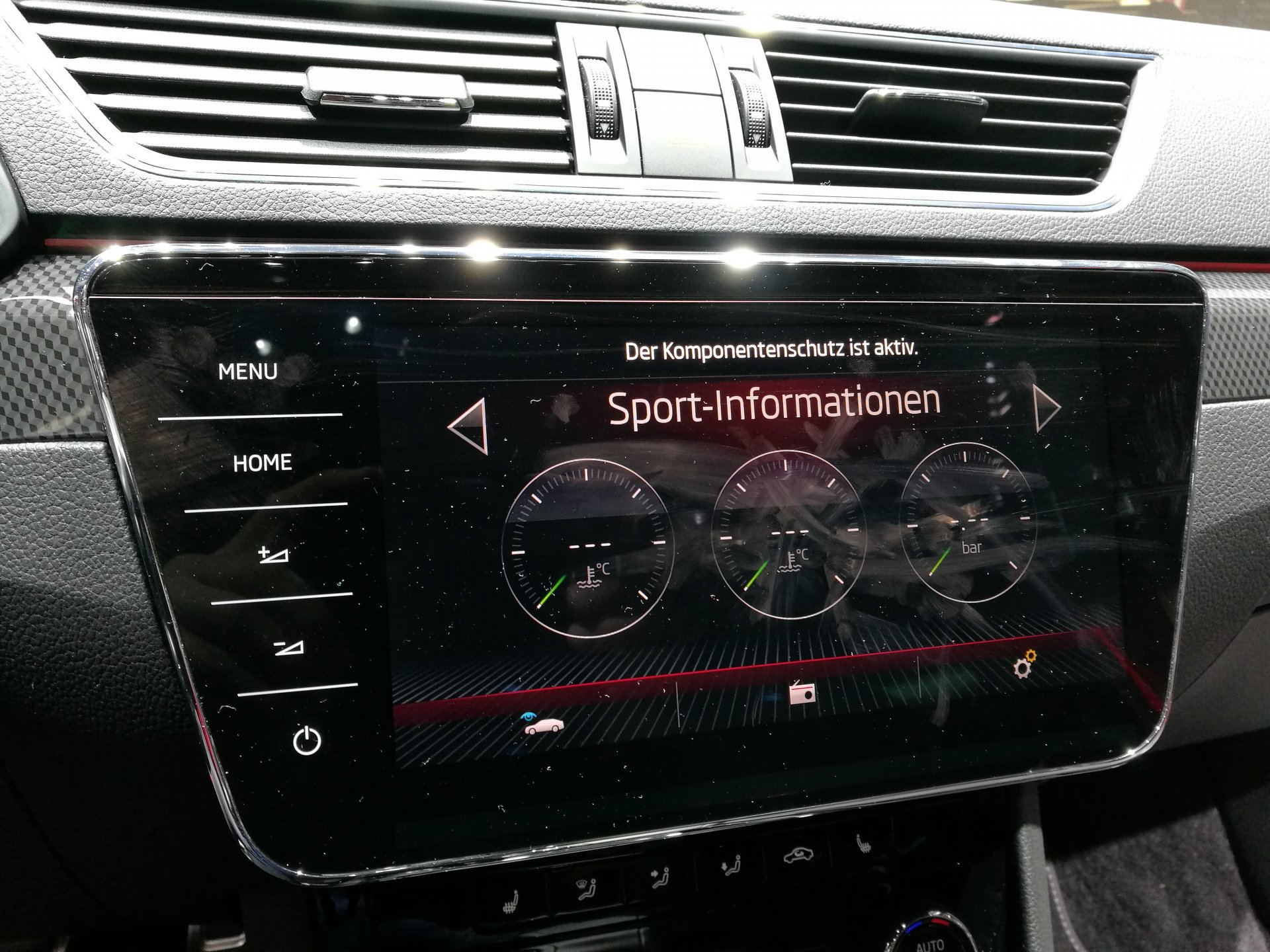

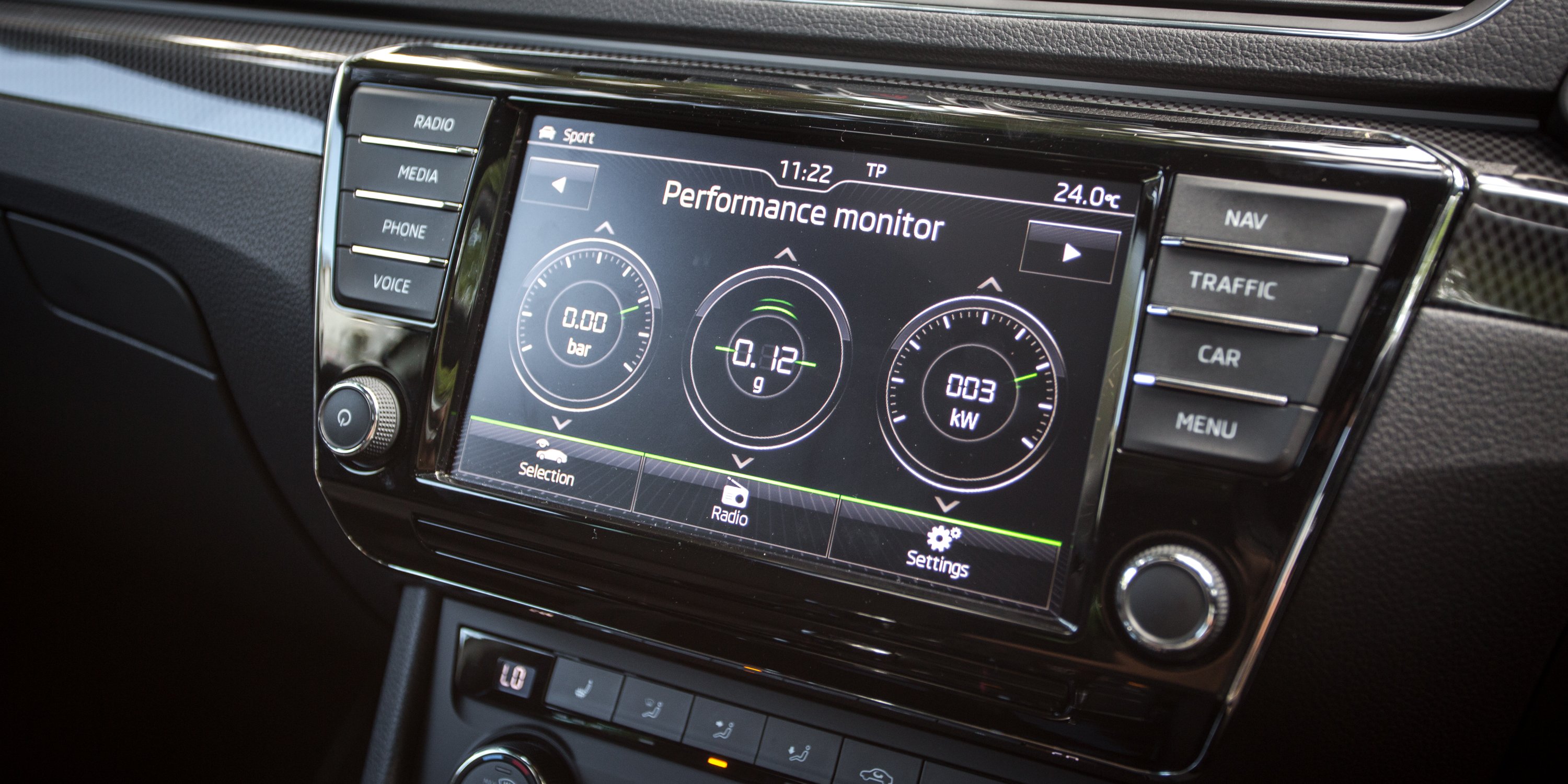

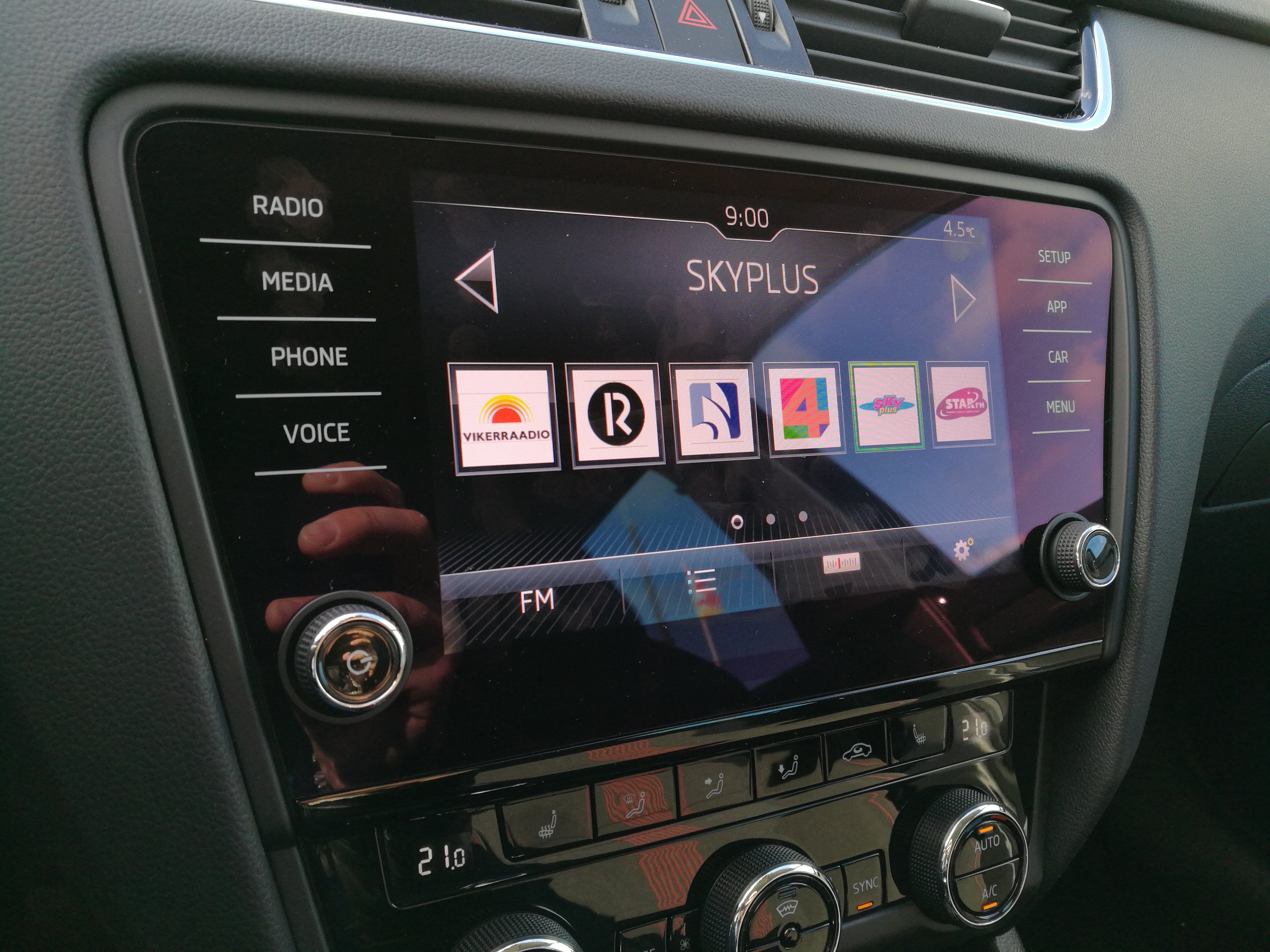

Yes that’s right the older one that I have has a smaller matt effect screen. Attached are photos of old vs new
Of course if you can connect to WiFi and have connected services licence then it can update over WiFi and downloads only the parts of the map that need updating.
The SD card that I have is the one that came with the car with the current maps already one. It's a Skoda banded "Skoda Navigation SD CARD".  Tats where Columbus gets its maps from. My point was, how an update can be double the size of what it is updating!
mine looks like the top one physically  -ie two knobs either side.
Yours could be the new Amundsen unit though, I’m pretty sure they fitted those to some of the newer car specs too:

nope, definitely the same as the top pic. Hard buttons all the way round.
The Columbus unit stores the maps internally on it's own flash storage. It does not use the SD Card. Believe me when I say you can remove it and sat nav will still work.
I'm happy to believe you, but that then begs the question as to what is on the SD card that apparently came with the car and has only one folder on it, called "Maps". I'll try tomorrow without the SD card - but it would be interesting to see why this SD card exists.
+1
Columbus does not use the sdcard for navigation.
It only uses it for updating the Maps.
I suspect @syanide has the older Amunsden, which uses the navigation card like he showed.
