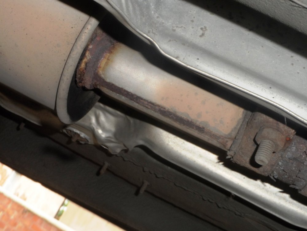

I managed to get a photo of where I think the problem is though.

That's just the sleeve clamp joining front to middle pipes which has rotted through? Or do you mean that area right up next to the box?
Had to replace the clamp on ours last weekend funnily enough. Got one on Amazon Prime, ordered Sat morning delivered just after lunch on Sunday. Will give you a link shortly. https://www.amazon.co.uk/gp/product/B00CJO8U3Y/ref=oh_aui_detailpage_o01_s00?ie=UTF8&psc=1

Thanks for the link, the clamp does look a bit rusty but it is the area right next to the box where the leak is.
I am going to see if it could be welded, or if it is worth it if not, will be getting some more prices for replacement.

You'll definitely be needing a new sleeve clamp to go with it, the one in your photo is no way re-usable.
