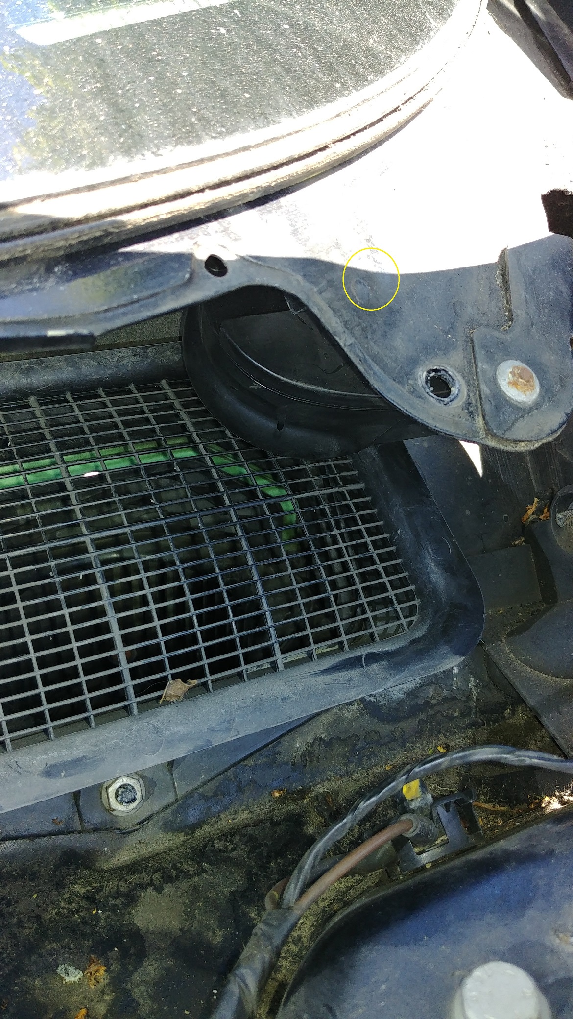

For anyone else who may need to do this, the siren is in the back right corner of the engine bay (looking from the front of the car) almost next to the bonnet hinge and is a fairly simple swapout once you know where it is :)
 You have to remove the wiper and plastic surround, then the plenum cover and in the back corner (circled) is where the siren is bolted underneath
Close up showing the back of the siren just poking out. Circled is where it is attached with a ½" bolt (directly underneath), you can get a spanner in here to loosen, then it will slide off to the right or you can undo the bolt fully and drop it out
