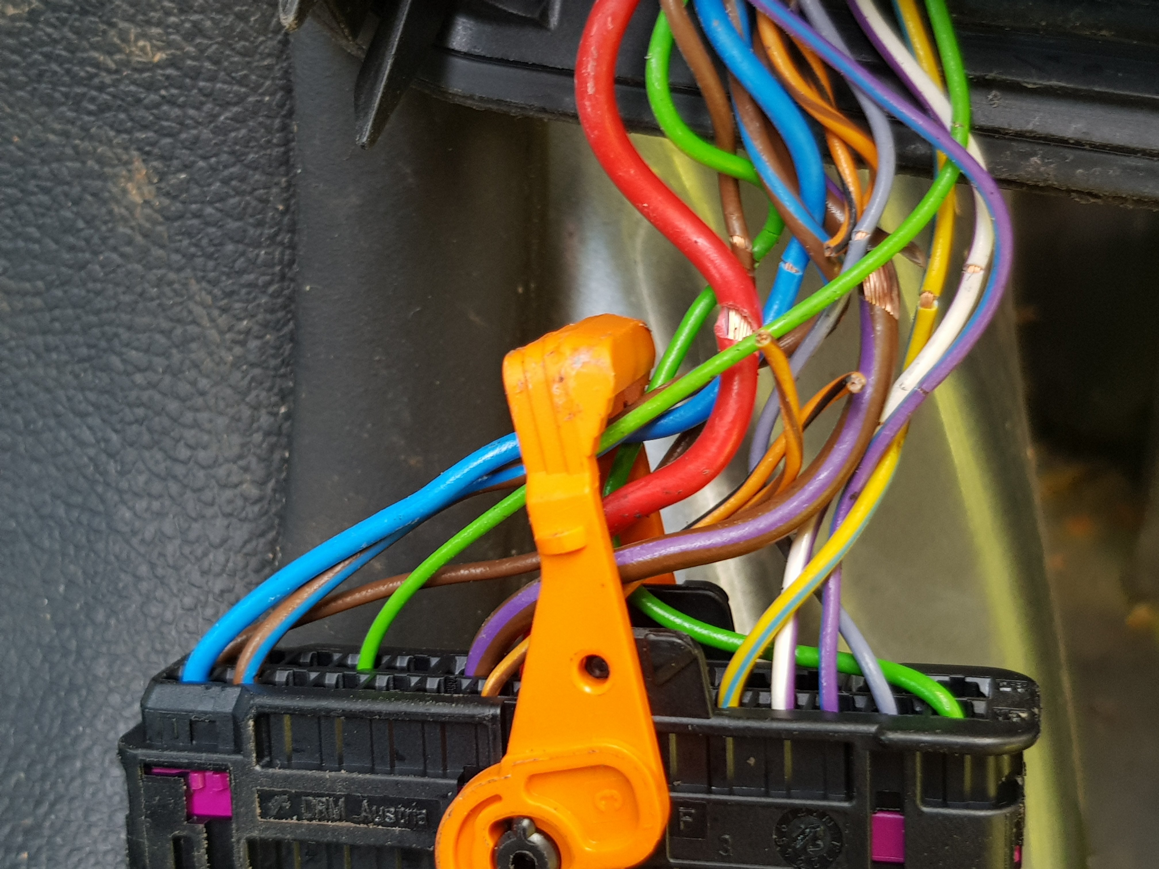

Or try this.....
A common fault on the Superb is a failure of the wiring loom as it passes from the inside the front wing , between the drivers door hinges and into the inner section of the door.
There is a rubber boot / gator that protects the wires.
Depending on the age and mileage of the car the wires inside become brittle and break.
It is a relatively simple job to open the rubber boot up and to check the condition of the wires.
Although this fault does usually reveal itself in other ways, including the door not locking and a lack of switch illumination etc.
First prize Silver, the loom had failed in the snorkel between the body and door, completely coincidental with the service.

I've just had this on a 2013 Superb with c120k on the clock.
Virtually all the wires were showing conductor but the only two to break were the twisted pair.
The were noticeably shorter than the rest - maybe because of twisting?
I was able to get the plug off the door lock by releasing the fixing bolts and letting it hang down and push back enabling a screwdriver to release the locking tab.
Loom is £108 + vat but as TPS not running counters had to get a local garage to order it and gave them £10 for their effort.
A real design fault I'm afraid.
It would seem that failure is at about this mileage regardless of model.

After replacing the loom I now have a completely clear VCDS scan.
In the 2 years I've had the car its had a canbus fault saying only one wire working - so one of the twisted pair must have been gone for ages and the second going is what finally did for 'everything' on the driver's side.
I'm amazed that it's just these tiny wires that allow the whole door ECU to work.
