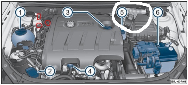

another question is the white metal part in the circle, what is that? i can feel it a little bit loose, would that be the problem.

The metal thing is your ecu

I have had something like that in the girls petrol fabia.
I found the noice from about the upper red circle. Was cables/wires scratchings against the body of the car.
