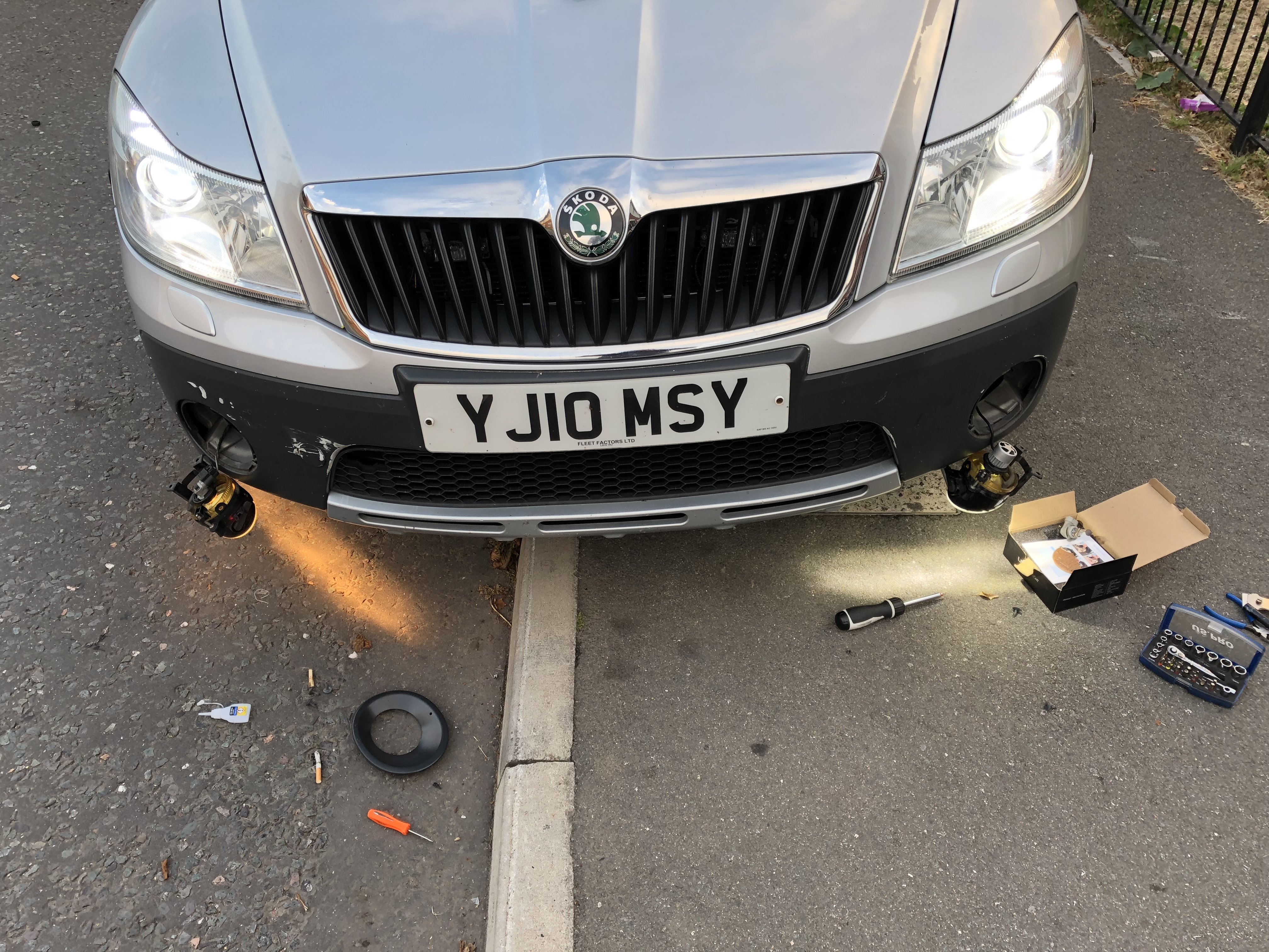

Hi guys, sorry for the late reply, I opted for the H4B (9006) LED option and I must say they are quite good.. only thing I noticed was that the seal ring part of the body isn’t quite as wide as the original  BUT it does seal and hasn’t let any water in or steamed up.
You can tell the difference on this pic, the driver side is original bulb and passenger is the new LED version. You have to look at the floor for the “beam line” as I didn’t think and
left foglights pointing down for the photo.
