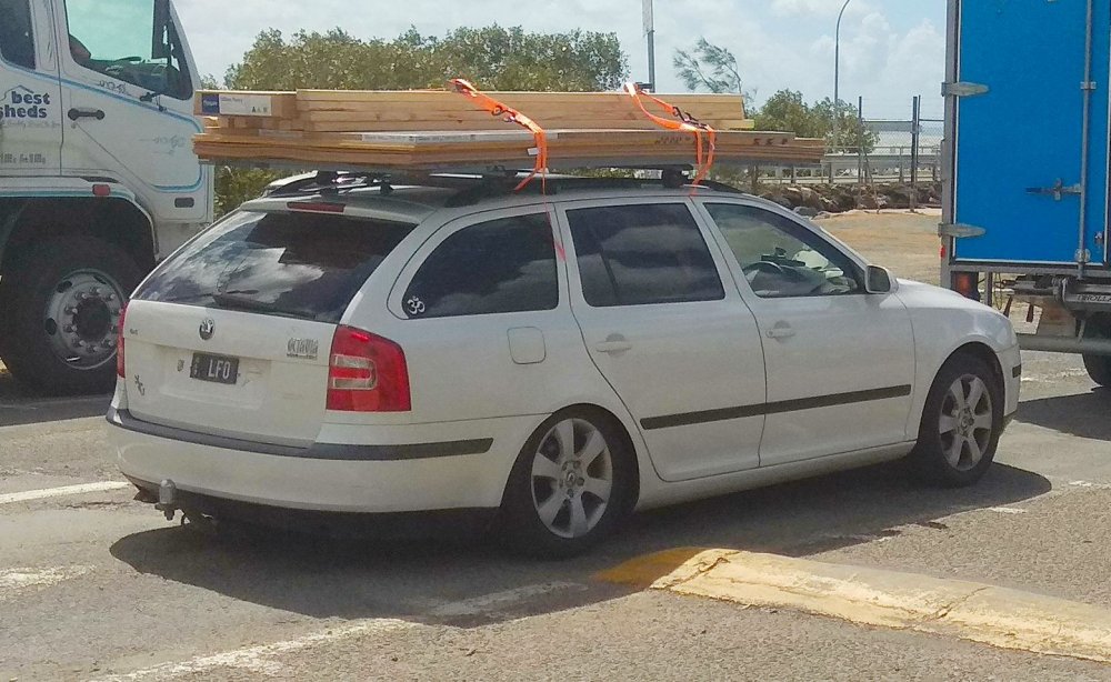

Wow, is that on the bump stops!?
had a kitchen flatpacked in the boot and bamboo worktops and plywood on the roof . ( the joys of living on an island with no bridge :)  , if it fits in the car or on it , its legit :biggrin: )
Hiding between trucks !

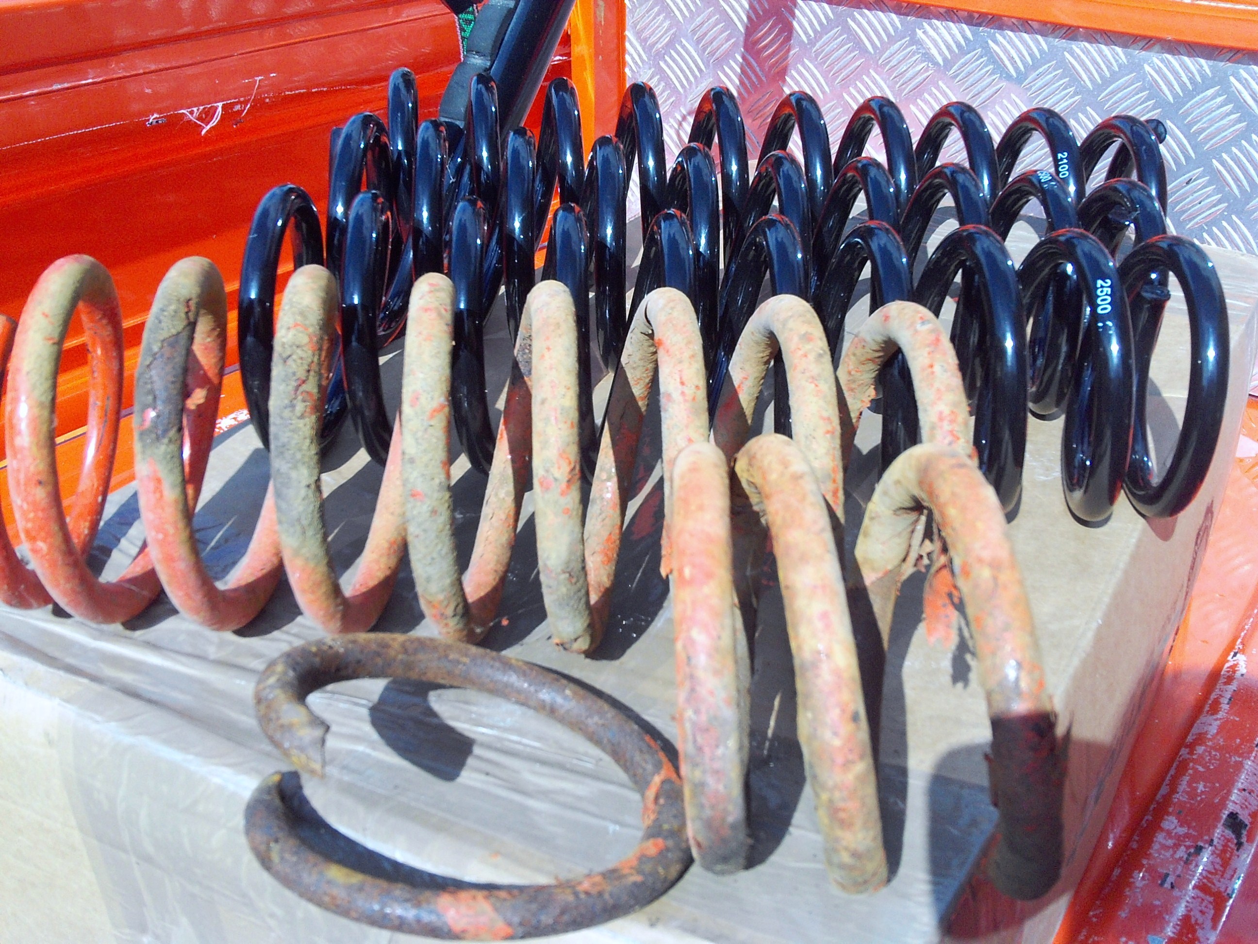

Oh and since new, the rear suspension has been woefully soft in the bum (its exceptionally annoying) , i have some firmer shocks to try off a VW Golf , i believe they should fit. The replacement shocks and springs were free, so worth a try :)

I just had the wheels off the back end of my car, one bump stop was disintegrated , i have ordered a pair of new ones and some cheap spring helpers as the rear has always been really far to soft from new, i guess they just used VW Golf springs not allowing for the extra length of the car.

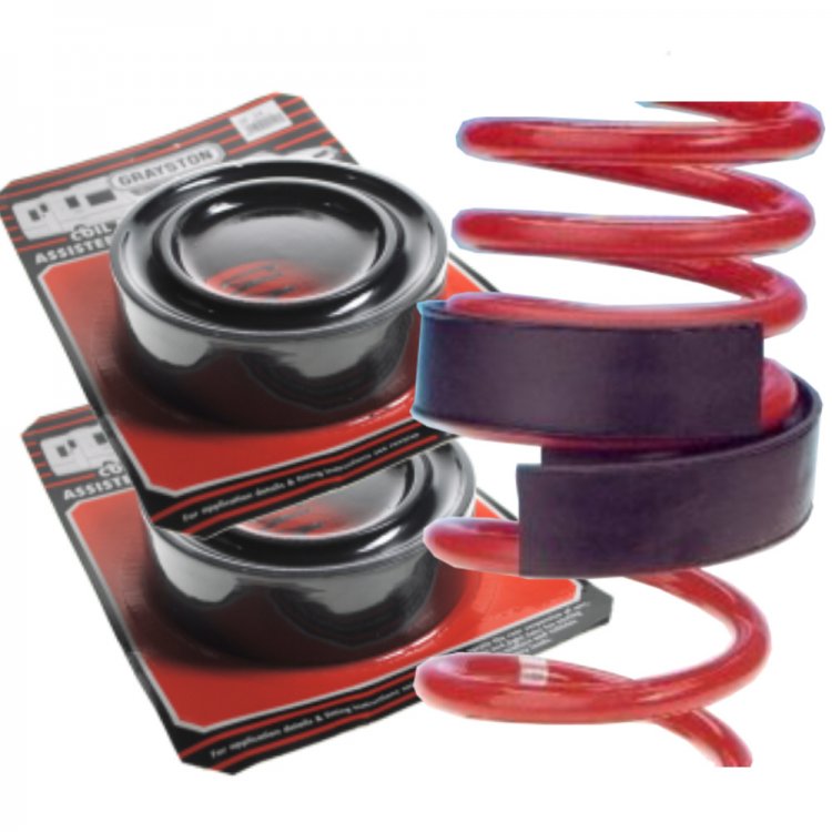

Heres the link for the spring helpers
https://www.ebay.com.au/itm/2Pcs-Type-C-Car-Auto-Shock-Absorber-Spring-Bumper-Power-Cushion-Buffer-131mm/323012685981
They do the job.
Over the years i have used Grayston spring assisters on various vehicles.

In the UK the Grayson Spring Assisters are just £10-£20.
As to the Estates rear springs, they are a different poundage from a Hatch or Golf Hatch, even when they estate or hatch has the same Max Gross Carrying capacity.

I did find these and saved the link https://www.ebay.com.au/itm/GRAYSTON-COIL-SPRING-ASSISTERS-RAISERS-26-38mm-Gap-Pair-2-GE14-Towing/263461696023
Are these the thickness you use generally ?.

Sorry no idea what you need, i use them on offroaders with long challenge springs when i want to stiffen them up for road use and put on 2 on each spring.
I just pick them up at my Local Motor Factor.
