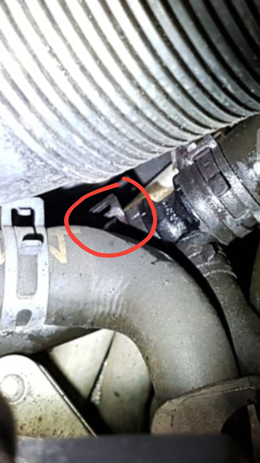

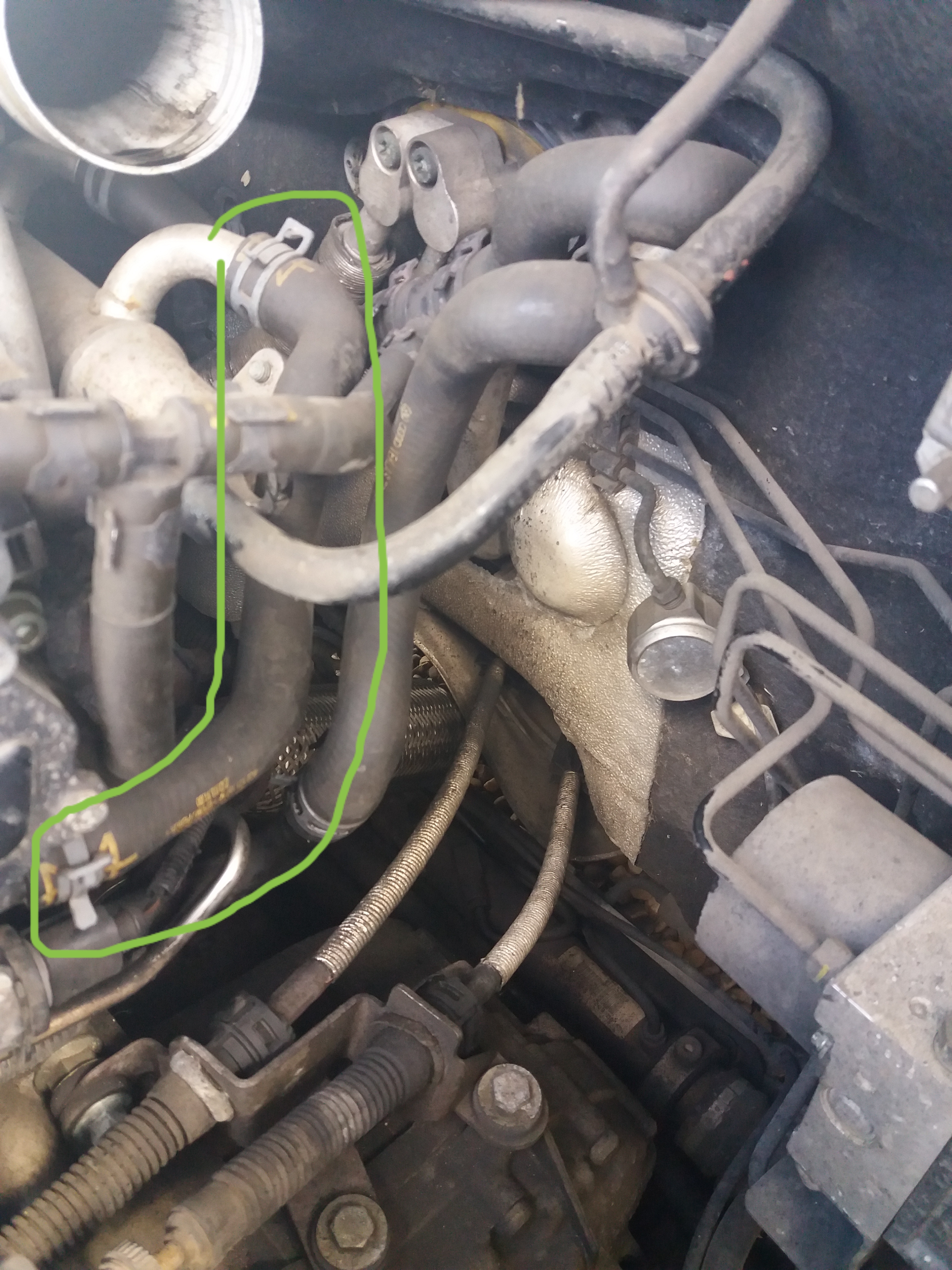

Check this pipe.
I have been searching for a leak on mine for months! It had a worse drink problem than my mother in law.
Threw the towel in got a local garage to pressure test the system for leaks
Found that the pipe highlighted had been rubbing on pipe connectors directly beneath it. Made to small puncture marks like a snake bite
Just under £10 from tps and all is good
