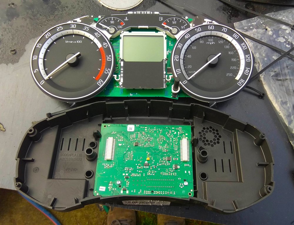

Hi,
I have a 2008 Skoda Ocavia 2.0TDi BMM engine and have bought the clocks/display and ECU(with key) from a VRS TDi also BMM engine
Everything looks ok , but the dashes are quite different . I have opened up the VRS one to see if i can pop my Km one in to rectify the issue.
Now the question is Is the Immobilizer chip in the display in the small circuit board at the back of the display , and secondly , Does this mean i can drop my existing Fascia into this cradle and expect the dash to work as it did before when i swap out the ECU and key fob chip.
Looking at VCDS if the above cannibalism works ok i can get the digital part too read in Km and litres per 100km etc, I just dont want to do the above mod then find i blow it up :(
Photos attached
Many Thanks
