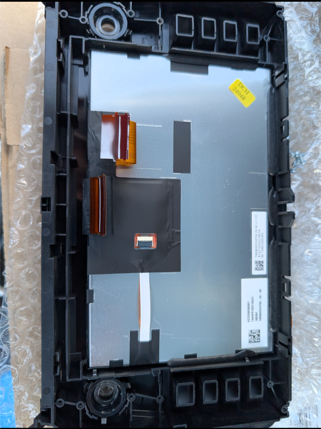

I retrofitted an Octavia 5E facelift with MIB2 and a navigation system and DAB....
of course, the touchscreen wouldn't fit. The Bolero has the setup button, and the Amundsen has the NAV button....

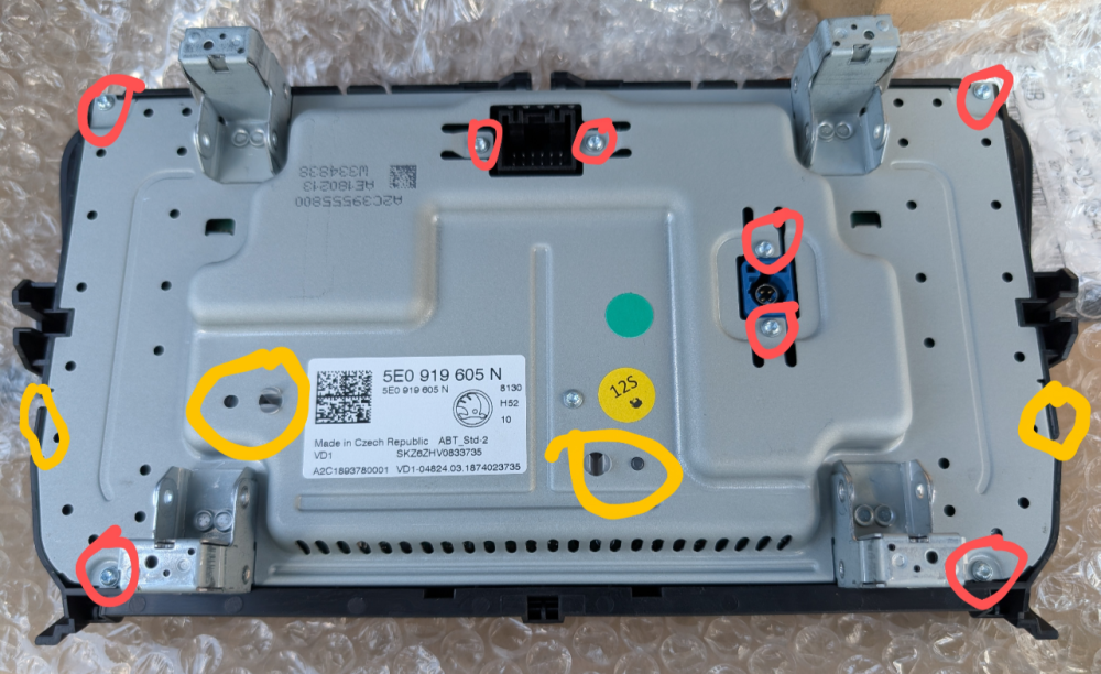

since the entire display units are ridiculously expensive, even used, I just bought the new LCD touchscreen from an Amundsen....

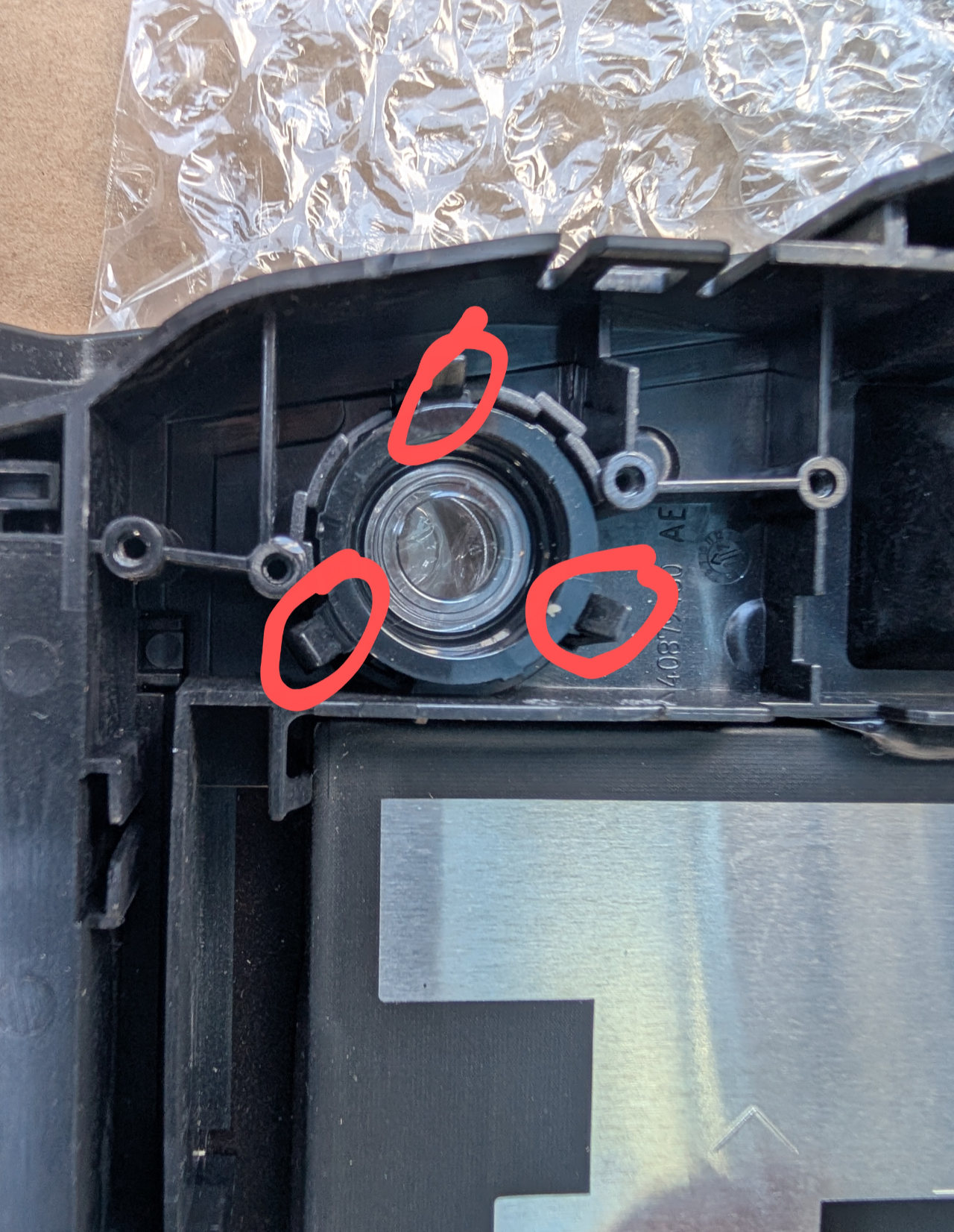

unfortunately, the function of the buttons isn't marked on the touchscreen, but on the display's mainboard....
the problem can be solved with Tool Box version 1.4.2, because this version includes the option for remapping buttons....
so the display conversion cost me €120...
Change Display need 15min
