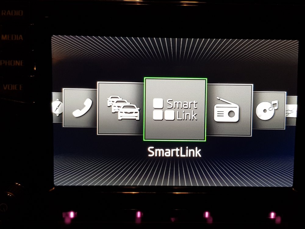

Hi Guys & Girls,
Great news, I picked up my 2016 MY16 Skoda Yeti Active 81TSI.
In love with the car, So much room and a great drive.
To give you insight, I am from Australia but I presume most of the info I'm asking for help with will be the same around the world.
My car comes with a Amundsen head unit which I believe is MIB 2?
Unfortunately the original owner didn't option the car with the tech pack which includes App Connect (Android Auto & Apple Carplay)
I heard it was possible for people to purchase an activation key and the dealer can activate this?
Funny thing is, Skoda Australia apparently don't know anything about this as they said unless it was done pre-purchase it's impossible to have.
Well I found a Dutch site that sells it but no idea if this is compatible - https://shop.skoda.nl/auto-accessoires/car-electronics/connectivity/000054830A-smartlink?cid=13
Can anyone makes suggestions on how i can enable Smartlink? I'd be happy to pay and compensate you if I can get this working. :)
See attached images.
Thanks All
Pre June 2015 Amundsen II only had the option of Mirrorlink and that could not be done post build but post May 2015 had the option of Smartlink and that can be done by the dealer at any time.
It has to be programmed at the dealer with an activation code from Skoda
For some reason Aus/NZ seem to be different with the infotainment systems especially with how firmware, maps and activations are concerned.
I'd ring around a few dealers and see if anyone can help.
