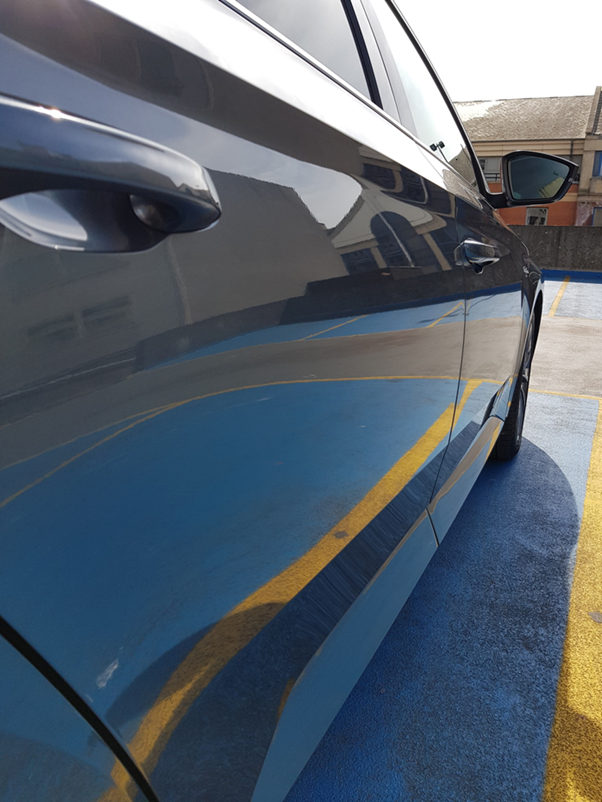

I had a new car protection detail done as soon as I got mine.  Wouldn't let the dealers even wash it.  Using GTechniq products, including Wheel Armour.  Very glad I did and get it all topped up once a year.
