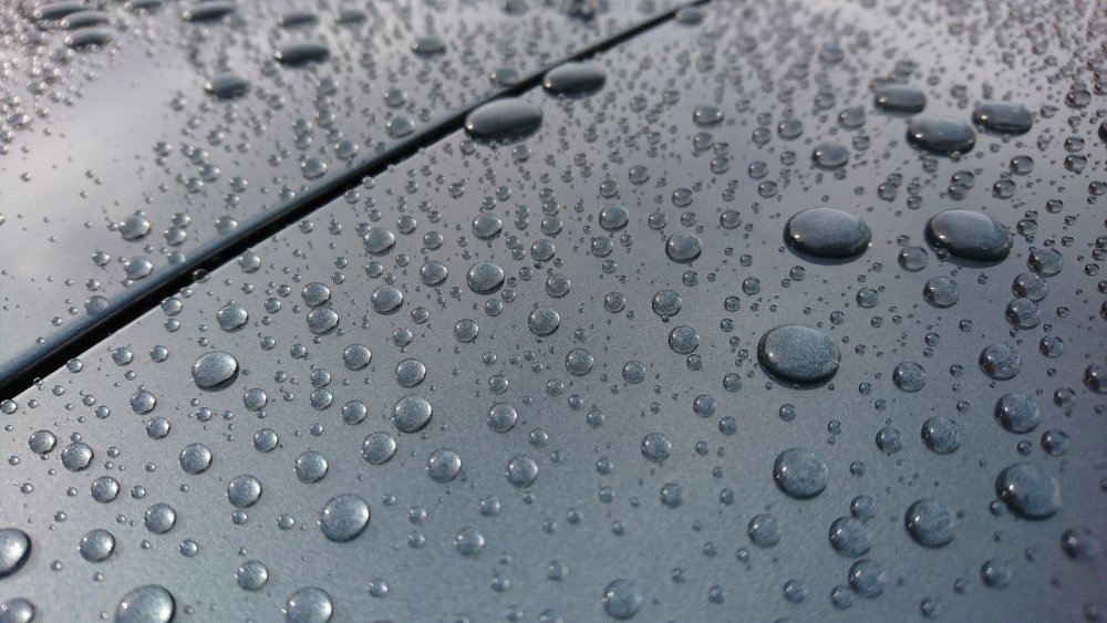

Update:
This weekend was my first with the car so after a snow foam & two bucket wash I cleaned the paint with Bilt Hamber paint cleanser, then applied Fusso Dark on Saturday then on Sunday Meguiars Ultimate Liquid Wax.
I have to say the Fusso was amazing on its own and quite easy to put on - very much 'less is more' and is one of the few things I've come across that lives up to the hype , watching the rain bead on Sunday morning was very satisfying.:biggrin:
The Meguairs Liquid wax, has improved this even more. (in the main)
However this morning the whole car was covered in dew/condensation and there were a couple of areas where I could still see the Meguairs, this wasn't visible yesterday, I went round the car checked & double checked. And now the car's dry at work, you can't see them.
How do I remove the marks/wax? Is it a case of more buffing, or will detailing spray help?
Good to hear you got it done :). I'd try buffing first (I assume you are doing it by hand), and if it still doesn't go, give it a spritz of qd spray.
I find I've always missed somewhere, so as a last action I run a clean polish mitt from front to back using no pressure at all, and deliberately doing it a different pattern than I did the original clean. The bits I've missed will be "grabby" under the mitt, and I use a microfibre cloth to take off the residue. One final run over with the other side of the mitt and if all is smooth I'm good to go.
Cheers Jeff, I'll give it a go when I get home, it's nice and sunny here now and I can't see anything from any angle, this morning it looked like the mist/dew was attracted to residual wax. A bit like writing on a mirror with your finger, then watching the writing re-appear when it steams up
Apart from that issue, I was quite pleased with the results :biggrin:
Wax tends to 'breathe' so it's not unusual at all, to find some residue the next day. Even in areas you're 100% sure you covered when you originally applied :)
As said, just go back over these areas with a microfibre buffing towel.
