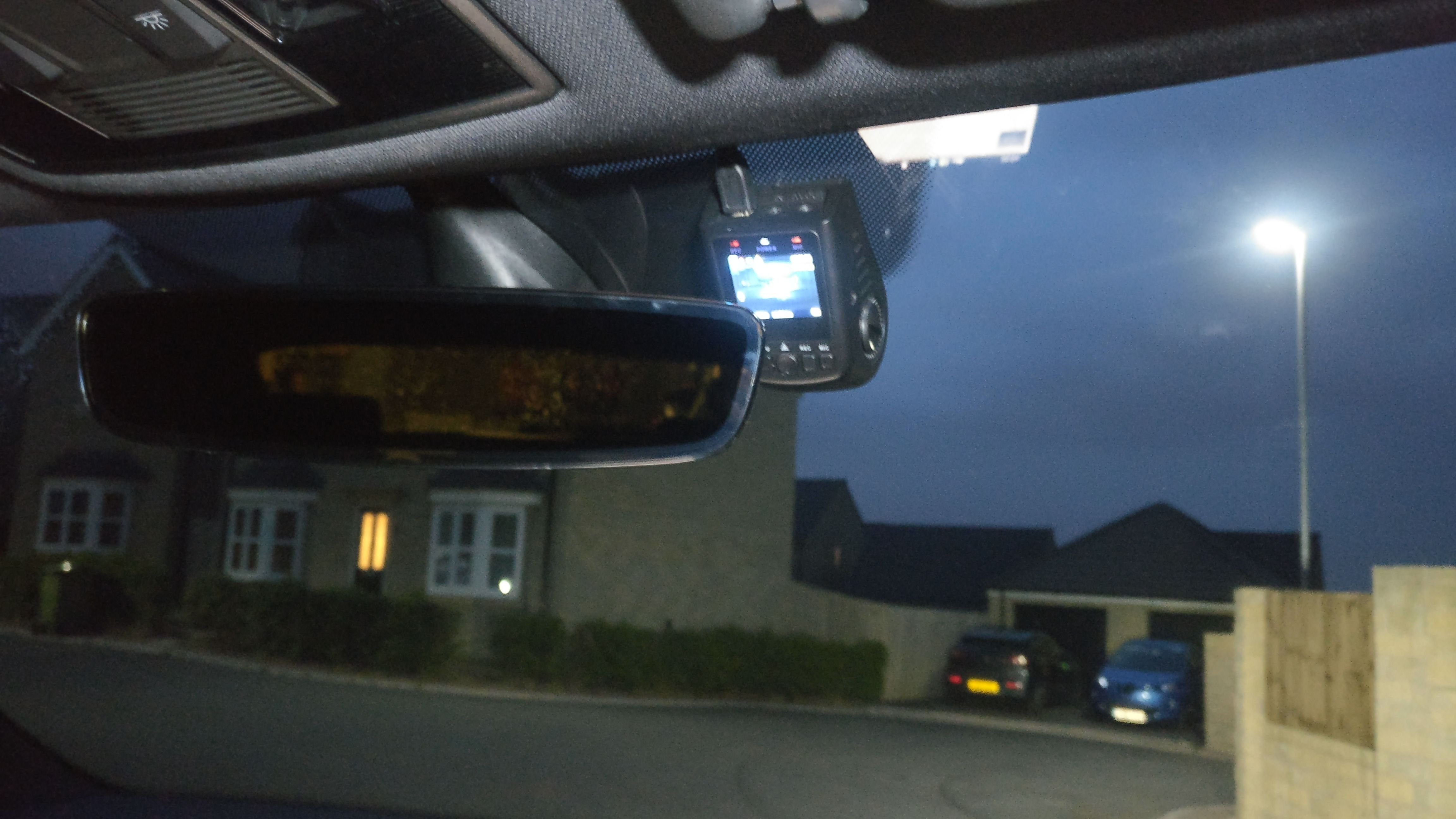

Managed to fit the dashcam all hardwired into fuse box tonight after the game. Doesnt look too bad.
Actually found a few earth screws in the side of the dash.  Side panel pulls off and i added a nut to an existing bolt that was there so as to not undo and disturb anything this way wire is totally hidden as can be routed to fuse box.
