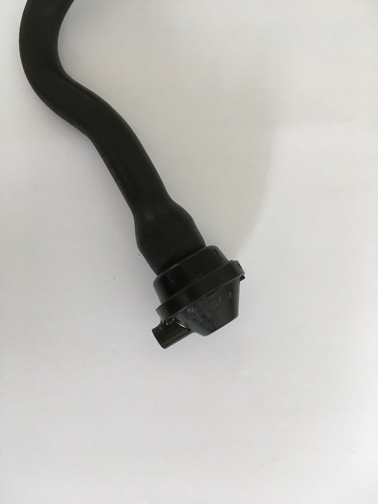

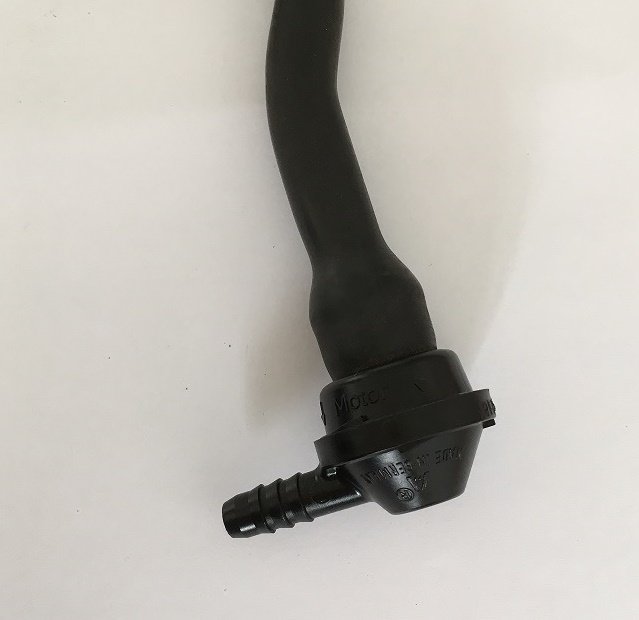

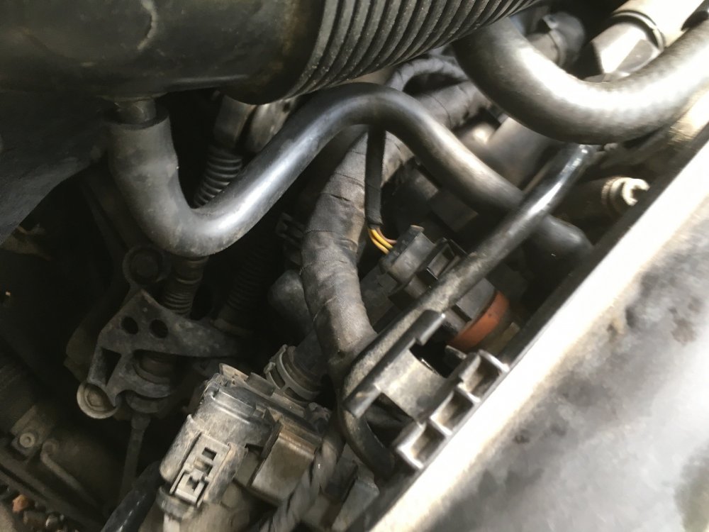

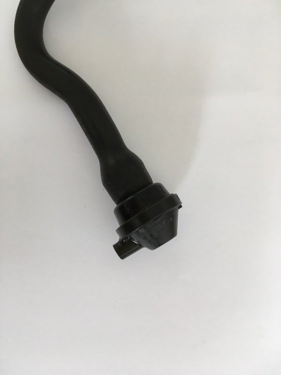

Out of curiosity, can you please post a photo of old and new once you have it?
The pipe from the air intake was loose at the rocker cover end and when it was removed to fit the new one you could see that the plastic pipe from the vale housing to the rocker cover had snapped off, I removed the rubber seal from the rocker cover which still contained the rest of the plastic pipe and then pushed the new one in, it's a bit tricky to get to and I had to use a forked trim removal tool to get the rubber seal out of the engine but it only took a few minutes.

Ah, in that case it could have been letting fumes out.
Well done.

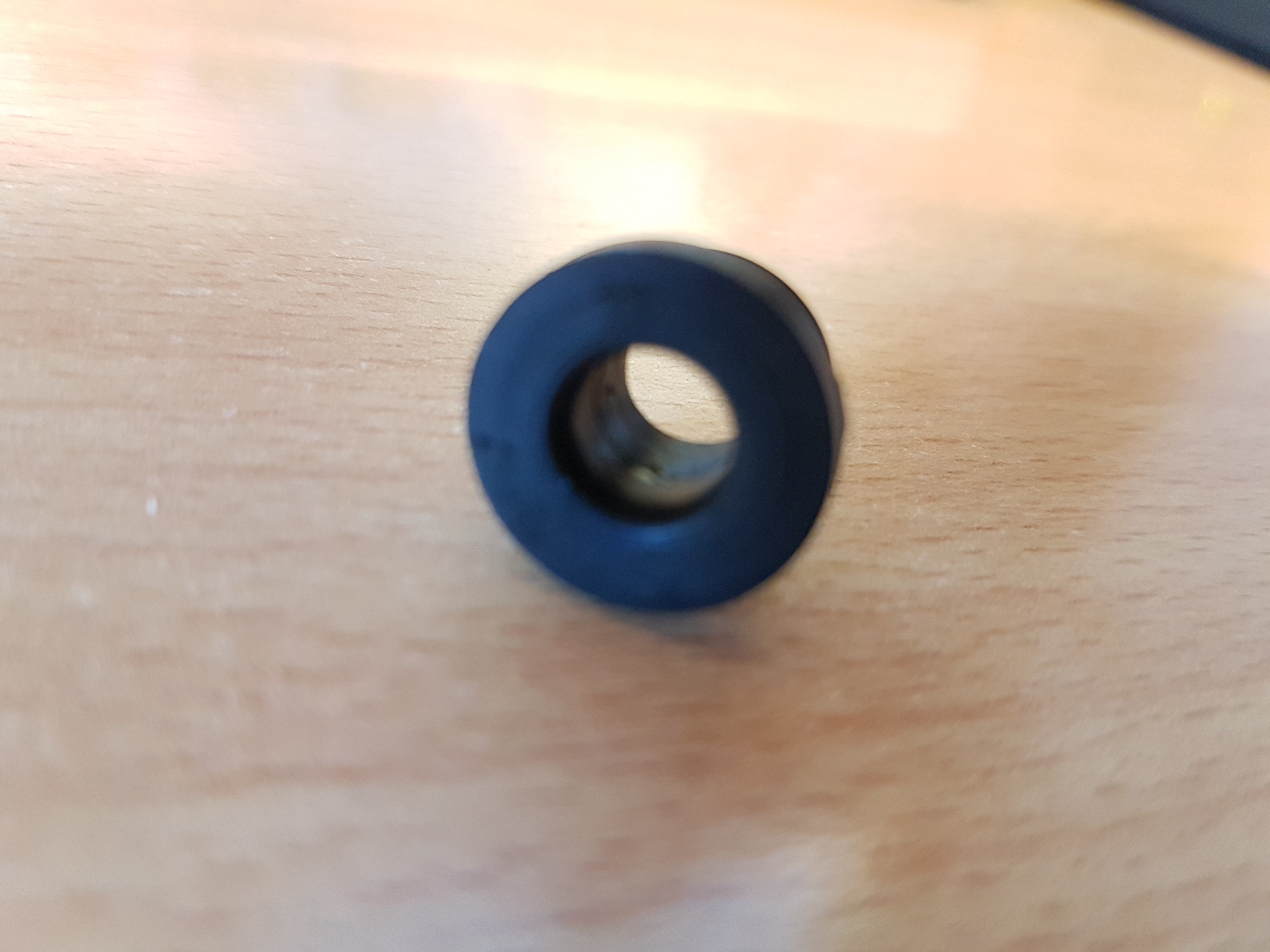

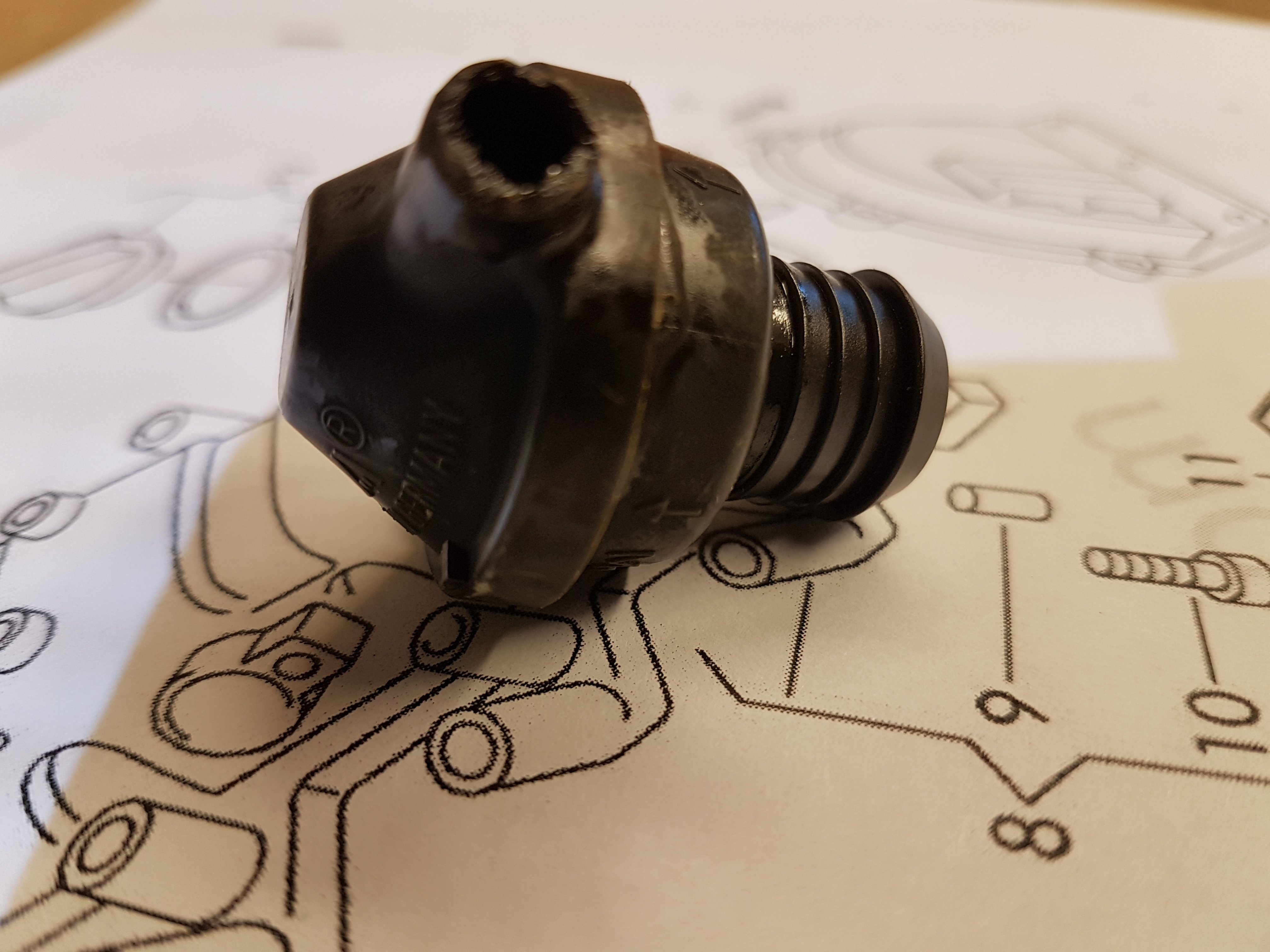

I had that on my Roomster and I had it replaced last month. It is the PCV valve and a very common problem. I had a major service and the air filter was replaced. This meant lifting the lid of the air box and must put leverage on that connecting pipe which in turn bends the PCV valve in the rocker box cover and breaks it. After the last service I felt that the engine was not as smooth and not so responsive as before the service. I recommend that the technician disconnects the pipe before lifting the airbox next time the air filter is replaced. Such a bad design: the connecting pipe must be made longer and corrugated to be flexible. There must be many people running around with a broken PCV valve. I only spotted it while cleaning the engine and found a residue around the valve insert. I lifted the valve to wipe under it and it broke in my hand.
Misery! The broken of piece is missing. Surely it has already gone into the engine 😲
Now what do I do 😩
