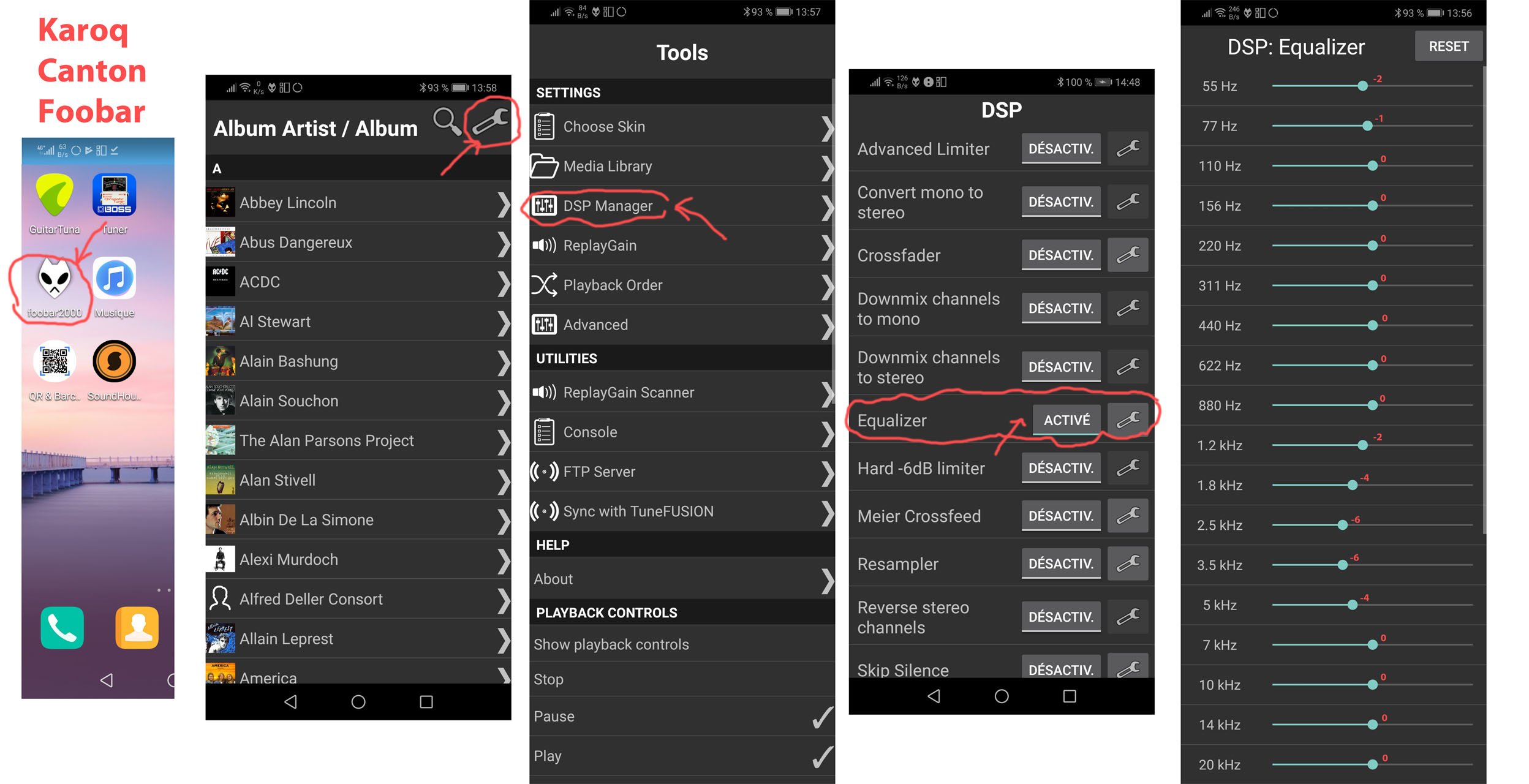

Despair not, FabFabFab,  Canton is not all bad and I have come up with a simple solution for the tonal issue.
The issue, according to me, would be too many high mids, 1-5 kHz range, and not enough low mids 200-1000Hz.
Resulting in hard rock music like AC/DC or Led Zeppelin sounding too agressive. Voices sound papery. Quack.
The Canton equalizer cannot fix that with its 3 bands (bass/med/high). Leave these flat (0/0/0).
I'd suggest to go Bluetooth and use an equalizer with a smartphone application with enough computational power.
My Huawei P20 Lite easily does the job but it's brand new and not cheap. It's also got 64 GB storage which helps.
I suspect audio processing is not that computational intensive so older samsungs may very well do the job.
Foobar, a freeware, is perhaps not the best UI you can get but a) no pesky commercials b) open source and
c) seems to be supported by music lovers who care about signal processing. There are many others.
You can enable / disable the equalizer among many effects clicking a checkbox for quick comparisons.
My settings are:
55Hz = -2    77Hz = -1
110Hz / 156Hz / 220Hz / 311Hz / 440Hz / 622Hz / 880Hz = 0
1.2kHz = -2     1.8kHz = -4        2.5kHz / 3.5kHz = -6   5kHz = -4
7kHz / 10 kHz / 14 kHz / 20 kHz = 0
DON'T amplify with positive corrections to avoid clipping distorsion.
That's a start but I can listen to Thunderstruck and Dancing Days without cringing.
This does not work with USB so we don't get the nice covers displayed.
Hope this helps.

Still, why won't you give a shot to my suggestion with playing music from a Bluetooth android smartphone and foobar 2000 ?
it's a lot simpler to implement, check the attachment
Jeff

after getting fed up with constantly fiddling with the EQ in the Karoq, I set the sound profile to Canton (what does this mean?) and this seemed to be the better of most evils. Still a little toppy but nothing for me to fiddle with so the wife is happy even if I still grimace a bit when Abba come on. I leave my subwoofer on max, and the balance fader two taps towards the rear.
obviously, I set the tonality options to Canton first thing too, it does make sense otherwise.
The equalizer setting addresses the issue with upper mids being too bright in Canton mode.

Thank you for posting your recommended Foobar2000 settings, they do indeed make a great difference to my iPod music in the car but I wish my Playlists could be imported from iTunes/iPod. The only trouble is that I also like to listen to radio quite a lot so for that it's the default Canton sound again. If I can find someone knowledgable near to me then I'll certainly have a try at fitting resistors to the tweeter feeds in the A-Pillars (knowing my luck if I try it myself I'll set the airbags off or break a retaining clip). Or I could replace the tweeters for "softer sounding" ones - I'd replace the Canton door midwoofers too but these are 8 ohms and all others in the world are 4 ohms. It could well be that a simple adjustment in the amplifier's crossover frequency would sort it all out for me (if only I knew how) or even adding a simple equalizer after the amp might do it. I do appreciate all your suggestions.
