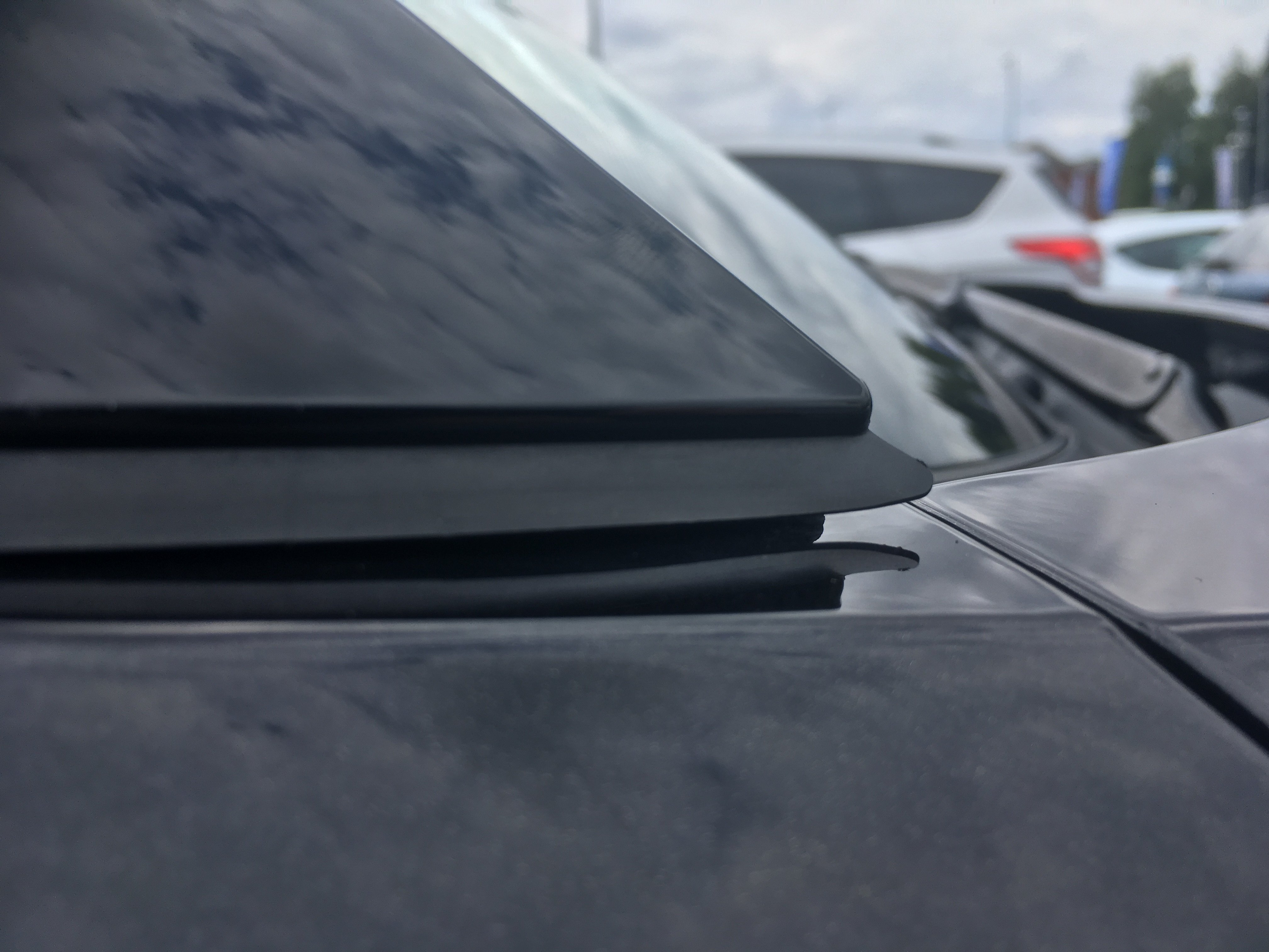

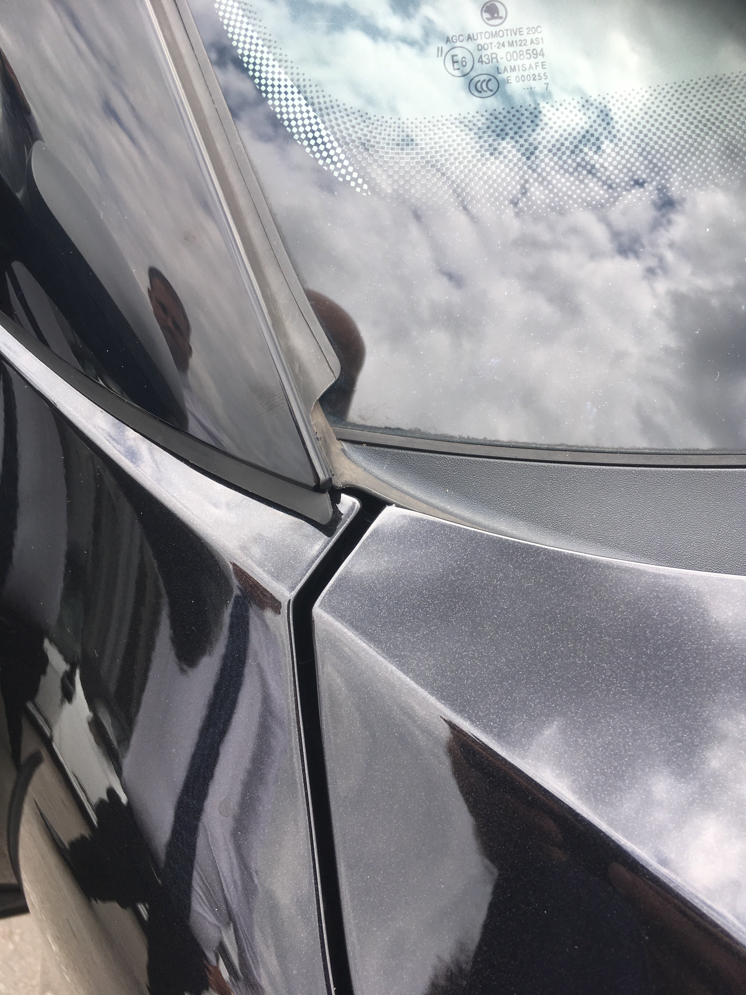

Appreciate some speedy advice. Just looking at a yeti to buy now. I’ve looked at a couple now but never noticed a panel gap like this between the front pillars and bonnet.
Is is this normal? The bonnet itself is differently aligned to another yeti at the dealership. Nothing major but not quite flush.
Slightly paranoid about buying a shunted and repaired car.  HPI check shows nothing.
This gap is the same both sides. It’s less at the back and more at the front.

Looks bad.
HPI check shows nothing if a car is not repaired under the Insurer if someone never made an insurance claim and any Insurance Company Interest.
Cars can be badly crashed and repaired and an Insurer never the wiser.
Have you checked the Warranty History and any Zinc Inclusion type repairs, replacement panels etc in the records.

Hi -  No not normal at all! The gap is far to wide and even the "A" pillar trim does not seal correctly.
In case it helps, I have just been and measured the gap on our Yeti, All the door "Shut" gaps are uniform at 4mm, that one looks significantly more!
The base of the trim on the "A" pillar should seat against the wing and form a seal. That is how they arrive from the factory though I have seen some where the screen has been replaced where the seal is less than perfect.
I think that a bit more "digging" is required to ascertain just why these are as poor as they are before you commit yourself to purchase.......Good Luck!

The bonnet could be aligned better clearly, but I was concerned at the fit of the front pillar mouldings being clear of the wings.

It certainly wasn't a Motobility Car which I had been told it was at one point by Evans Halshaw.  Maybe the non warranty repair explains a bump repaired without being declared on the insurance, which explains the shonky panel alignments.

With that low amount of miles and being 7 months old I would imagine it has been off the road a while and undergone some extensive body repairs by looking at those panel gaps, looks like its had quite a major front end smash
As for Evans Halshaw saying it came from the factory like that, it would never of passed quality control like that
