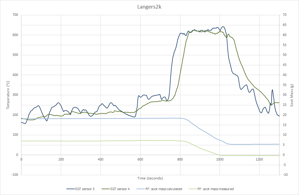

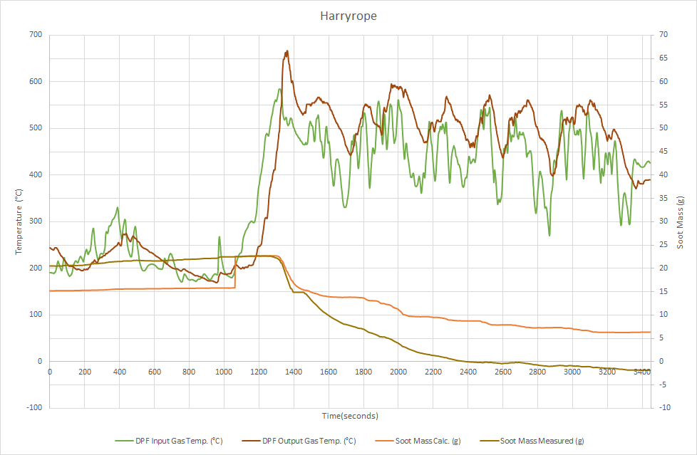

Most obvious issue is that most (all?) your regens seem to be taking ages! That log suggests it was still doing an active regen after 65 minutes, to put it in to context, I've recorded two regens in my unfixed CFHC which took 5.2 and 6.3 minutes.
It almost looks like it's struggling to get the DPF up to temperature. Mine seems to stay above 600'C, at least based on EGR temperature sensors 3 and 4 which I think match DPF in and DPF out in the VAG DPF app.

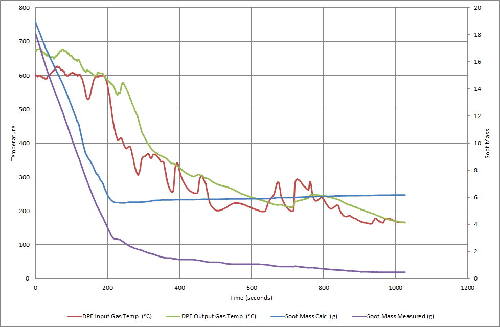

I've graphed a regen from each of our cars. It could also be a function of the roads that were being travelled on during the regen.
Mine probably happened while I travelling at 70 mph or similar depending on traffic. Your log appeared to start at 2018-08-28 17:48:10 so you might have a better idea where you were driving at the time...
That graph is very impressive, thanks again.
I was driving on A roads and it was indeed struggling to get upto temperature.
Being aware the regen had started, I gave it a few healthy blasts up the back roads, but it did seem to struggle on this one.

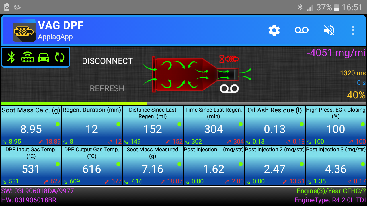

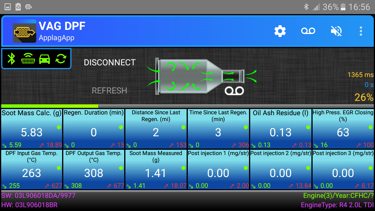

Managed to get a cple of snaps tonight on the motorway...thinking this looks ok ??  log file also, don't know if things are getting worse or better ;-)
Vag_DPF_log[1].txt
1706791813_Screenshot_20180904-1651371.thumb.png.d49aefff0ef211ff3d516acc6be23935.png
Certainly seems more normal, looks to have taken 200-250 seconds.
