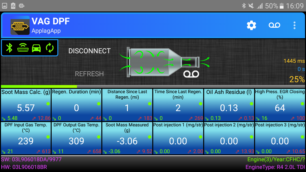

Might be worth adding a screenshot from the VAG DPF app to show the health of your DPF.

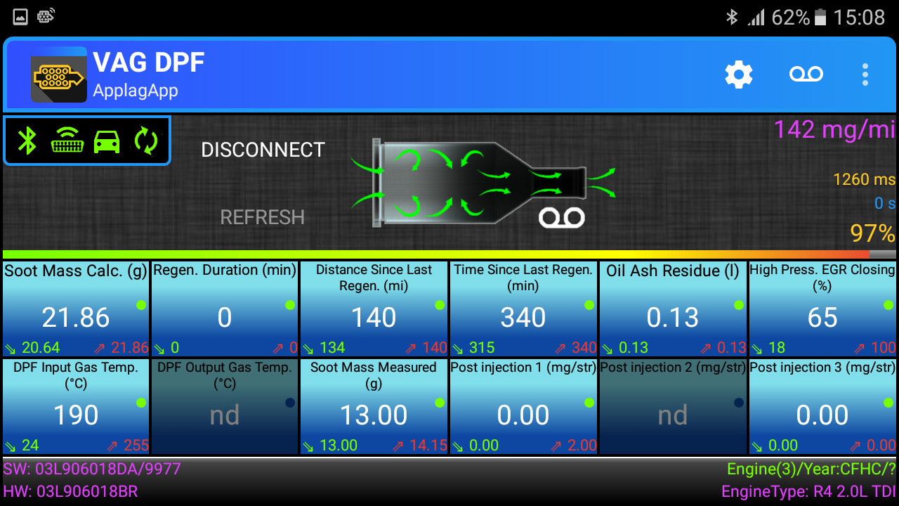

Thanks for replies...i just got a screen shot..just learning about what each bit means
It's the oil ash residue level that's probably the most important number for DPF lifespan.
Basically, the DPF collects soot. When there is enough soot, the car will try and burn it off but some oil ash residue is left, this will slowly build up until the DPF is clogged and can't function properly. There is no definitive maximum from Skoda but online it's suggest the maximum is around 175ml for this kind of engine. There are reports of other cars hitting 300ml+ without issue so I can't be sure that 175ml is a hard limit.
Based on your current level of 0.13l and 130k miles, you *might* need a new DPF in 40-50k... That matches the expectations of some other forum members that have posted milage/oil ash levels.

I will use vcds and various other methods to now track /record and monitor the regens...perhaps give it a couple of weeks..at some point I will ask Skoda to look into the problem again.
On leaving the dealers, I mentioned it would probably be about to do a regen....

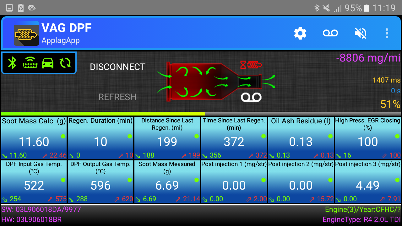

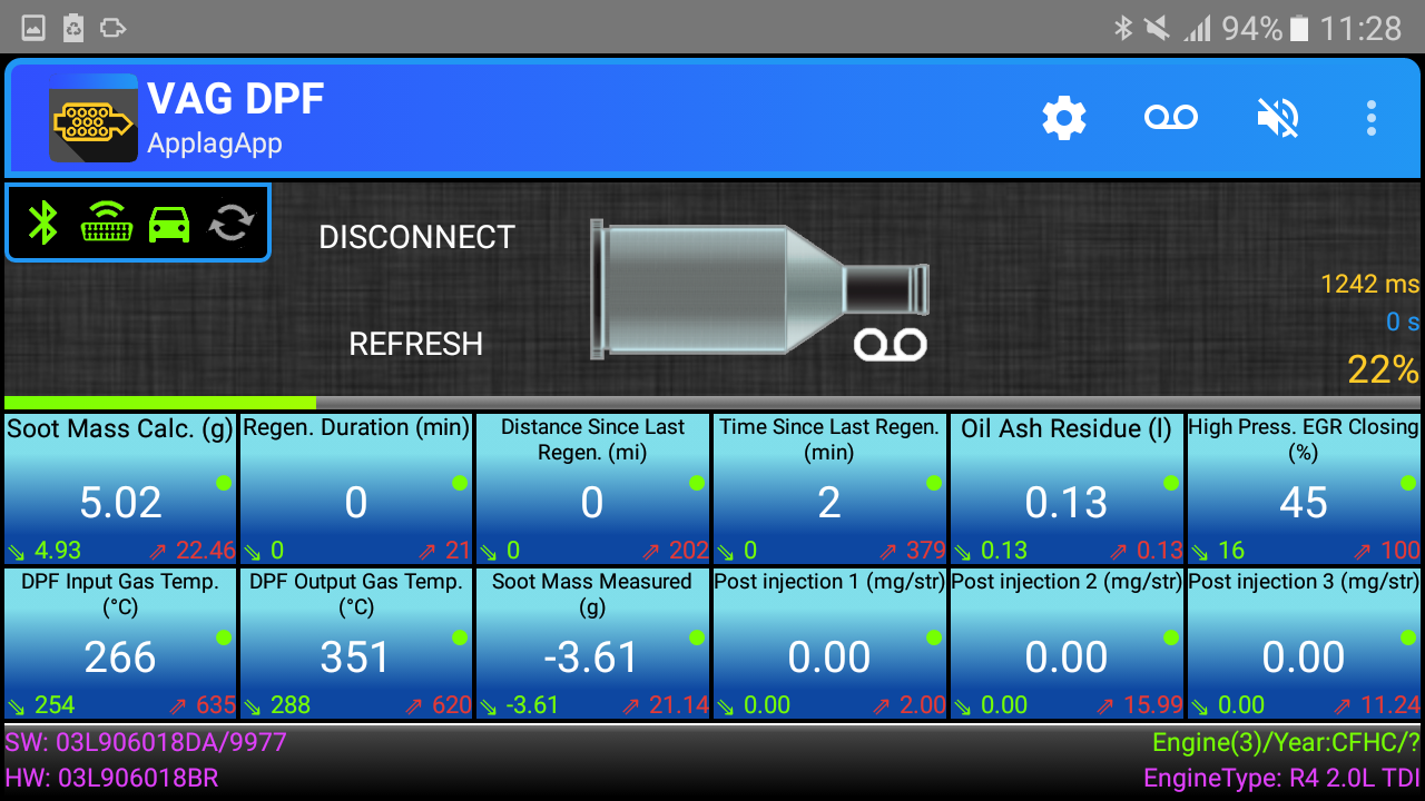

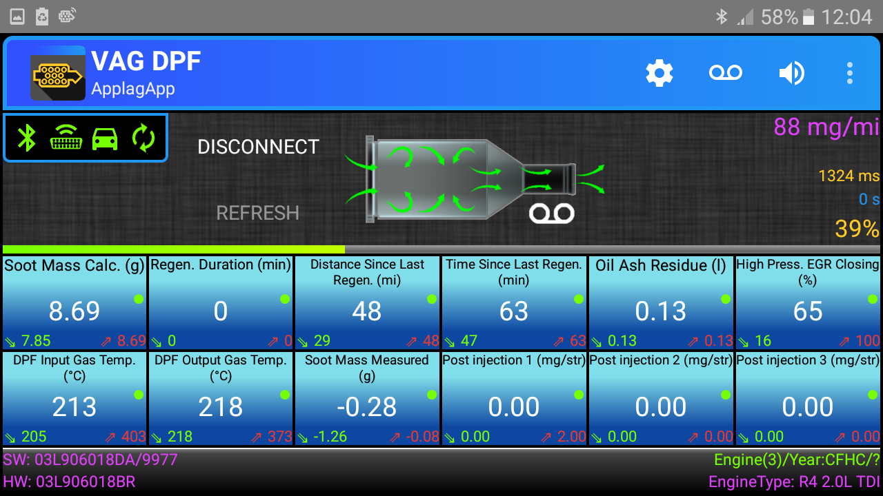

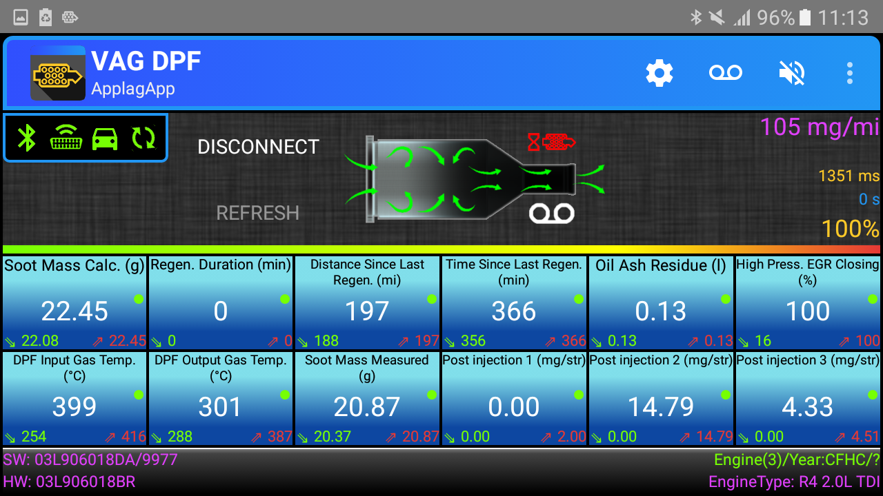

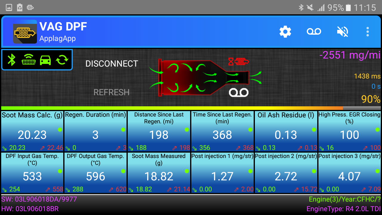

Do you have a screen shot of the figures once the DPF regen finishes?
My 1.6 starts regen at 88% and will burn off continuously, if uninterrupted, until it drops to about 5g of soot (which I think is about 20-25%). It would only reach 95%+ if I stuck with slow town driving all the time, and by then the DPF light on the dash would come on. Maybe yours isn't getting a full regen which would trigger shorter distances between? Although I see sense in the point above that as the oil ash increases the DPF will regen more frequently due to less capacity.
For info, I have 80k on the clock and the normal mileage between regens is about 420-440 miles.
Hope this helps, recent long runs ...have a log file with loads of info but using notepad it doesn't display correctly and figures all over the place...anyone know which log file viewer for VAG_DPF works best?
344653009_Screenshot_20180808-1115081.thumb.png.c4e20f4dc8bd81dc2a98de890ef55847.png1164170300_Screenshot_20180808-1119191.thumb.png.25550b844c7c70c4468a16bfce492baa.png660924977_Screenshot_20180808-1128581.thumb.png.bc63d7f8bd1bef94417e7dd8d2629783.png
Harryrope, I've just noticed your "oil ash residue" measurement units are different to mine. My app displays this figure in "g" and the figure in the bottom left of the box is a %. i.e. currently it says 30g which is 43%. I'm assuming when it reaches 100% that's new DPF time. At quick glance all other data is the same.
My app version is Release 2.26.9, haven't noticed an update in a while, but may have missed one.
That's nothing to do with the VAG DPF app.
It's the ECU that decides what units to use, if you were to use VCDS (or any other tool) it would also show in grams for your engine and litres for Harry's and mine. It's not something that can be changed :)
