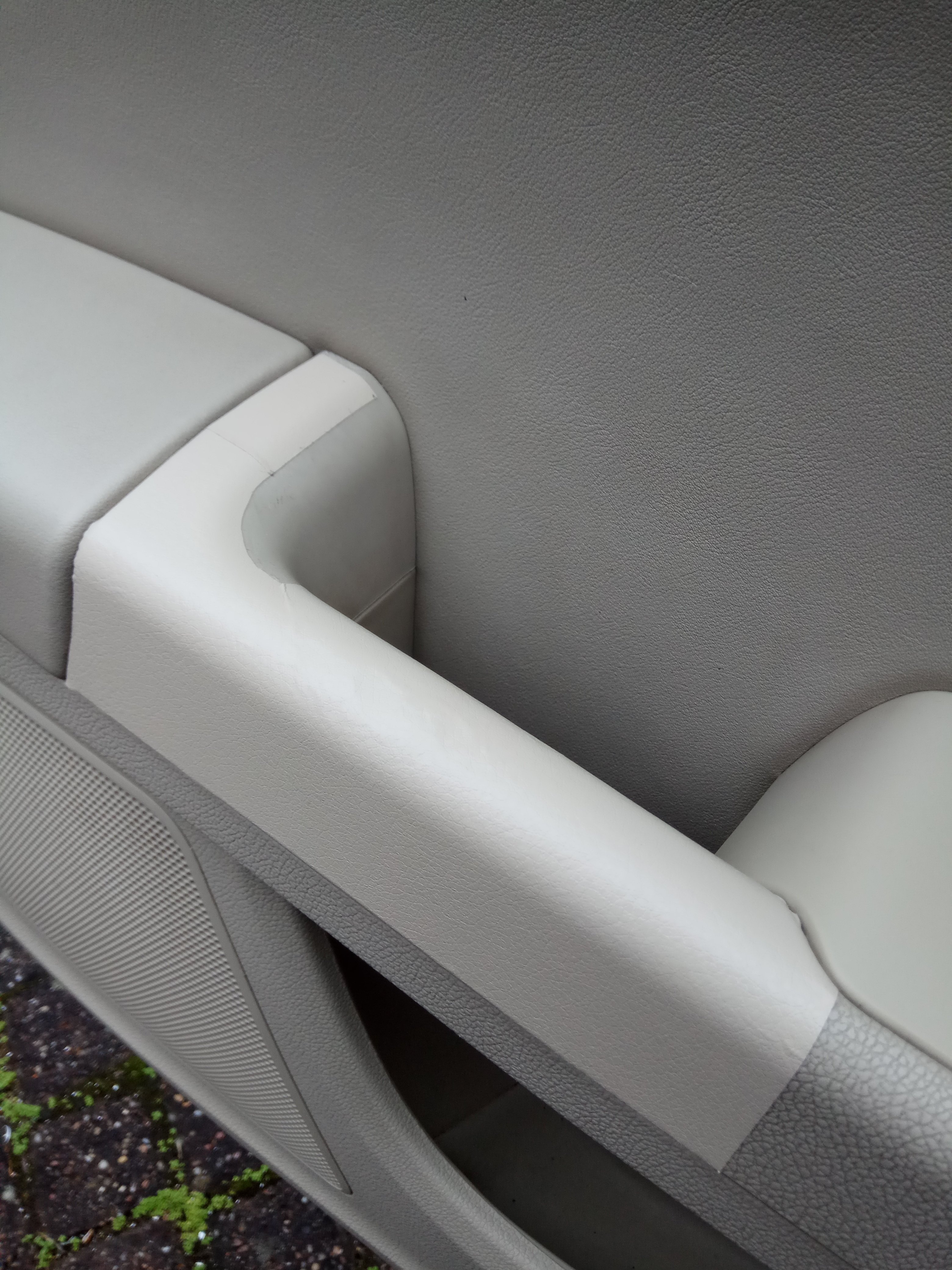

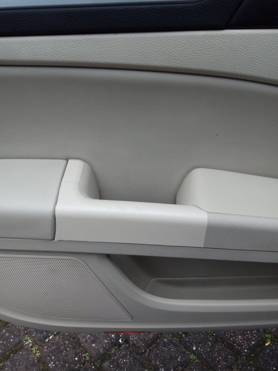

Further to my earlier post, I got some of the self adhesive vinyl and applied it to the door handle. I didn't scrape off the original covering as it hadn't deteriorated too badly. I first made a paper template of the area to be covered and then cut out the shape from the vinyl.  It was a bit fiddly to apply but the application of a bit of heat (not too much!!) from a hot air gun made the job easier. I'm reasonably happy with the end result but, as with most things, I can see areas where I might have been able to improve it. I may have another go at it in the future after I've seen how the vinyl copes with everyday usage.
The colour isn't a perfect match for the beige interior of my car but I'm a firm believer in the old adage that "An ugly patch is better than a handsome hole".
Images attached.

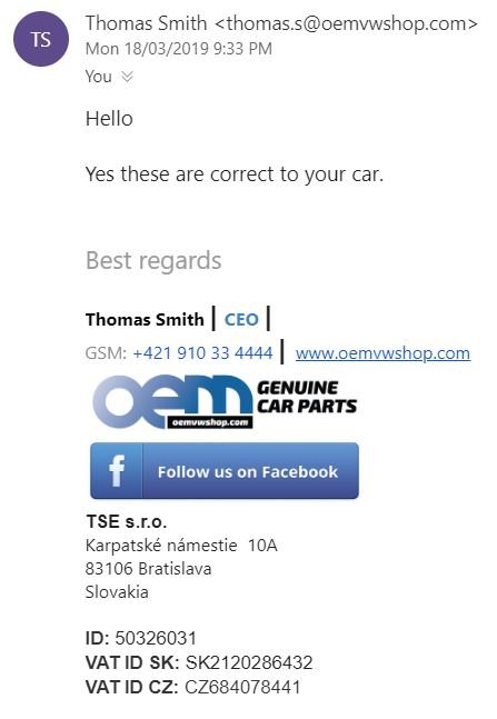

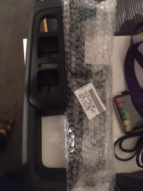

Hello Peeps,
I've had the handle flaking issue for about a year now and understand its the heat that 'melted' the handles - I'm in Australia.
Just sourced 3 'right handles' for my Australian RHD model and its the original OEM stuff and not at the dealer-rip-off prices. Have 2 to sell in Australia, if you need. If you need one, PM and I can help you out. If you're in Brisbane, I can install it (after I figure out from YouTube, how to do my car first). PM me if interested.
PS: Make sure when you contact, ask for both left and right handles, as orders are per piece (not a pair). Learnt the hard way, though still cheaper than Dealer-rippers.
Cheers!
