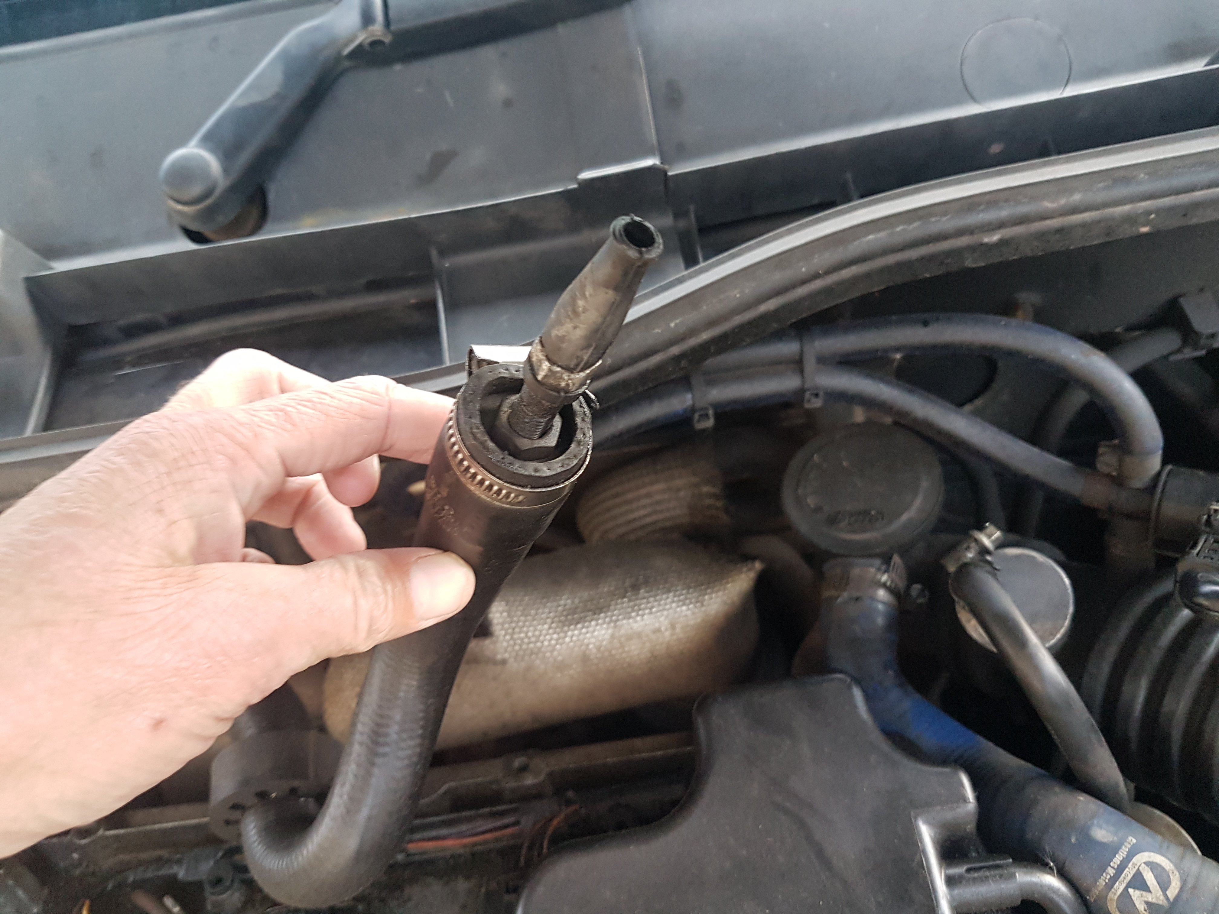

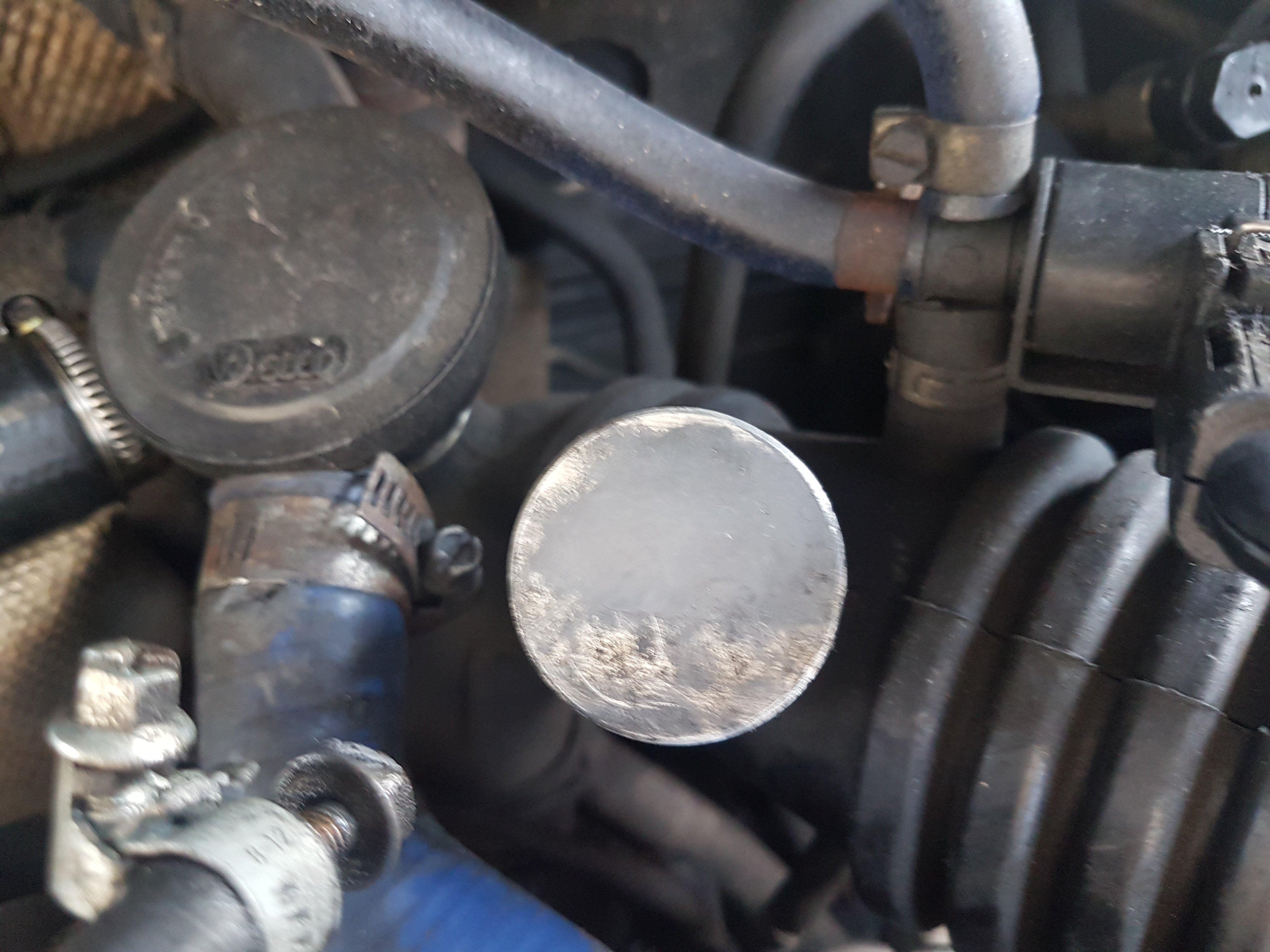

Hi thanks for getting back to me, as you can probably tell im not machanical minded and this is the first turbo car iv owned. I have only just recently got this ploblem and never had any codes, running problems, limp mode, boost spikes ect in 3 years till now. Car has full boost for about 5 mins and its like ECU figers something is wrong and cuts power. Car runs as it great on normal driving and always great on fuel. My brother in law is a mechanic and looked over the car when i got it and only ever said that someone blanked dv bevause it was probably broken and person just blanked it instaed of buying new one, but has never said about the affects. He has same auq engine in his seat leon mk1. You now have me really worried. I will take pics and put them up. Thanks agaim for your quick response.
As far as i can see there is two hoses that have been bolted. Big one in second pic and the one on bottom right corner of first pic. Think this is what would go to my dv if it was there. So this setup is very bad for my turbo?

I'd get a forge 007p recirculation valve chucked on that asap.
A standard one may be ok but might not like the extra boost from your map

People think the stock DV isn't reliable but that's because people buy an old 1.8T and start tuning it and then they find the stock DV has had it and buy a forge one. If you buy a forge valve and run it for a decade and 100K without maintenance it would also leak boost because it also relies on consumable parts to work.
Not having a DV does not alter how the car runs at all, but when you are on the throttle and are creating boost, or even worse, wide open throttle and creating max boost and you suddenly let off the throttle, all of that pressure in the system has to go somewhere and that somewhere is back through the turbo which slows it down rapidly which will shorten its life dramatically.
