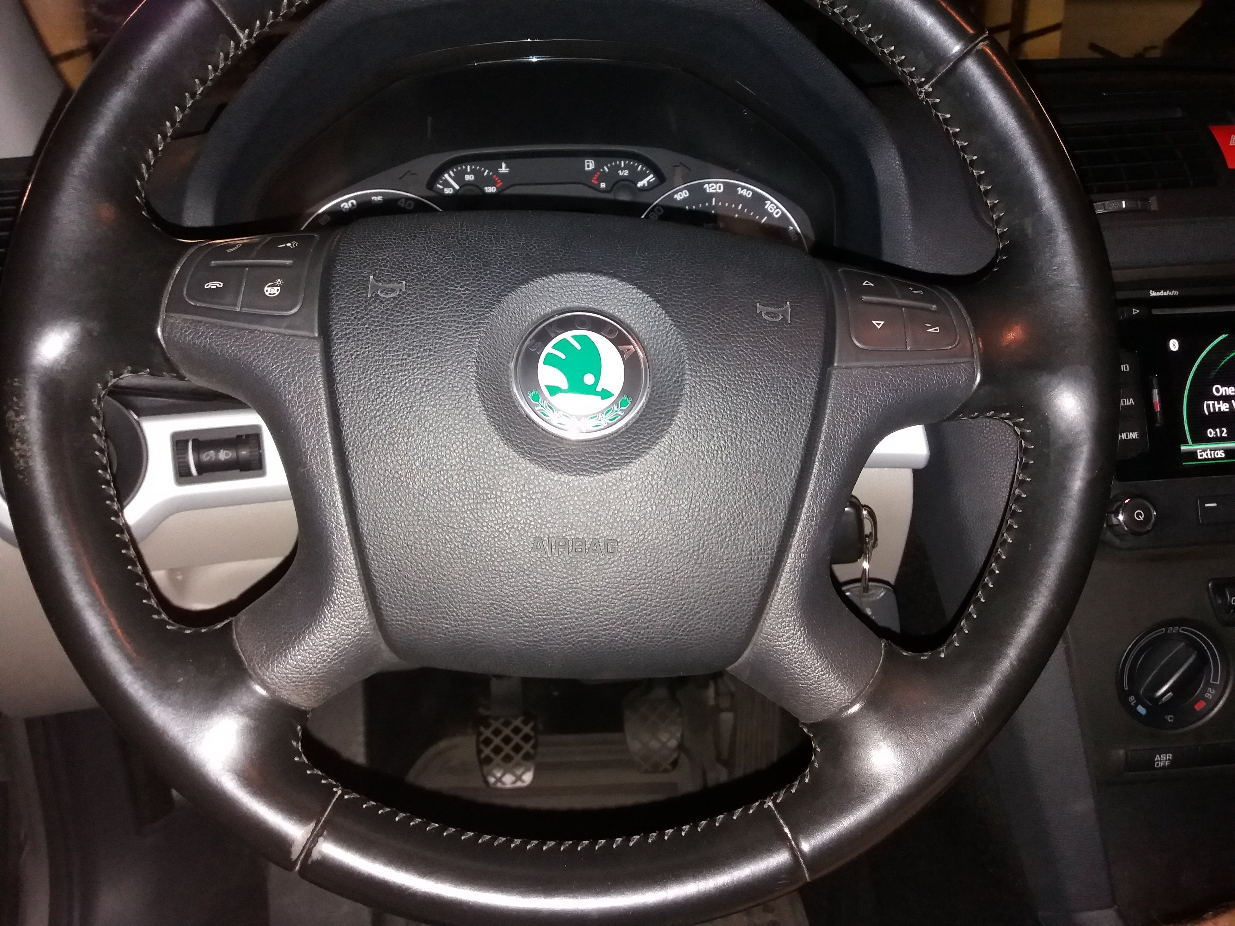

I just did this a couple of days ago. I have a y2008 PreFL octavia, 1.6 MPI.
I ordered the following parts:
Stering wheel:
1.
Steering wheel itself: 1Z0 419 091 R/S or 3U0 419 091 N/P
2.
Buttons:
- 1Z0 959 537 A - this is with the phone buttons and the vioce control for bluetooth
- 1Z0 959 538 - this is for the volume and track controls
3.
Control unit in the steering wheel: 1P0959542
4,
Steering wheel airbag cable for MSFW: 3T0971584A
I ordered these (1. to 4.) as a complete steering wheel off ebay, it was ~60EUR.
MSFW control unit:
1K0953549CH
I also ordered this off ebay, it was ~65GBP.
The retrofit is not really complicated, Check out this video:
After fitting the mechanical parts only the VCDS/Obdeleven coding was needed. I made a screenshot of my original MFSW control unit (1K0953549C) which turned out to be very useful since the 1K0953549CH has more coding options.
My MSFW, since it had buttons for the bluetooth controller, needed to be coded as an MSFW with push-to-talk. I ended up having the long coding to be 0000334, where
0000x00 is Multi functional steering wheel without triptronic and with push to talk installed (if one has no voice control buttons on the wheel but the other ones with rewind/etc. then this is 1)
00000x0: Cruise control system with 4 positions via blinker stalk installed (without cruise control this is 0)
000000x: Rear wiper installed, board computer via wiper stalk installed
Check out a picture of the result and also a video how the vioce control works in my car.
Pic:
Video:
Edited by olesz
