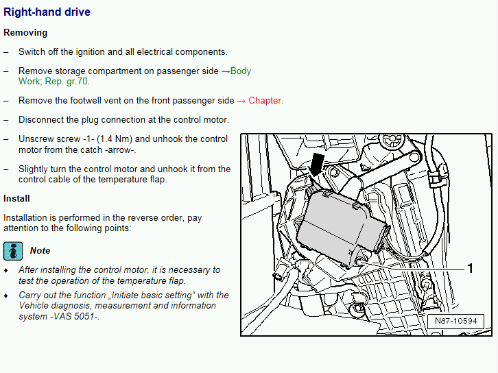

Yep, it's easy to change.
Grab my PDF here: https://www.briskoda.net/forums/applications/core/interface/file/attachment.php?id=110288
The servo you have to remove to slide the PTC element in is the temperature regulating servo (left).
Also see attached picture that has some more details.

I think it would be left, as in the one in the passenger seat footwell.  The problem is that ELSA doesn't always distinguish between left and right hand drive, although in that screenshot above it actually says right-hand drive for once.
Easy way to tell, plug in VCDS, open up output tests and perform an output test on the left servo.  If that one moves, then you're onto a winner.
