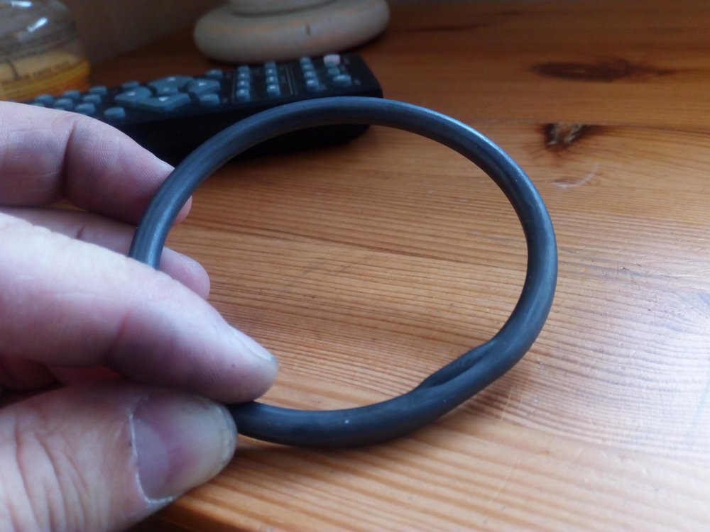

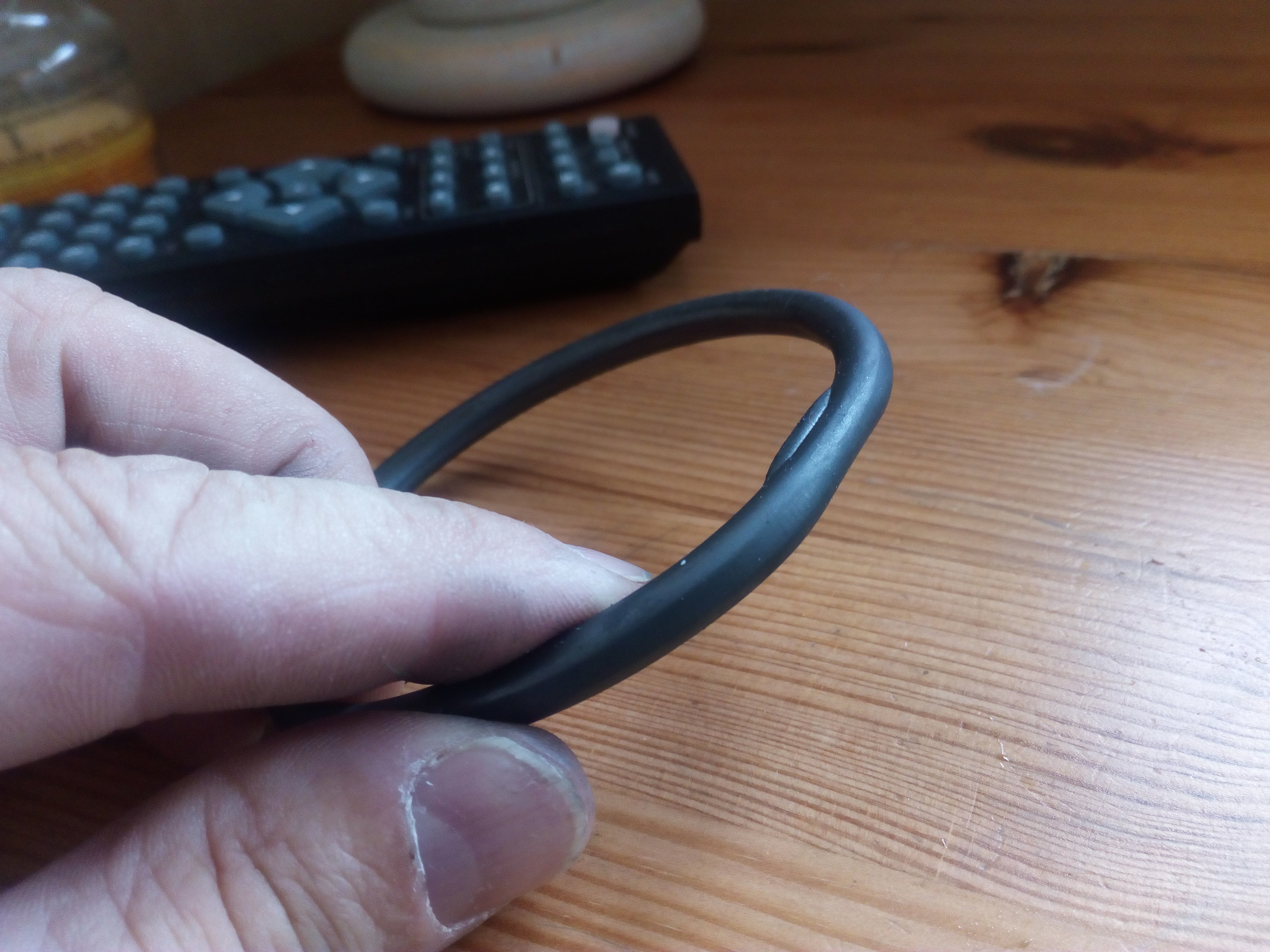

I have ordered a new o ring seal and will prob get the Bosch filter like you did. This is my seal on the airbox side which I'm not sure is affecting it ? Must have been trapped for a while looking at it. Cheers..
been out today in it after fitting new seal and no light yet, tried to provoke it as i have managed to before and nothing , i noticed it was coming on at 1400 rpm off throttle engine braking so tried that in all gears still nothing so fingers crossed ..
one question tho ,why would a bad o ring on the airbox side make any difference (other than dirt getting through) as the airbox is open to atmophere anyway ??
gone quiet on here ?
The bottom line is if the light is staying off you have found and solved the cause. As to why a slight leak would be an issue I don't know, a change to the air flow i.e. turbulence is perhaps a possibility.
