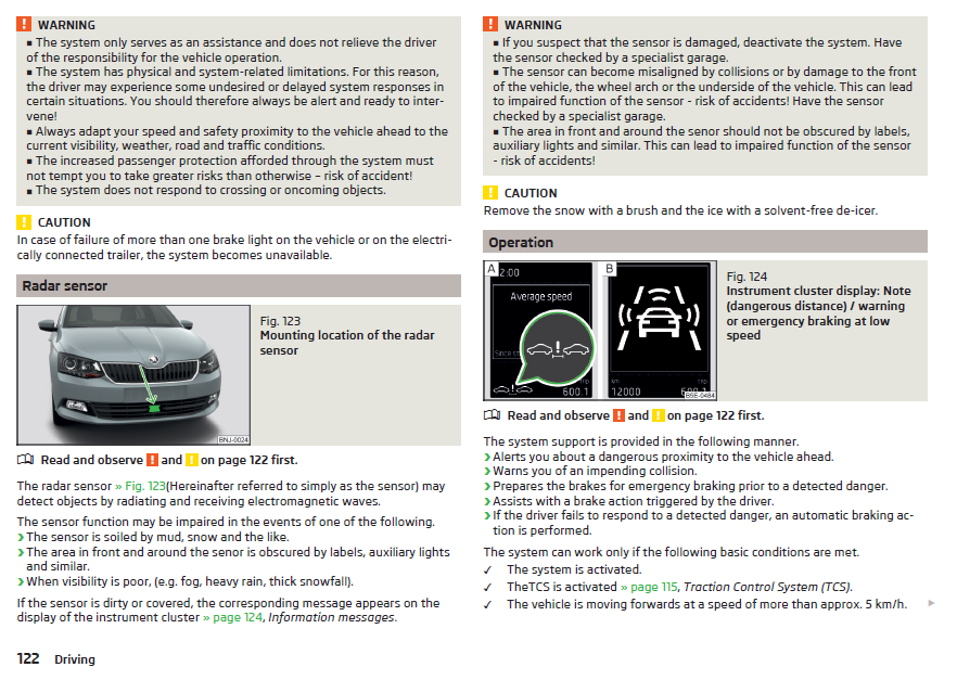

I bought a new Fabia TSI 1.0 SE in May.. Today, as I was driving, a warning symbol appeared on the dash accompanied by an audio ding.. It only lasted a few seconds, disappeared as I changed gear.. I looked in the manual to find out what it meant but the symbol is not there.. I can only describe it as similar to the stability/traction control, except the curvy lines were displayed all round the car (as if it was driving through an earthquake!!).. Any ideas what this is?

The symbol I got wasn't the same as the one you've posted.. It was like the traction control but shown all around the car, not just below it.. Thanks for the reply, though.
Front assit

Thanks - that looks like it.. I was on a clear road though so not sure why it was telling me that something was ahead!
In my Owner's Manual you can see the symbol on page 122

wiganken1 -. page 122 in my manual is all about stop/start, no symbols. Thanks for replying.

It may not be on page 122 but it will be in the manual somewhere. Look in the 'Driving' and/or 'Assist Systems' sections.
Just in case I am attaching a picture of page 122.125358620_FrontAssist.png.c66b8a69ae13a192dbe2474181317ea9.png
