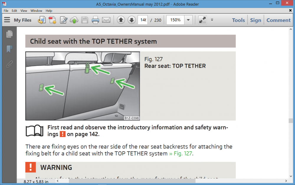

Taken from the owners manual of my 2012 car. As said by a previous poster, the webbing clips to a fitting in the centre of each rear seat. I don't have the additional central seat mounting shown below.
If you do not have the rear mounting shown in the photo, you can download a copy of your owners manual from the sticky at the top of this forum. Note that the clipping point shown at the bottom right of the photo is for a cargo net, not a child seat tether.
