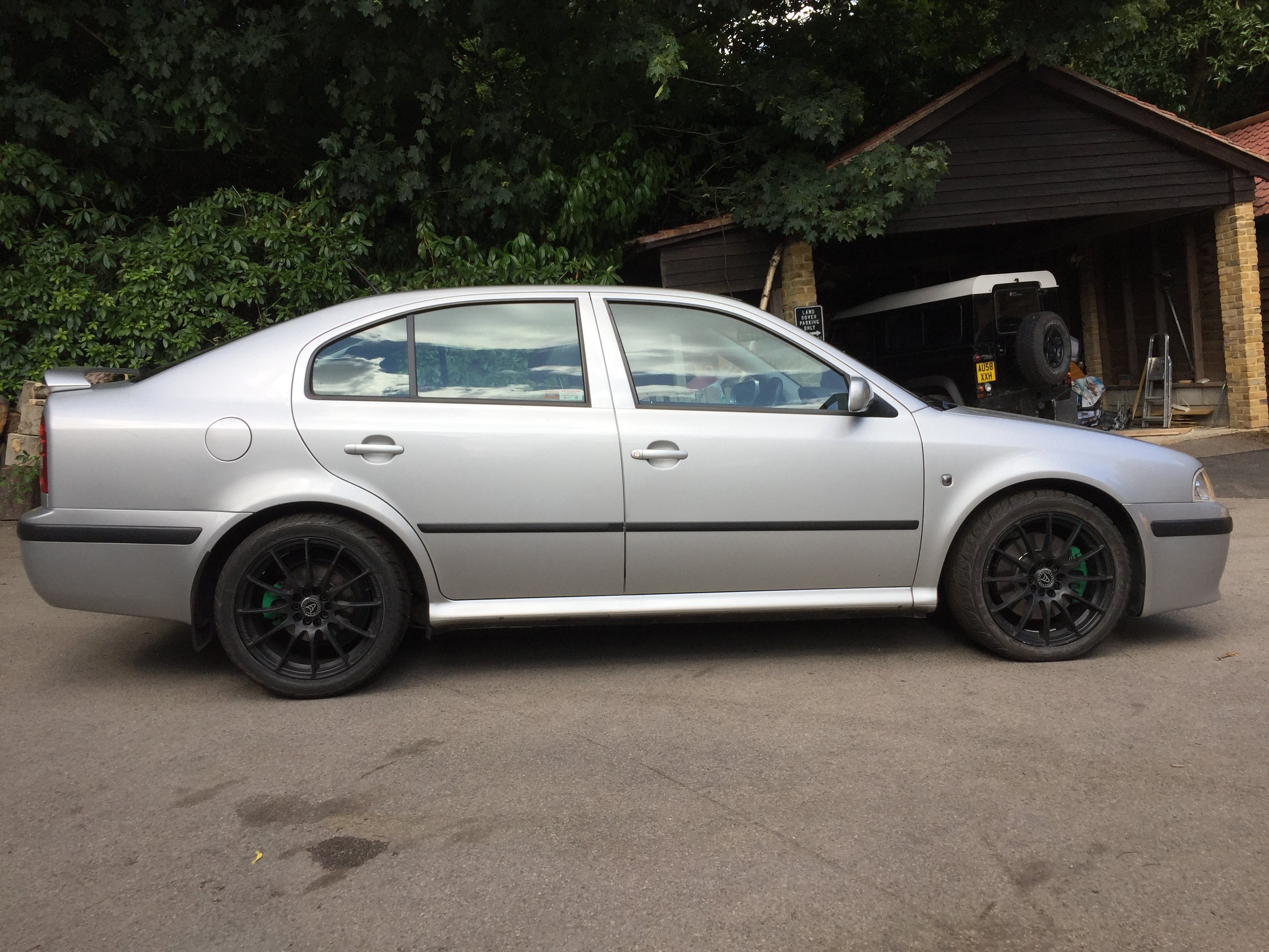

Mines only slightly modified in a fashion that keeps it nice, versitile and useable daily.
Remap. Mine has a Jabba map, which was done by the previous owner. If I was choosing a mapper I'd go to R-Tech in Hinckley.
Exhaust - Plenty of options available, depends if you want loud or subtle. I have a powerflow cat back with just a single box at the back mated to an Ebay 200CEL sports cat. Flows well, sounds nice, but not loud and the sports cat is MOT friendly.
Induction kit - something decent quality or a decent panel filter in the standard box will suffice.
Brakes - if your pockets allow, the Leon Cupra R Brembo set up is popular, I just run decent padshe standard 312's and they suffice, even for a bit of track time.
Handling - I've fitted the Audi TT front end set up with cast wish bones etc and quick rack. Nice direct bolt on upgrade and makes the front end feel a lot more precise. A rear anti roll bar is also very worthwhile. I've stayed away from coilovers as I find them to harsh for road use, I like  bit of comfort so I'm running Bilstein B4 shocks on standard springs.
I think that's about all I've got on mine and it makes for a nice comfortable car that'll do 42mpg on the motorway in comfort, especially with the cruise control on, but goes like stink when I want it to :D

Have just fitted a set of Wolfrace lightweight wheels with a set of Federal RSRs fitted just on a temporary basis, (which I had in stock!) while I get the spiders powder coated.
First impressions:
Suspension is far too soft for fast work but compliant for ordinary driving.
steering rack is too low geared but fine for ordinary driving.
Power, plenty of midrange but I thought that these engines revved quicker from memory ?
